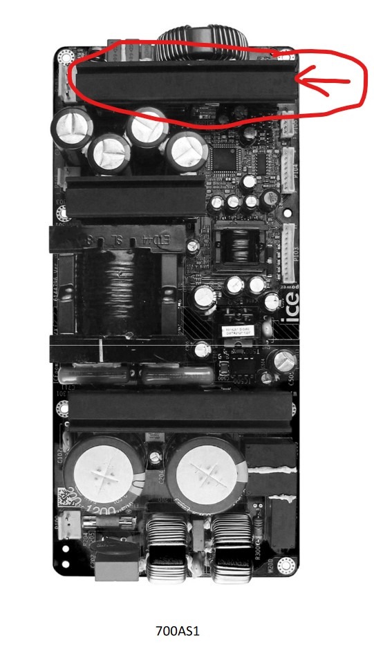

Those of you with a Icepower 700AS1: Hot hot are your heatsinks ?
I´ve got a Icepower 700AS1 up and running since 2 days.
Balanced input, driven by a SPL Volume 8, powering a 2*18" subwoofer (R DC = 2.7Ohm)
The heatsink HS1302 (the one next to the speaker output) gets quite hot.
Testsetup is on a flat board right now. Allround ventilation / free air / no case.
I know you can mount the heatsinks to the casing for heat dissipation. Which I will do lateron when putting it in a case.
Even with low power after a couple of minutes the heatsink HS1302 is getting very hot. I can only touch it for like 3 seconds, maybe 60°C I guess. Seems strange to me.
The amp works normal, protect LED is never on, its never shutting down, music sound real good.
The other two heatsinks on the board feel like 40°C.
I´m wodering if it´s normal for HS1302 to be "cooking" even with low power levels.

I didn't expect the heatsink to get so hot, because the icepower manual says you can put it in a case and run it as it is. Thermal coupling to the case is just optional, if higher thermal stability is needed.
I'd never put it in a case without further thermal coupling. Some of the capacitors are very close to the hot heatsinks.

I bought a temperature sensor for my multitester and measured the heatsink temperature in idle and while listening to music.
With the testsetup (module flat mounted with 20mm spacers to bottom of case, no additional heatsink), it was indeed maxing out at apr. 52° surface temperature of the heatsink. (warm summer day, 27° room temperature)
I have built the case now. The case has a lot of room around the board, is very well vented (complete bottom and complete topside are perforated plate)
The board is mounted vertical with 20mm spacers to one sidewall.

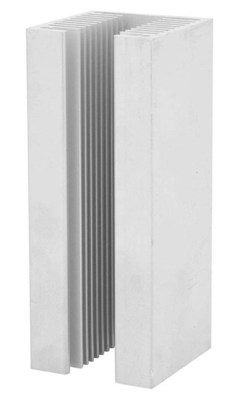

And I have added a 40x40x100mm heatsink in vertical orientation.
The temperature of the onboard heatsink is now down to less than 44°C, according to my temperature sensor.
I think thats fine now and I don´t plan on adding a vent.
And yes a class D heats up.... Even volume lowered to the minimum....
