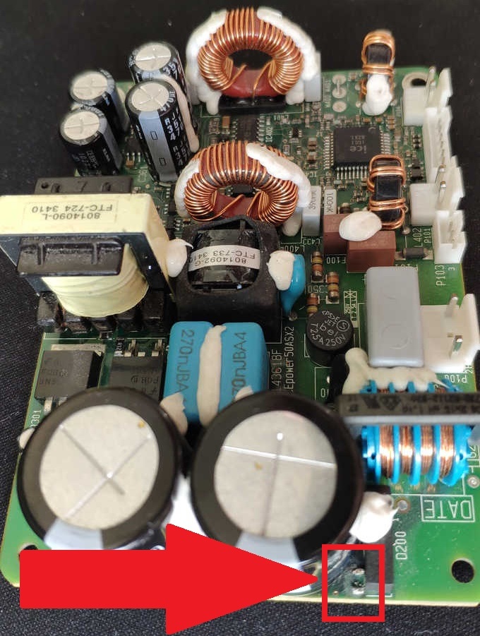

Hello! I am currently doing an ICEpower 50asx2 btl to repair. I would need the time of the C 201 times. Unfortunately, there is no plan for these modules. I hang a picture to which component I mean.
C 201 between Elko an Diodenbridge

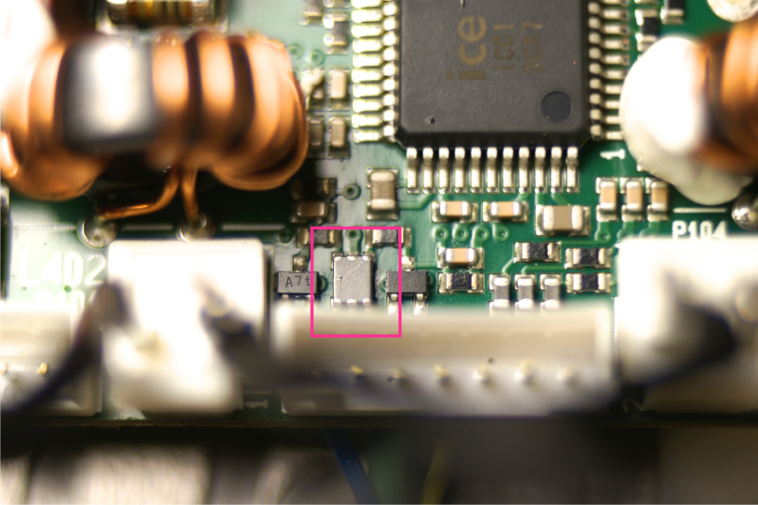

Hi I also have a question about this module.

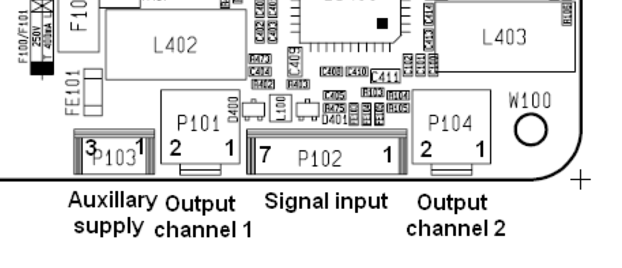

What is the 6 legs thing above P102 Input connector. Labeled L100 in the manual. Mine is cracked and no sound.
I have exactly the same amplifier module, and the same mistake: visually broken L100, no sound, but all voltages are correct.
(module: ICEpower 50ASX2 )
Did you successfully exchange the broken part, a three line choke, as one meber guessed?

No, I have not fixed L100 yet. I would like to know if someone has successfully replaced it with the other parts.
I am preparing to undertake this procedure and will present my results here. I guess that I have managed to find a part which can replace the one I have destroyed by mistake.
I am ordering the replacement part from Mouser, so expect delay about three weeks before I come back with some info.

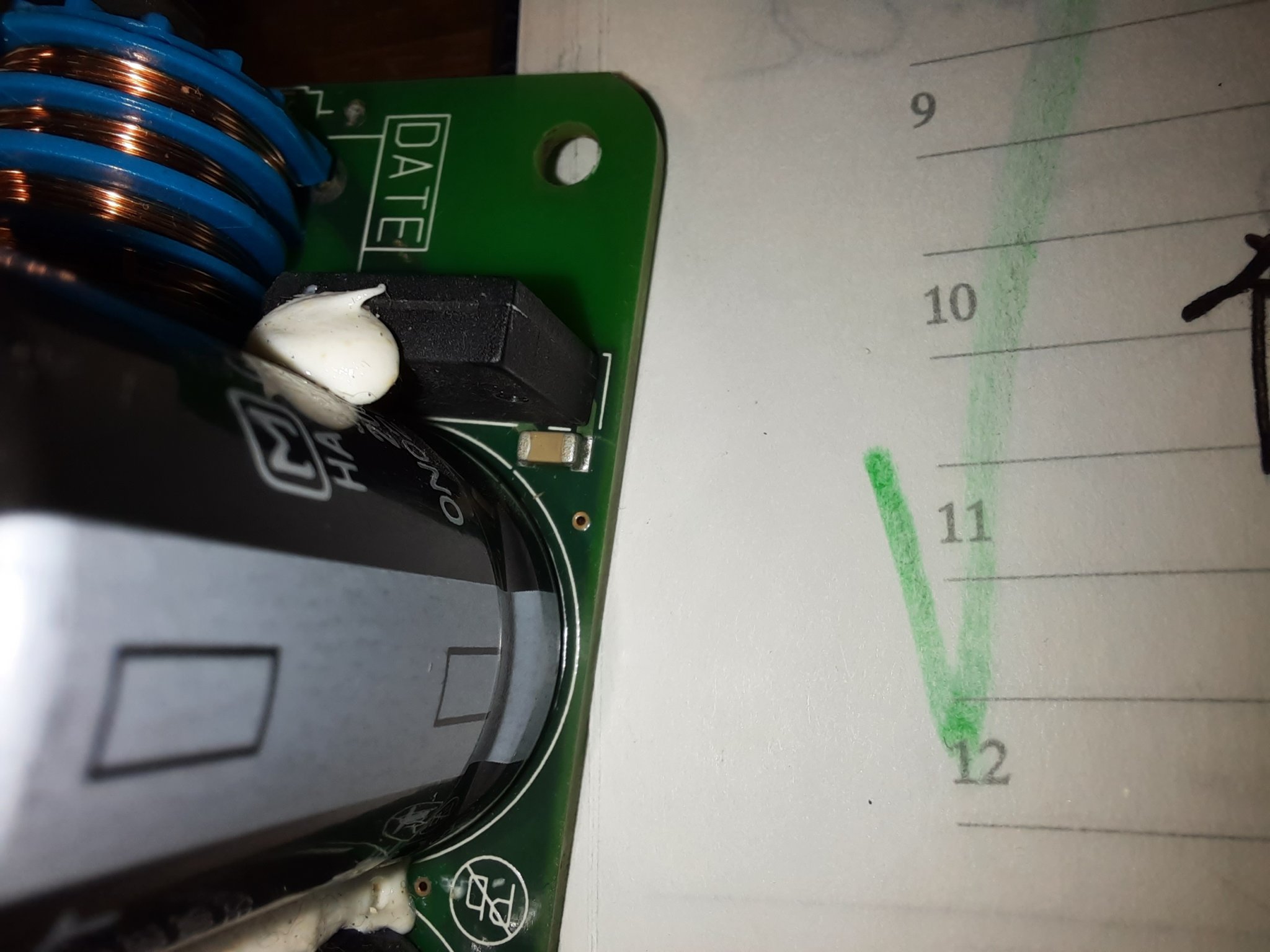

Hello,
I own 3 icepower 50ASX2 SE amplifiers.
2 of them are defective after a few months of use, and both have the same visible problem : a component (labelled C201 on the connection diagram in the Datasheet) has burnt.
Did you manage to replace that component ? what is it ?

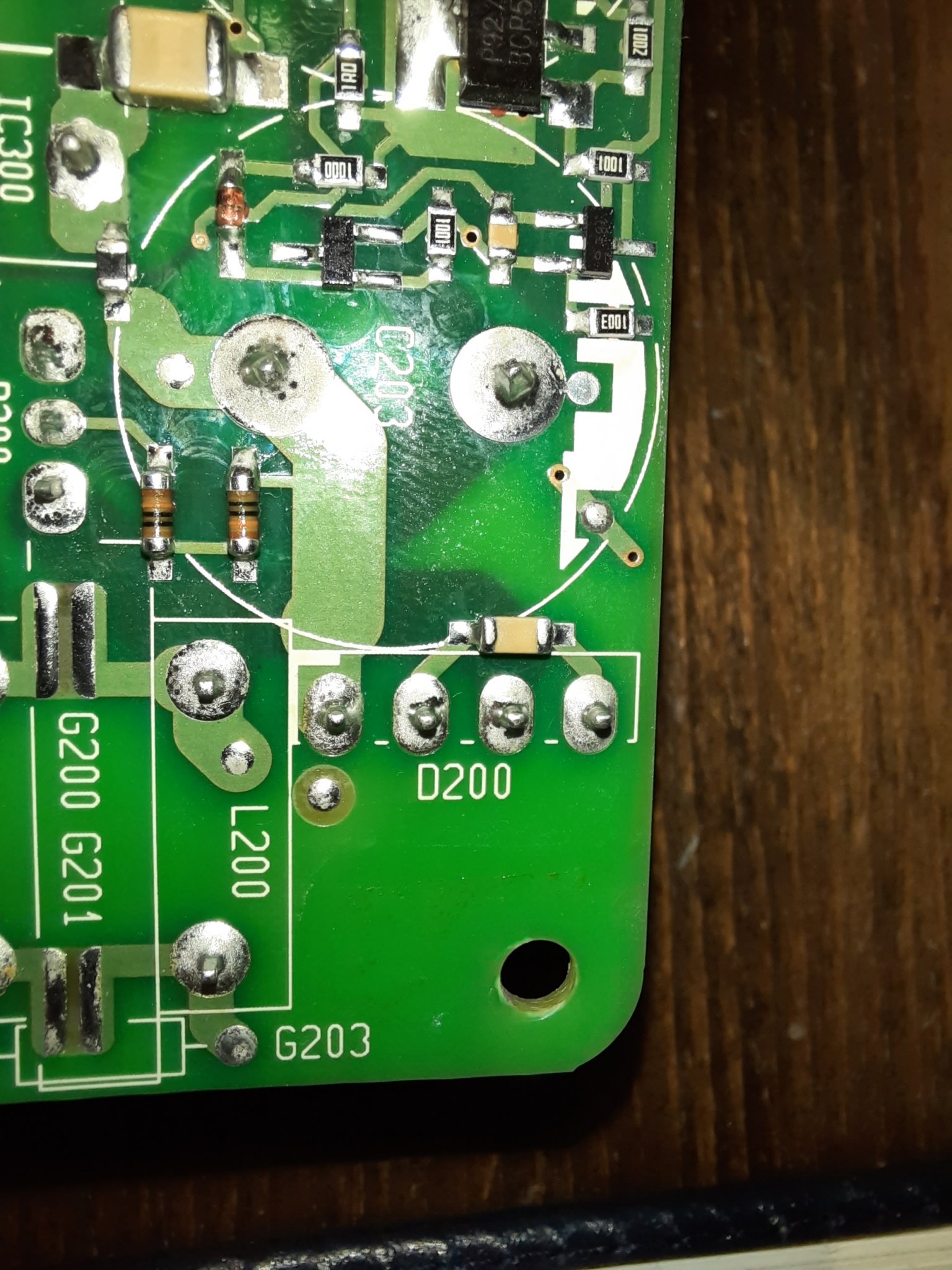

Dear herve34, my guess is that this component is a simple capacitor going from one AC leg of bridge rectifier to the ground. As far as I can see it, there are two of them. One is near the bridge rectifier and that is the one burned from your picture, and the other one is on the other side of board, where you can clearly see that is connected between one AC input and ground.
https://electronics.stackexchange.c...-extra-capacitors-around-the-bridge-rectifier
Now, the question one should ask is why they have burned on two different boards? Voltage too high?

Are you sure that the modules are genuine ICEPower modules? Agedhorse on both the US Talkbass And UK Basschat forums has said that there are many fake ICEPower moduLes from China and the often go faulty. In addition,this module has to be fan cooled to get full power. Mine is not, but the only thing that happens is a short time shut down, 2-3 seconds.
I have three of the SE modules but they areare not with me at the moment. I will try to check a good one to measure the component.
One final comment. Put a real replaceable fuse on the two auxiliary power lines. They are easier to replace than the onboard fuses in case of a short.

This one is under repair because I have noticed that one channel was in abundance with oscillations, which were influencing preamp too. Unfortunately, during testing I wanted to check this again which led to me effectively bringing output to input of channel 1, cracking L100 and leaving this channel now silent.

P102, as one can seen from manual, is for two inputs and three protection lines: thermal protection, overcurrent and enable. Depending of the design of other modules, they can be used as an information only towards other circuits (as they are internally connected to the main chip) , so I am not sure that it is important to have those lines connected when testing.
In your case, can they try this module with some other speaker, proven to be in full working order?
