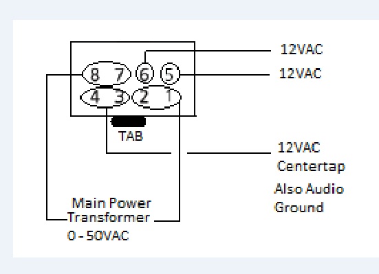

I have an ICEPower Evaluation Module that comes without SMPS, but with caps and rectifier for a Linear Power supply (just add your transformer). There is an AC Input connector that is same type of connector used for the 500A Voltage power rail and speaker outs.
There are 8 pins, and looking at the connector, the top left pair of pins go to AC on rectifier, and kitty corner to these is another pair of pins that connect to the other AC connection of rectifier. This is where I will put the 0V - 50VAC transformer winding to make the 72VDC rail. The pair just below the power connection are common and connect to the PS ground pins on caps and audio ground.
Now the other pair to the side of power connectors are not "shared", and I think they should be for 12VAC and 12VAC transformer connections (me thinks) that make up the +/-15VDC. I cannot trace these as they disappear under the modules...
Can anyone confirm these connections?? Don't wanna blow these up...

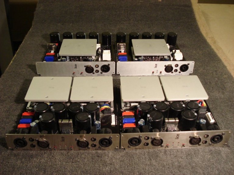

These modules do not come up that often. See pic (not mine - from another member here that posted these for sale years ago)
The ones in front of pic are like the evaluation modules I have. This was a pic from a member here years ago that sold his modules. The evl modules in front are the (dual) 500A and ones in back are (singular) 1000A...
The single square steel object in middle of 500A eval module is the heat sink fitted over the main PS rectifier for the Vp. Behind it is the AC Connector. I have not yet found the rectifier for the +/- 15VDC from tracing the board...
At first sight I thought these were made for subwoofer use maybe? But why two channel? I hope the PCB circuits do not have frequency limitations limiting the Eval module for subwoodfer duty only, like the 1000A modules (amplify to 3khz only). I have removed the actual 500A modules and compared them to regular 500A modules and look fine...but was hoping to build an amp by just adding tranny - like a Henry Ho H20 Amp (500A based amp with Class A Linear power Supply)...

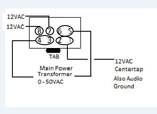

OK, I got the voltages correct - my previous post was incorrect - just the mirror image of what I posted - confirmed by the voltages at the alternate connections on side (+15V GrndA -15V and Vp - Grndp)

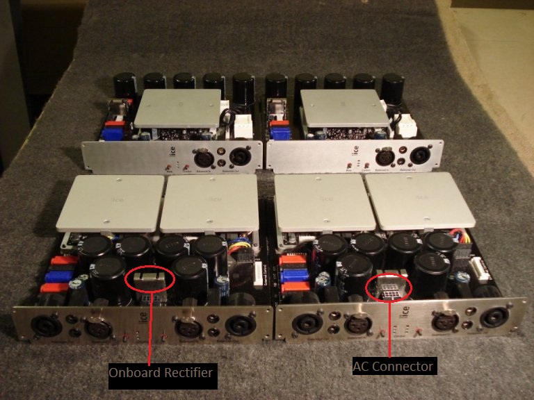

And just in case anyone was still interested, the correct AC pinout on unit is now corrected, and also a pic of where the rectifier for Vp and AC connector is

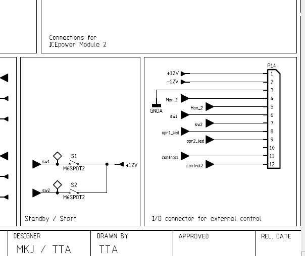

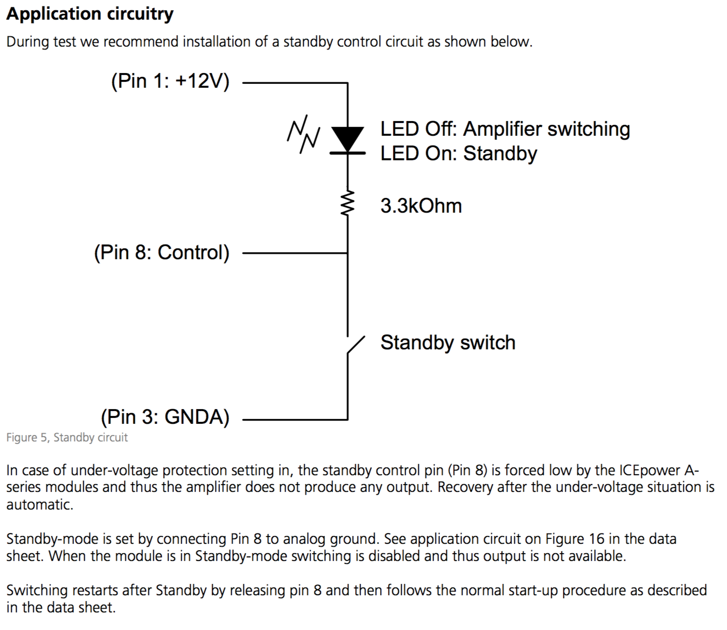

Haven't played with these in a (long) while, but if i'm reading the schematic correctly then sw1/sw2 are for the control signals to the module whereas the control1/control2 connections are for the control pins (if you want to read the module status using an external circuit). The attached snip from the A-series app. note might help explain my conclusion 😀

I re-read that diagram from eval module manual-
I connected together the two SW pins (pin 5 and pin 6) so both channels go into standby together. When I connect the +12v pin (pin 1) to the connected sw1/sw2 pins the modules successfully go into standby. But when I break that connection, amp remains in standby, and I need to reconnect the +12 and sw pins for the standby to go off. Looks like I need a momentary switch
I think that's right. The supporting circuitry on the eval. board is (as I recall) a flip-flop that toggles with each press of the onboard switch (so an external switch would behave the same way). If you only had the module itself, you'd need a latching switch to hold the control pin in low-state in order to put the module in standby.
