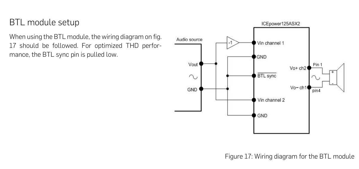

Hi I have an ICEpower 125ASX2 and want to set it up in BLT mode. I have seen in the documentation that the signal to channel 1 needs to be inverted. I am powering it using a ADAU1701 AMP2 dsp board that outputs RCA and works fine under normal operation.
Can I set the DSP to make one of the RCA Inputs 180deg out of phase and use for ch1 input while in BLT mode? (I would also mix the L/R to mono in the DSP

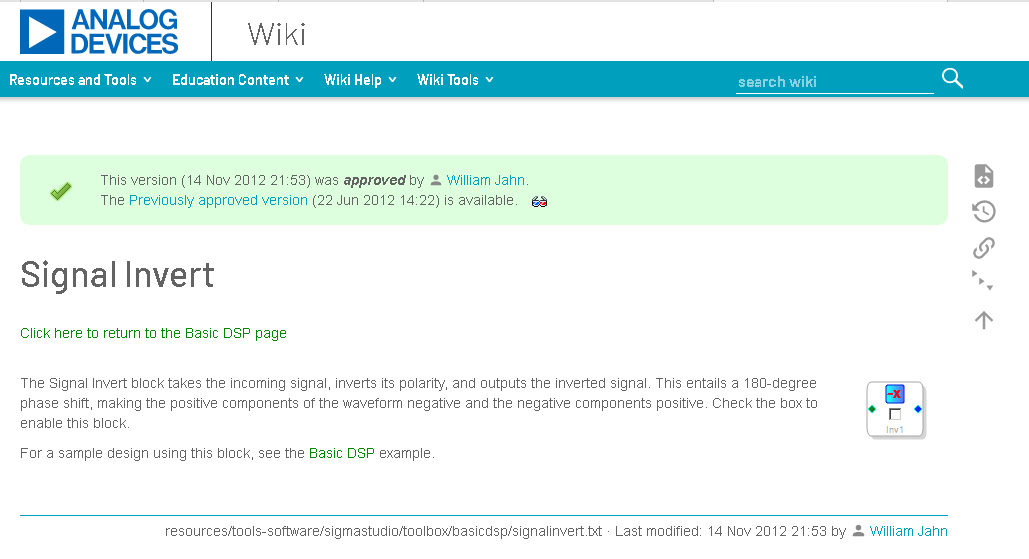

The SigmaStudio signal invert will do exactly what you want. The only drawback is you will need two DACs, one for the normal signal (goes to Vin channel 2) and one for the inverted signal (goes to Vin channel 1).
