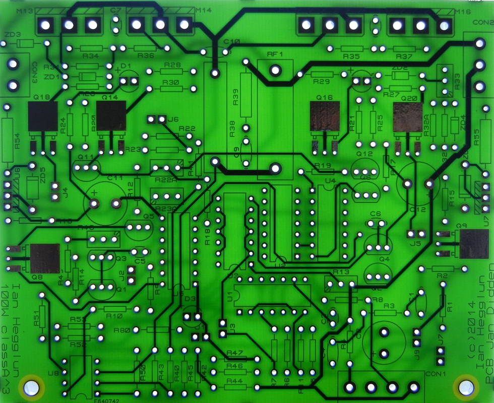

I must, to my chagrin, call your attention to an incorrect footprint on the silk screen.
No show stopper, but be aware.
Details here. My bad.

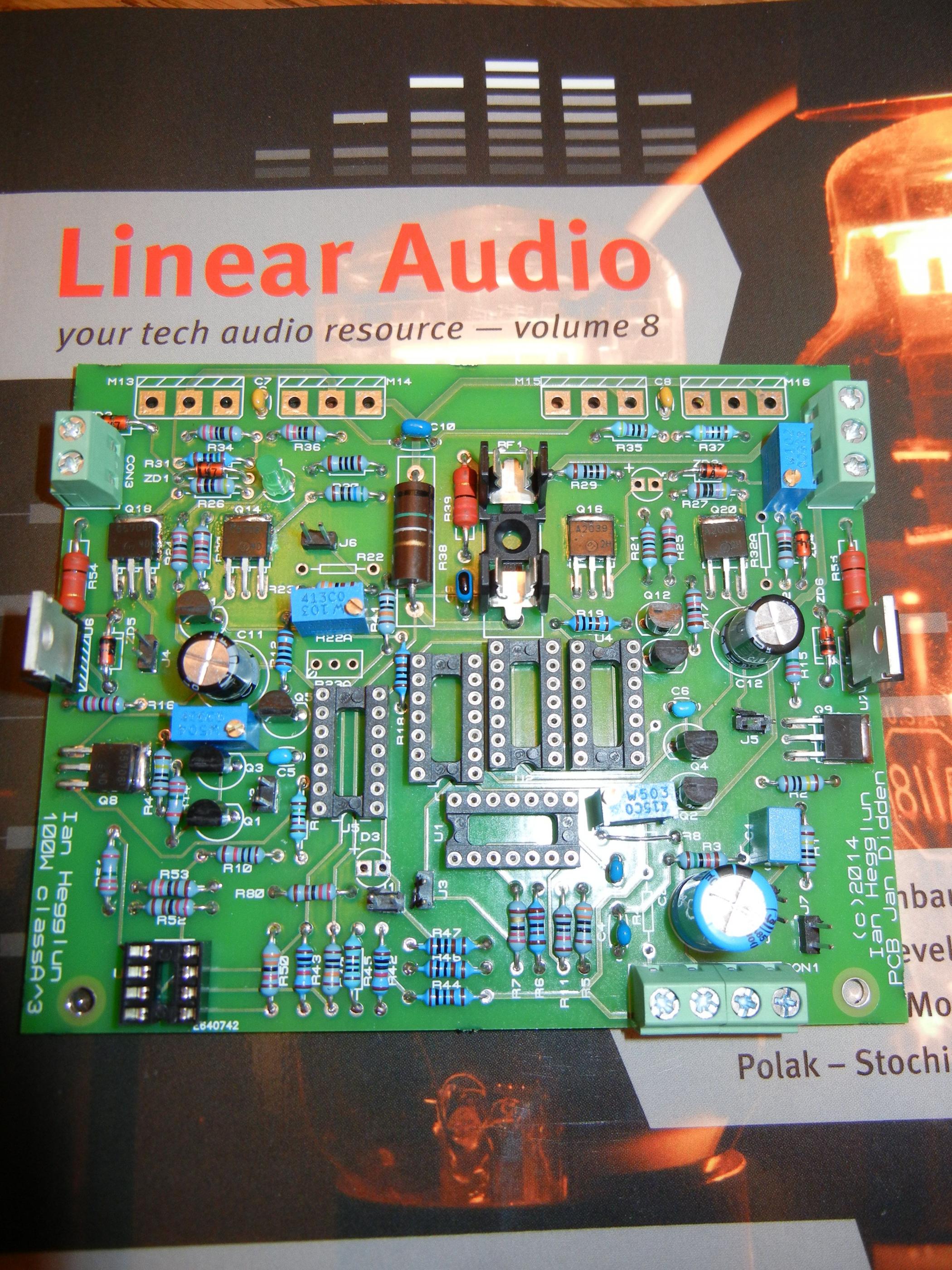

I'm ahead of you guys 🙂
Very nice, Jan! I will be close behind you!
I'm ahead of you guys 🙂Jan
Jan, is that R49 next to Q8? The "9" is covered by the footpad? I notice you have a 1.2M resistor in there, although the BOM specifies 1M for R49.
In any regard, I'm stuffing 1M in there.... Hopefully my assumption is correct.
Yes correct on both counts. I had the same question on R49 to Ian, and both will work since there is anyway the series trimmer to adjust.
Jan
Thanks, Jan.
I also noticed that there are only two holes for D3, although the Bi-Color LED has three legs.... How does that work?
Thanks, Jan.
I used a 2-pin bicolor LED for the schematic and PCB....
Here's one from knightsbridge.
But you can use two separate LEDs by connecting them in // but opposite polarity. Gives you a choice of colors 😉
