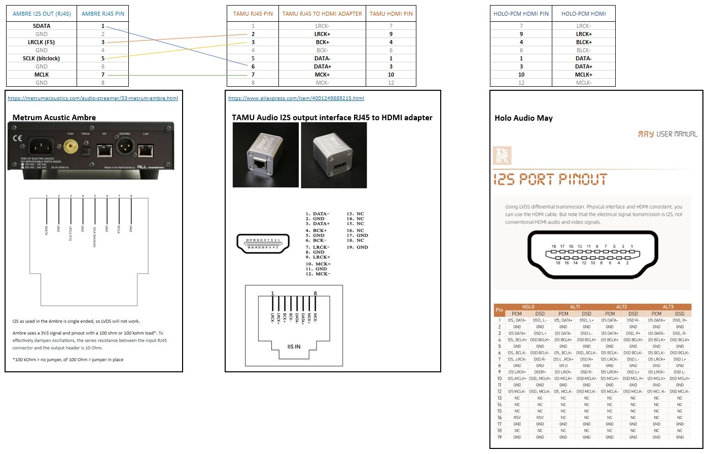

Is it possible to connect single ended I2S to LVDS I2S?
Input unit (network streamer): Matrum Acustic Ambre
Output unit (DAC): Holo Audio May
Tamu Audio sells an I2S RJ45 to HDMI adapter (https://www.aliexpress.com/item/4001249889215.html) and I wonder whether using a modified UTP cable the I2S connection between the Ambre and the May is possible via such adapter. The picture below shows how the UTP cable would connect the pins at the Ambre and Tamu ends (coloured lines).
The I2S used in the Ambre is single ended, and the Holo uses LVDS. I suppose the two cannot be connected without a conversion unit in the middle?
