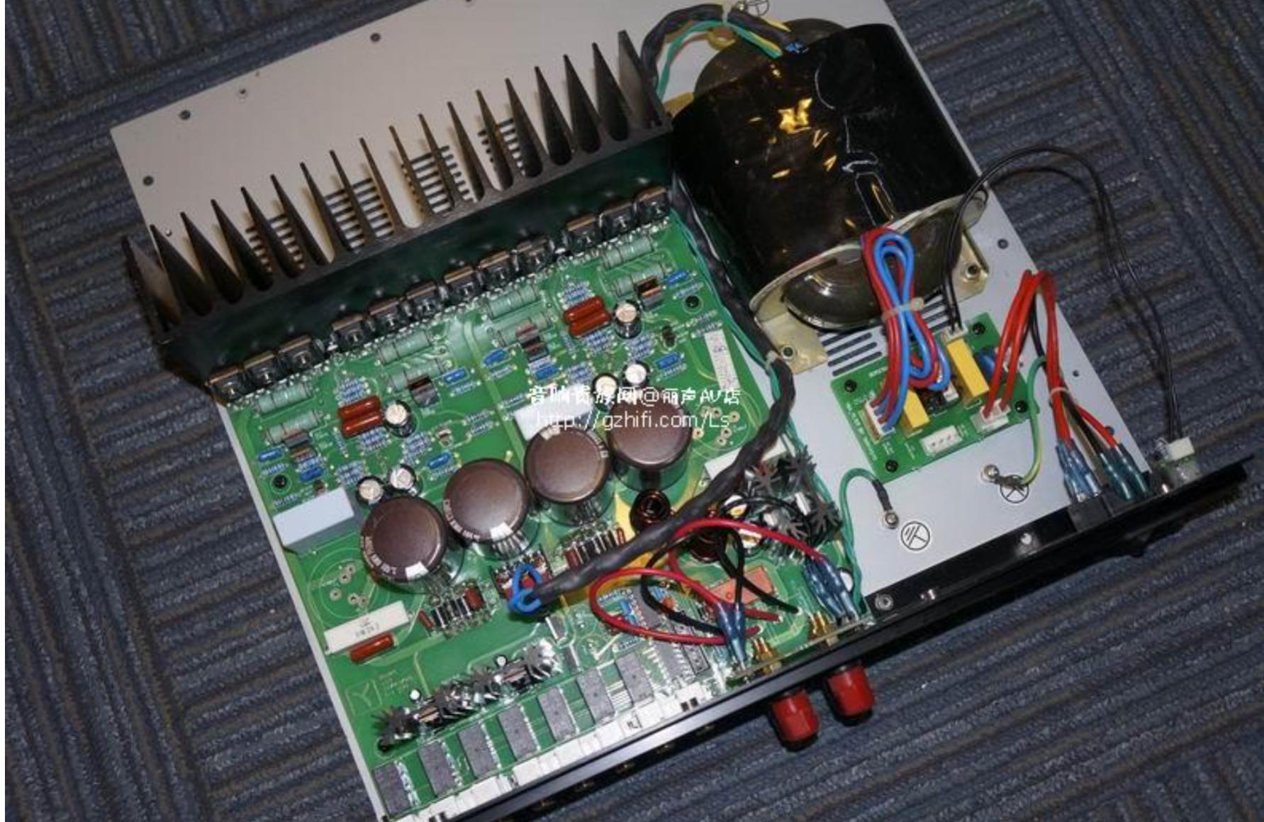

I see only two films caps if i'm not mistaken. And I'm wondering why there are two empty spaces for what appear to be extra power supply caps.
Likely intended for flexibility to get the right amount of uF with a varying # of capacitors,
depending on availability. You can increase the total capacitance safely, up to perhaps
double that on the board now.

First I would change feedback resistors to Dale CMF 55 or CMF 60.

I recommend that you just fix the problem and leave the amp design and its parts, alone! YBA (the designer) is extremely competent, and you can only compromise it. Make sure that ANYTHING that you replace, really needs replacing, including electrolytic caps.
Hi John,
I'm aware that YBA is a black belt in audio electronics design. Which is why I mentioned I didn't want to change the circuit. I just wanted to upgrade to some better quality parts. The amp is after all going on 15 years old. But if you say to leave it, then I'll heed that advice. ��
