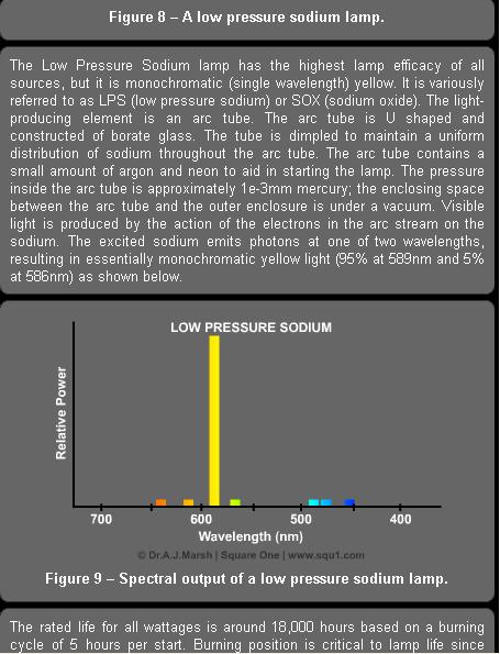

Sodium for example See attached:
The LCD filters blue, green, red. Every other wavelength is absorbed hence the need for powerful lights.
You are recommending a primarily yellow light so almost all the energy will be wasted. Some people go big wattage because of poor choice of lamp.
Surprisingly the most popular lamp by ushio has poor red output. Im not sure how people fix this - maybe pump up the red in the OSD - but it maybe why they go 400w and many want more.
If you want to try this sodium lamp let us know how your experiment goes.

Me2! said:
SMC,
You are new and seem very excited about diy projectors. Your thoughts are great but try doing a search on some of these things. Many topics are well researched already.
Cheers.
