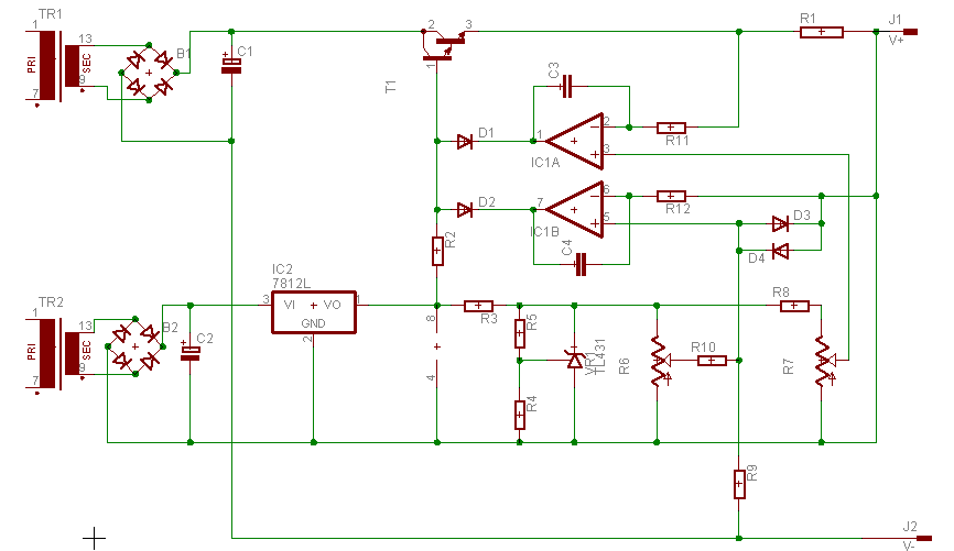

I want to set up a digital control voltage supply
I want to set up a voltage supply which can be controled by the conputer. Now I hope the output voltage range is from 0 to 30V. Initial plan is to use the LM317 and AD5235. But I can not get the 0V output, because the minimum output voltage of LM317 is 1.2V. I will appreciate to you if you can tell something of suggestion about that. Thank you very much!!

Use a circuit with separate reference (can be a cheap one like TL431), opamp and pass transistor. http://www.scopeboy.com/ddragon.html shows something like that, your AD5235 can take the place of R26.
In http://www.circuitcellar.com/library/print/1202/millier149/2.htm, Brian shows a deign similar to what you want; the only limitation is that the opamp driving the MOSFET needs to handle the full input voltage.
I like the floating topology better (see attached) where the regulator's ground is at the V+ output. TR1/B1/C1 supply output power. The regulator has a small separate supply (TR2/B2/C2) that may also feed your digital circuits. R6 and R7 would be your AD5235 to set voltage and current, respectively (or use a fixed setting for I-limit). Note that for linearity, R10 would have to be large compared to R6, or you'd have to add a buffer inbetween. With single supply as shown the opamps must be able to work at 0V input common, or you give them a little negative supply (a couple of diodes between IC2 GND/C2 with opamp V- on C2 will do the trick).
R5/R4 define the reference voltage (10k each 5V). IC1B tries to hold its +in at V+ level, or at regulator ground, so Vref/R10 = Vout/R9 (D3/D4 protect IC1B). This design scales nicely - only T1 and R9 "see" the full voltage, and you can parallel multiple pass transistors (with emitter Rs) for more current/dissipation, or use MOSFETs.
Note this is a rough schematic - you'd need to work out component values, compensation etc. for your needs.
Oh BTW - you'd need to opto-isolate the computer interface anyway, so regulator ground at V+ is no problem.

The obvious simplification is a fixed current limit (trimpot instead of R7) - I wouldn't leave out the limiter itself. And remember to sort out the compensation for your choice of opamp/transistor.
TR1/2 can of course be combined if you find something suitable, but the secondaries have to be separate.

Look at the schematic of the floating regulator that I posted - you can use a digital pot, or a DAC, to create a control voltage in the 0-3 or 0-5 V neigborhood to control possibly hundreds of volts - the regulator is run on some +12V, separately supplied, and the pot/DAC have nothing to do with the (high) output voltage, only the pass transistor (MOSFET) and the sense resistor do.
A version of that circuit is found in lots of professional lab/bench supplies by the likes of HP et al. As I said it scales nicely to high voltages/currents as required. Don't let the fact that the regulator's ground potential is at Vout+ scare you too much. You need optoisolation anyway.
See your other thread for the DAC/Power OpAmp story; yes of course you can do that, too.
You meaning is that the T1 is the amplifier transister that we can only control it's base electrode? But there two inportment things for your design. One the the linearity of the transistor and the other is transistor have to afford a high voltage and high current.

I'm not sure I understand the question. T1 is used as an emitter follower here. What electrode other than the base do you want to control?

Nonsense. The transistor is in the opamp's feedback loop.
The trick is the summing node between R9 an R10. The opamp holds that at the same voltage it sees on its inverting input = V+. (The voltage across D3/D4 is always zero, the diodes are only there to protect the opamp while there's a rapid change.) Since the reference is relative to V+ also, the current from R9 is constant (Vref/R9). it has nowhere else to go but R10. Therefore the voltage across R10 (the output voltage) is (Vref/R9)*R10. If it were less, the current through R10 would be less than Vref/R9, causing IC1b (I+) to rise above (I-); IC1B's output would go up; and so would the voltage on T1's emitter (= voltage on its base less ~1.4V), and therefore the ouptut voltage.

You can believe me this circuit works - my main lab PSU of 20 years is built that way.

Power transistors for a couple 100V are cheap & easy to come by. (Much easier than opamps for that voltage.)
Power dissipation is inherent in linear regulators and not specific to this circuit. You need appropriate heatsinking (max output current x max input voltage). If necessary, the power dissipation may be shared among a number of transistors. (Also mentioned before).

If I have a DC voltage supply, can I use it directly to the T1's collector? And can I use the DAC card to the nod 1, next to the R3? And then can I get rid of the TR1&2 B1&2 C1&2 and IC2?
