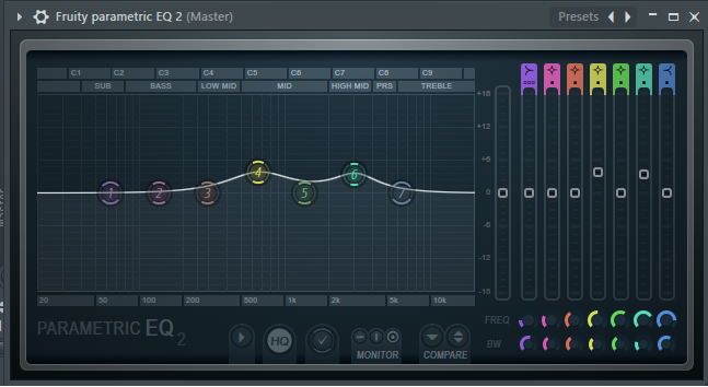

By ear, I need mid tones boost, curve will probably look something like this:

1.) BUFFER (to avoid input impedance differences) -> 2.) calculated PASIVE BANDPASS FILTER (to lift the mid tones) -> 3.) GAIN STAGE (to get back to the gain, that passive filter took) -> 4.) ACTIVE TONE CONTROL (is this passive filter followed by gain stage? ) -> 5.) VOLUME POT (rather at the end than at the start of the chain, so it can also attenuate any hiss / buzz).
Does this sound correct? Should 3.) GAIN STAGE be moved just before the 5.) VOLUME POT, so 4.) ACTIVE TONE CONTROL can work with lower gain, reducing need of higher voltage from power supply? In this case would I need another buffer to avoid interference between 2. calculated BANDPASS FILTER & tone control?
Also if I would need mid boost and LFP for example, can this be done in one stage or do I need to make two stages? also for example if I would need boost at for example 500Hz and also at 2kHz, can this be done in single stage or do I need two? (Concern of 2 passive filters interfearing each other... again)

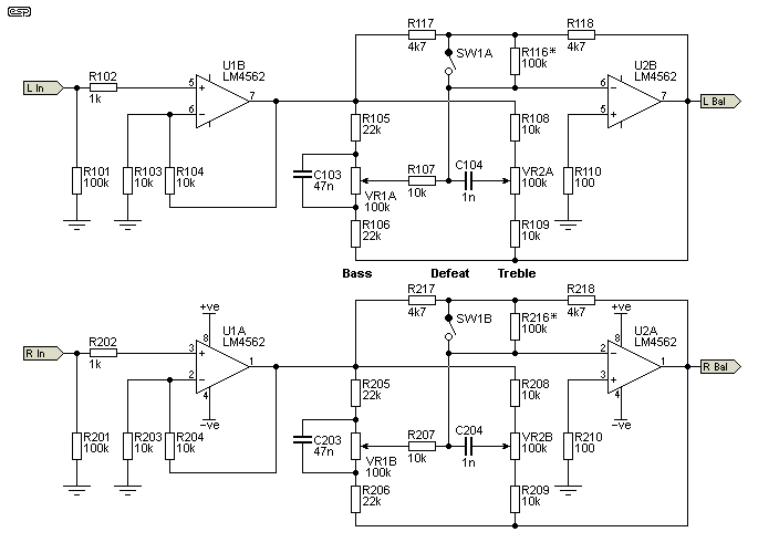

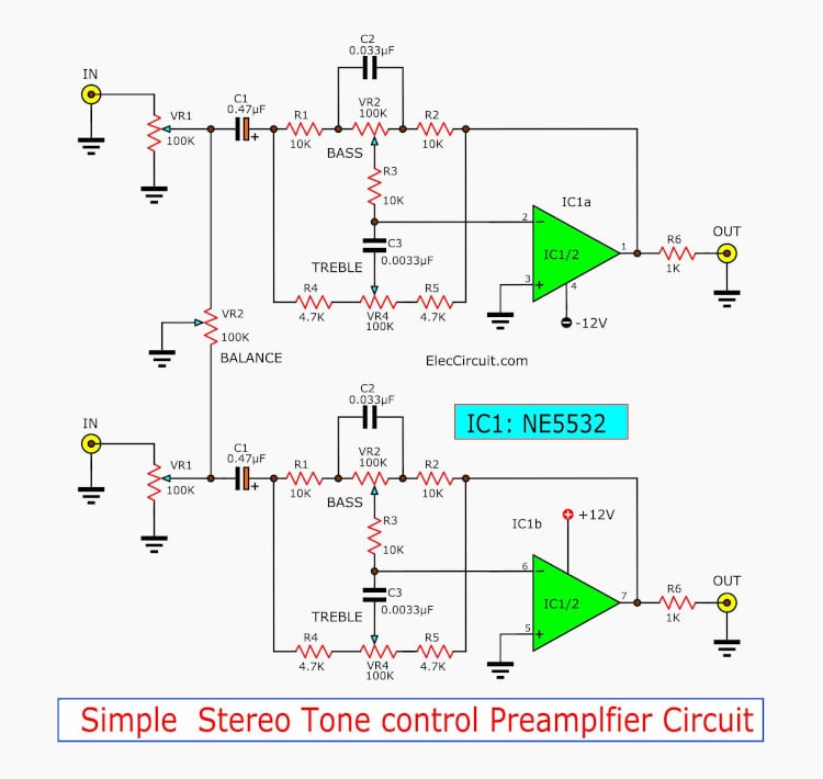

Pretty standard active tone circuit. But the impedance level is too high. Normally you would use 10k or 20k pots.
To start, I would divide all resistors by a factor of five (or ten), and increase all capacitors by a factor of five (or ten).
Also, use the 5534 instead, which will allow identical PCB layouts for each channel.
Ok.
I don't see point in using this schematic, if I need to modify that much right away, but anyway I appreciate it for learing purpose.
Will search a bit more to find something similiar with values in mind.

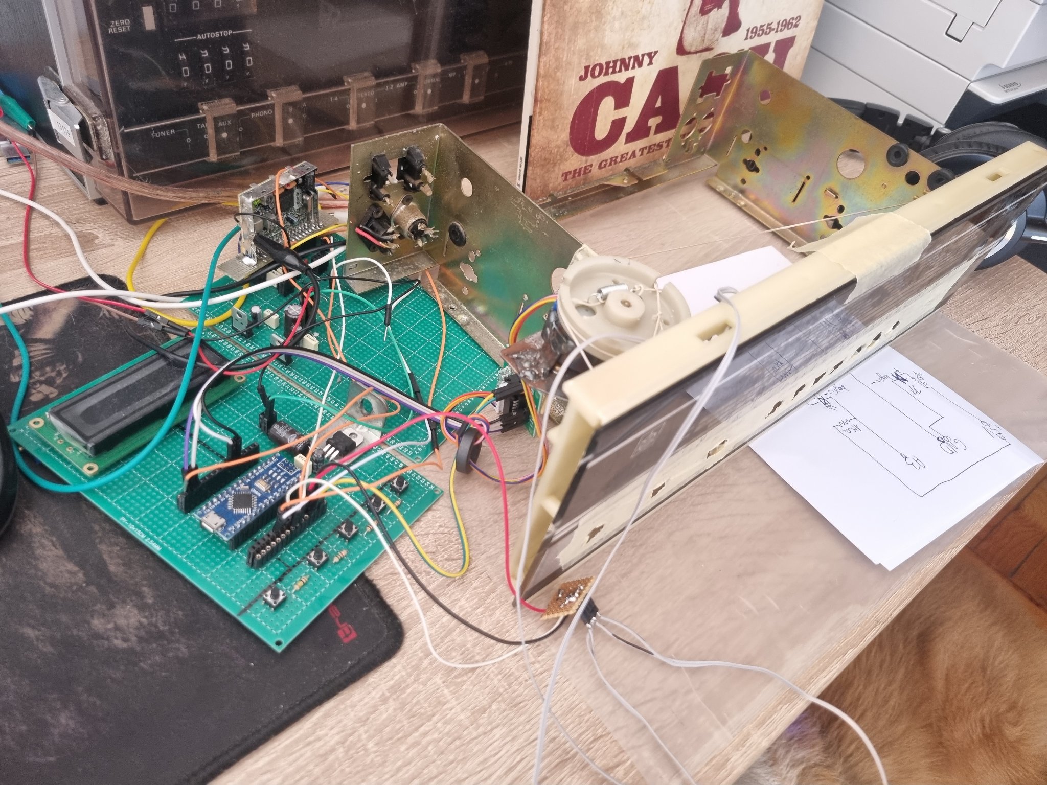

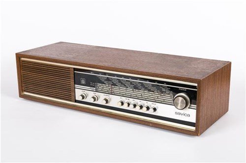

I`m modifying 70s Yugoslavian radio, Iskra Savica SN120:
This radio has specific sound, only 3w 4ohm (12cm x 17.5cm) speaker. Sound is warm, soft, strong mid tones, it somehow manages to fill the whole house.
A great achievement for the time being, many many households had it. And I want to replicate the sound as much as I can with new amplifier.
Everything is gutted out, only speaker remains. I had managed to build tuner with MCU and Sony TUX-032 tuner module from Xplod car radio. Scale pointer is morised with a stepper motor.
That results in auto tune tuner with great reception.
My plan was to do the project in STEREO, but radio was originaly in MONO and setting tuner to MONO mode results in so much cleaner sound, I decided to keep it in MONO.

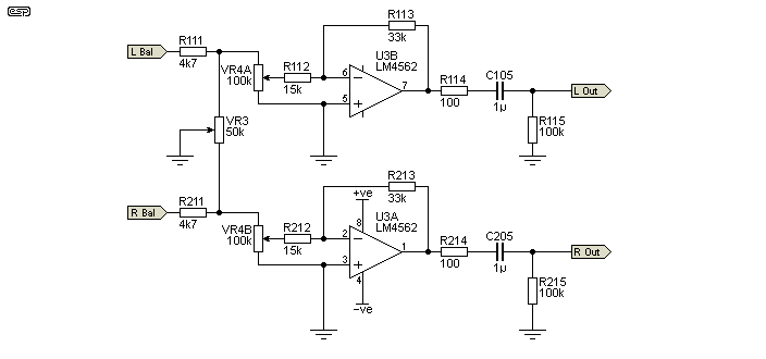

Thats the output stage of the same project, do I need it? And why is it needed? Impedance matching or something else? Would the input impedance of the amp alter the filter properties if no output stage is used? Can I just put volume pot after the tone control and forget the output stage?
EDIT: I`m sorry, ofcourse, it`s for phase correction.
