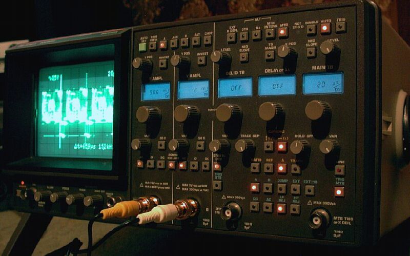

Hi guys...I've also been looking around at scopes and I've spotted something that caught my eye, its a 400MHz Philips PM 3295A. It looks way over specced but is it any good for the audio hobbyist? I might buy it regardless as it looks so damn cool.
Take a look
tonga

If you have the opportunity to buy that monster for some ridiculous price, I /will/ hate you forever. 😉
A scope like that would be great for digital work. My 100MHz setup makes it hard to see some of the faster signals, like individual S/PDIF bits. The one thing that is nice about it though is the 7A22 with 10uV input range.
