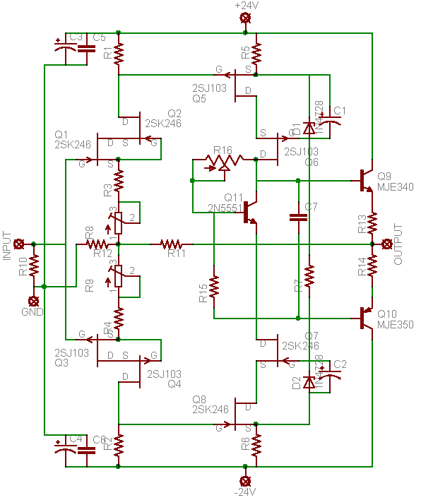

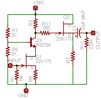

i want to built new preamp
Hi guys,
i have built this preamp and i want to built a new preamp but i'm not sure of this new topology. somebody can help me! Thank you Maxpou
