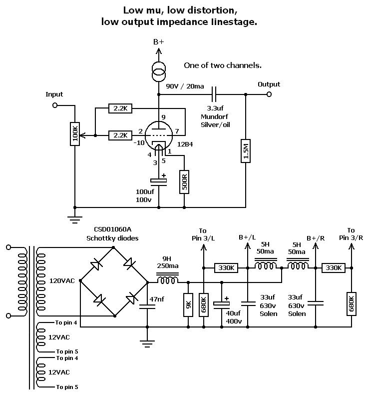

If all dad uses as a source is a CDP, it's "a piece of cake". Those 12B4s WILL do the job. OTOH, if dad has (as I suspect) a collection of vinyl, you'll have to construct a phono preamp too.
I've attached a schematic for a 12B4 based line stage. You don't have to get quite that fancy with the parts to get excellent results.
BTW, the interlocked circle symbol stands for a constant current source (CCS).

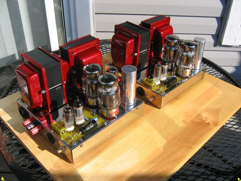

The first thing I built was my dynaco MKIII monoblocks. I learned quite a bit. Granted they were not a "scratch build".
I attempted to learn this stuff by reading books first and just never quite got it. I do better learning as I go. It can be long and painful LOL.
Thanks guys, here is a photo of my MKIIIs after completion.
Evan

Eli, the schematic that you provided obviously has no resistor wattages listed. I used ohms law to the best of my peanut brained ability and came up with the following;
9k - 2W
680k - 1/4W
330k - 1/2W
1.5M - 1/4W
2.2K - 1W
I have no idea what to make the 500ohm one since its feeing the tube. Would 1 watt be adequate?
Also having trouble finding a 250ma 9H choke.
Thanks guys, Im trying to figure this out as best as I can through searching etc..
Evan
hey-Hey!!!,
For the 9 Hy/250 mA choke I would suggest substituting the 20 Hy/100 mA 193-series unit from Hammond. You'll run to less than half its current, and leave enough headroom for the AC flux that choke-input service creates.
Second, the CCS will allow a single LC filter. Its a very high impedance circuit, and will offer *PLENTY* of PSRR. Try a 50-80 uF/370VAC oil cap of the motor-run service type. Ebay has several sellers of this sort of thing at the $10 each range.
The coupling cap can be done otherwise too. See Mouser for the 3 uF, 735P by Sprague. It is a high current metalized polypropylene cap.
There's more to this, but it isn't all that difficult.
cheers,
Douglas
Evan,
My effing computer locked up as I was replying. 😡
Doug is correct about a 20 H. Hammond choke being just fine. A reasonable approximation to the critical current (in mA.) required by a choke I/P filter is given by V/L. It works out that 1000 Ohms of bleeder resistance are associated with each Henry in the 1st inductor. A 20 KOhm bleeder resistor is appropriate with a 20 H. 1st inductor. Even with adequate PSRR from the CCSes, I would still retain the paired 2nd LC sections. Channel separation is BETTER that way. The arrangement is known as pseudo dual mono. However, you can save some money by using smaller 2nd inductors. 🙂 1.5 - 2 H. parts are OK.
Either 1/2 or 1/4 W. parts are appropriate for the 2.2 KOhm grid stoppers. Be certain to use Carbon composition resistors in the stopper positions. Carbon comp. resistors are both non-inductive and non-metallic, which makes them superior in the stopper role. Remember, current in the grid circuit is vanishingly small, which makes noise a non-issue.
P= I2R. CCS loading forces the current in the 500 Ohm cathode resistors to be 20 mA. 0.2 W. is dissipated in each cathode resistor. 1/2 W. rated parts should be OK, and 1 W. or higher rated parts will surely be fine. Please observe that the 12B4 grids are at -10 V., with respect to the cathodes.
The B+ rail voltage should be approx. 120 V. A pure choke I/P filter will yield an approx. 105 V. rail. The 47 nF. "fudge factor" cap. needs to be tweaked, at the bench, to get the B+ rail exactly where it should be. Refer to the 12B4 data sheet. Please observe what the anode voltage must be, when the grid is at -10 V. and IB = 20 mA. The B+ PSU has to provide that and enough extra to operate the CCS.
Use 1/2 W. rated parts in the 330 KOhm/680 KOhm voltage dividers. A 2 W. part is appropriate for the 20 KOhm bleeder resistor.
DigiKey is the best source for the 600 PIV Schottky diodes, but there is an order minimum. This preamp is HEADS & SHOULDERS above the Carver SS unit it's replacing. Quality controls are in order. DigiKey carries the EXCELLENT PEC hot molded Carbon line. 2X single 100 KOhm log. taper pots. WILL get the job done. Between the controls and diodes, you fulfill the minimum order requirement.
