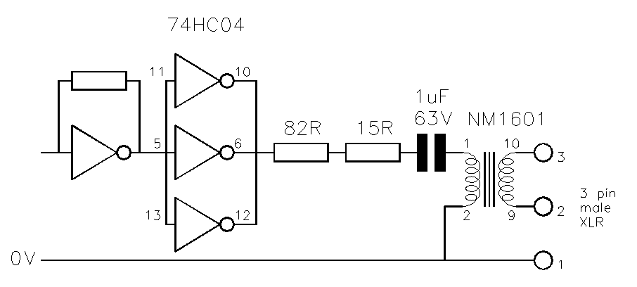

I recently made an AES3 driver for my Marantz CD5400 to drive my DCX2496 for exactly the reasons you describe. Electrically, AES3 is balanced and 110 Ohm, rather than the unbalanced 75 Ohm of S/PDIF. There were some spare inverters in the player, so I used the paralleled inverter technique shown earlier but without feedback resistors. I used a transformer coupled by a 1uF capacitor and 95 Ohm (determined by experiment) of series resistance to get the output impedance right. Here's an eye pattern of the output data:

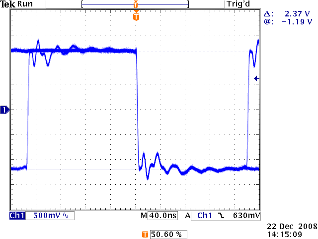

I have got a little further with this now. It seems there were two reasons my DAC was loosing lock. Firstly as I said the S/PDIF output was too low. However, even when boosted with the switch-box it kept loosing it. It turned out that I needed to ground the switch-box because both my sources and my DAC had floating inputs/outputs. So I grounded the input of the DAC, that in turn grounds the switch-box.
Now, it does seem to be working reliably, but there are a few things I wonder if you can help clear up?
Firstly, removing the voltage divider on the output of the switch-box did boost the level, and I now get about 500mVpp on the output. However, something that I find puzzling is that changing the feedback resistors R8 and R6 do nothing to the output level. In fact even bypassing R7 does nothing. It seems that no matter what the level of the input signal, and no matter what the feedback resistors are, the output is always spot on 500mVpp. Why is this??! I'd like to make it about 1V if I could, then I can add a 75R series resistor after the gate to get the impedance right and still have a good level. At the moment there is no source resistor, it just connects the gate, via a cap to my DAC with a 75R input load.
Secondly, there seems to be some ringing when the signal is connected to the switch-box.
If I have the S/PDIF output from my CD player going through a coax wire unloaded or loaded with a simple 100R resistor it does ring a little, but interestingly this can be reduced with a change in cable from a coax to a twisted pair balanced cable. See the comparison below.
Now the bit I don't get - when I connect it to the switch box, it rings no matter what cable I use, and it does so on the input, and the output! (p.s. I changed the scope range from 500mV to 1V when looking at the switch box output)
So why does the cable suddenly make no difference, and how can I clean up that ringing?
Thanks for your help!

AES3 driver
-> EC8010
Could you share with us the circuit diagram of your AES3 driver? Did you used something similar to SPDIF to AES/EBU converter shown on http://www.epanorama.net/documents/audio/spdif.html ?
-> EC8010
Re: AES3 driver

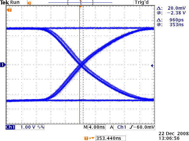

Close, but not quite. I picked up the signal inside the player where it came from the oversampling chip, so I didn't need the AC coupling and diodes in your reference. I did connect three inverters in parallel (like your reference) to drive the output. Then I added a series resistor and a series 1uF capacitor to drive the AES3 transformer. I'd draw it, but for various reasons, my scanner isn't working.
buble_corp said:Could you share with us the circuit diagram of your AES3 driver? Did you use something similar to SPDIF to AES/EBU converter shown on http://www.epanorama.net/documents/audio/spdif.html ?
Tenson, you're going to need a better oscilloscope than that to see what's going on. As it is, your lack of analogue bandwidth or sample rate could be concealing all sorts of things. I think the best you can do is to set your source impedance to 110 Ohm, use 110 Ohm twisted pair and hope that everything is correct. Fortunately, you can still check your source impedance by seeing if adding a 110 Ohm halves the open-circuit output voltage.

What kind of AES3 transformer did you use? Whas it balanced transformer with 1:2 ratio or standard 1:1 for spdif i.e. PE65612 from elfa.se ?
-> EC8010
The transformer was a 1:1 DIL type made by Newport Magnetics. I should warn you that although I've made this circuit a few times, the values of the series resistors may need to change depending on the individual inverters to get the right output resistance.
-> EC8010
Thanks for schematic, I see that you didn't use inverters to create balanced signal, you only used gates to buffer/amplify the signal.
I read the topic where Jocko Homo was teaching someone how to build correctly spdif output so I know about matching impedance, but still are there any datasheets telling you what the output impedance of chip's spdif digital output? Of course you can calculate it after measuring output voltage on different load, but to do it precisely you need a really good oscilloscope.
buble_corp said:... but to do it precisely you need a really good oscilloscope.
Yes. 😀
Actually, if you do the sums, you'll realise your oscilloscope doesn't need to be that good. Provided you compare open circuit with half amplitude (by adjusting a trimmer to give half amplitude), you can then just measure the trimmer with a DVM and the result will be good enough.
There's no way you can determine the inverter's output resistance from theory - they use FETs and FETs have enormous device to device tolerance. Also, the transformer adds resistance. It really is best to determine that series resistor by experiment.
Use a 74HCU04, not a 74HC04.
Putting feedback on a HC04 (non-U) is asking for spurious oscillation.
