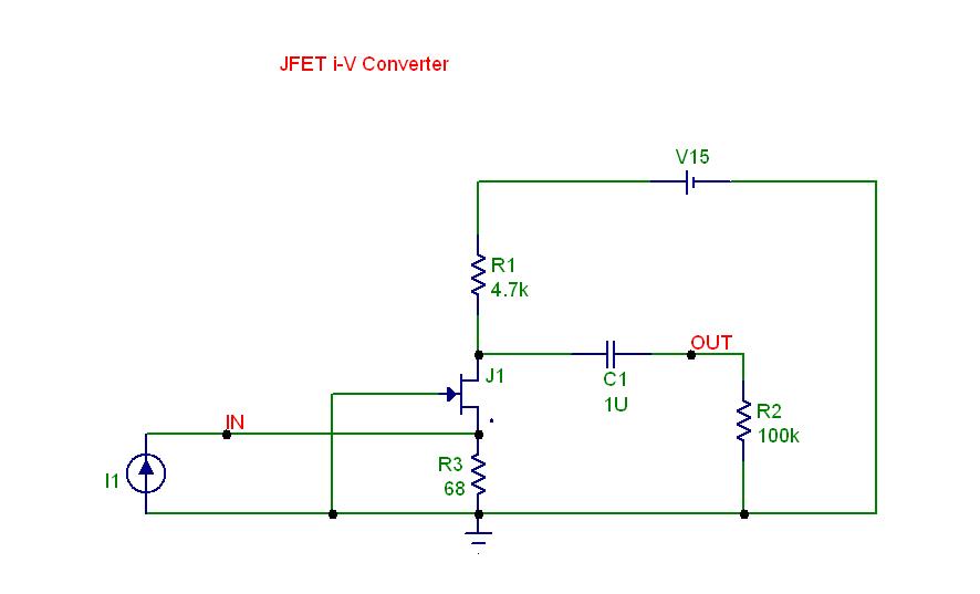

I'm working on a Jfet based I/V converter. Open loop, common base, maybe folded cascode if I can get it work.
But based on my simulations, the input impedance is high. A few dozen ohms, compared to the few ohms of a bjt or mos based common gate/base stage, this seems high.
Have I done something wrong, or is this normal with jfets? (making them unappropriate for common gate 🙁)

Presumably you mean common gate and not common base. The input impedance in this case will be the reciprocal of the transconductance. For a 2SK170 running at 5 mA or so, this will typically give 33 ohms input impedance.
I agree with Charles. One reason why a bjt gives much lower input Z here is it's higher transconductance.

ok, so I can forget the Jfets for my IV 🙁
you both agree that the input impedance is dependant of the gm
but Mosfets have a lower gm than BJTs, and my sims still show a low input impedance (a few ohms)
no way to have a Jfet IV with a low enough impedance? 🙁

Is 33 ohms really too high? I remember the old 1541As being happy with anything under 100 ohms or so. In any case, you could always go parallel on the jFETs.

SY said:Is 33 ohms really too high? I remember the old 1541As being happy with anything under 100 ohms or so. In any case, you could always go parallel on the jFETs.
the 1541's datasheet telle about 25mV AC swing on its output. Don't know if it is RMS, peak or peak to peak, but if it's peak to peak, it means that the I/V's input impedance must be 6R max

tmblack said:Anyone actually try the one JFET I-V?
Here I use 2SK170BR and 15V supply.
Should work with TDA1541.
Tom

Will the DC-voltage on the source be a problem for a PCM63P converter?
I simmed probabely exactly what You look for and it works very well.
Since it will very probabely soon become a commercial product I can´t reveal too much.
Its a common gate stage fed by a current source. Its followed by a N-JFET buffer output stage. This is similar to the idea of. Mr. Hawksford in his AES-paper. He adds some filtering between Input and buffer stage, which I don´t use. With a triple of input JFETs (its very low noise N-JFET but no SK170) I get around 75Ohms input impedance which is near perfect for the PCM 1794 (it translates to ~200mV at the input and ~2.5V at the output) and reduces noise to a very low level. The circuit is of course ´doubled´ to handle the symmetric output of the DAC.
