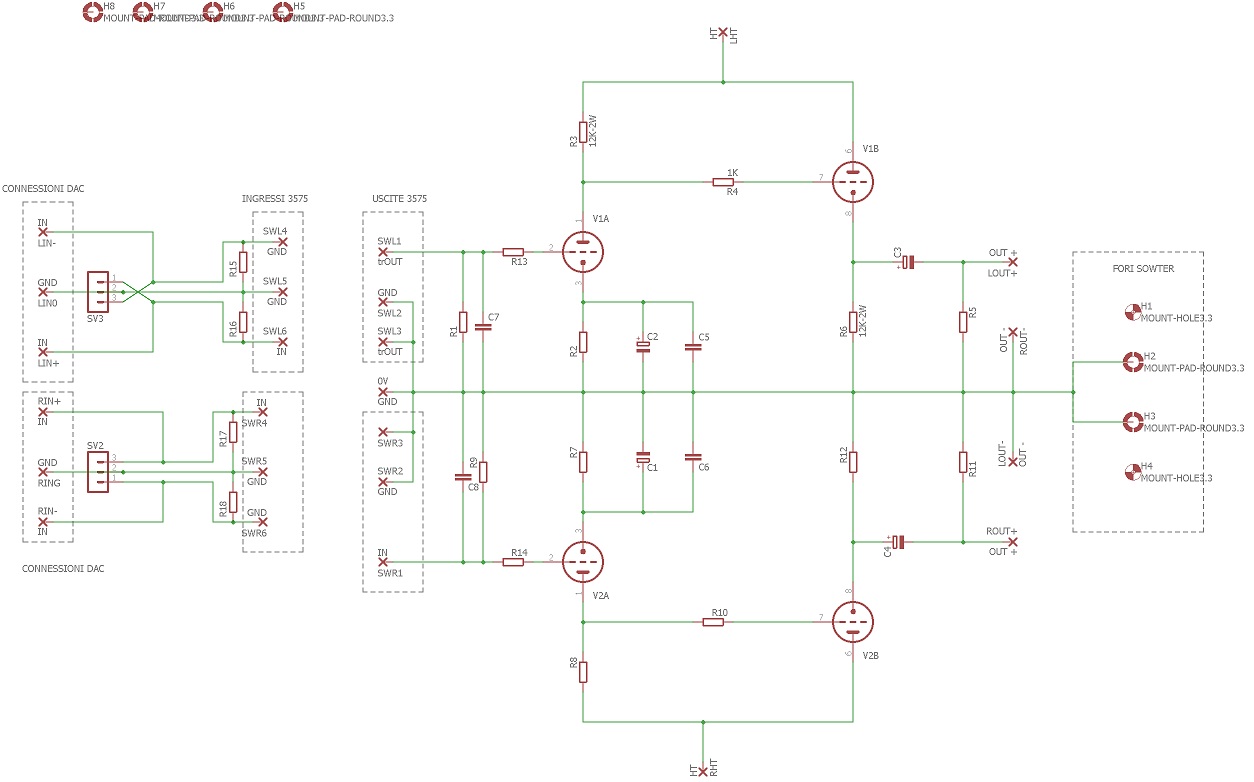

I'm search a good I/V tube converter for dac (generic).
Anyone can link me a Thread ?
I found some posts on a Thoosten IV converter but not the original treatises where it was developed.

If you have a current O/P DAC chip, working into a setup similar to a phono preamp, minus the RIAA EQ network, can be effective. The I/P grid to ground resistance is kept small, as you only need 4 or so mV. of I/P. For instance, a chip whose O/P is 400 μA. working into a 10 Ω grid to ground resistance yields the targeted 4 mV. signal. The DAC chip is not subjected to undue stress. A 6922 in each channel should be quite sufficient to raise that 4 mV. up to "line" level.

Okay; I'll try with a resistor.

I have used with gret success a coupling with 1:1 trafos from Sowter (3575 or similar).
Then a stage with 6922 gain + CF
Also there is an application note from Analog devices AN-912, it is interesting

Srrp gain stage followed by CF or DC Coupled CF ?
