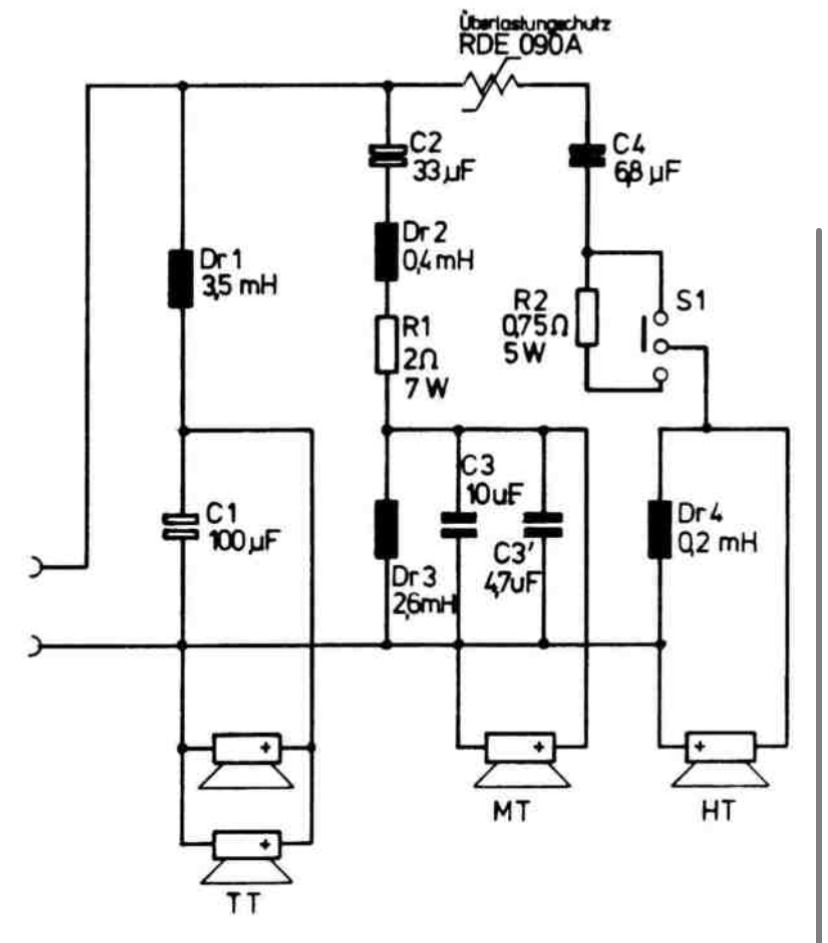

I’ve been attempting to voicing my commercial speakers; ADS L1590/2, by eliminating some excessive mid-bass. The crossover between the dual 10” woofers and a 2” dome midrange is published at 350Hz with second-order slope for both high and low pass. What I have performed was lowering the woofers crossover frequency. Yes, it introduced more gap between two drivers. Yet, it’s fruitless, the problem still remains. Still, no space between midrange and bass was heard, but a little clearer midrange which is favorable and acceptable.
By the way, the original low-pass filter for the woofers is compose of a 3.5mH coil and a 100uF cap. I altered it to a 4.2mH coil and a 150uF cap. The high-pass filter for the midrange was left untouched consisting of a 2.6mH and a 33uF. Please forgive me for didn’t take a measurement because the speaker is about 42kg heavy. Nevertheless, trust my ear there’s a problem at mid-bass region, an Umm sound along with male’s voice and some upper bass boom.
I’m unsure whether that mid-bass comes from “upper frequency of the woofer” or the “cabinet talk”. However, as described above, I’ve done something to the woofer.
Consequently, I’d like to request for advices. What should I do next, without measurements? As far as I can think:
A) continue lowering the crossover point of the woofers’ low-pass filter
B) modify the cabinets, my friend suggested me to install the damping material for car’s doors to the cabinet walls.

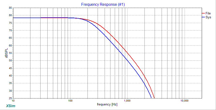

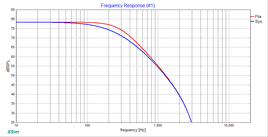

I think you're going about this incorrectly given your description of what you are trying to chage. You may have more luck modifying the Q of the woofer filter also to change the shape of the knee in the crossover. If you do that correctly, you can impact the midrange less while suppressing some of the midbass/low midrange.
This model is using flat frequency response and impedance just to more clearly show the basic shapes.
Red line is 3.5 mH with 100 µF. Blue is 4.2 mH with 150 µF. The biggest difference is actually around 650 Hz.
In this one, the blue line is 5.1 mH with 68 µF.

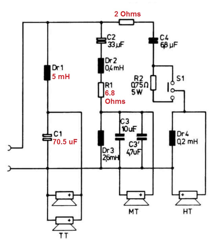

I’d like to report the progress that I currently have successfully achieved the goal. Big thanks to @mattstat, I ended up with the 5mH and 70.5uF combination for low-pass of the woofers. The science is this combination yields a lower Q while remaining the same crossover point. As a result, the low Q gives “more control” to the woofers at their crossover region—here is the mid-bass region. The speakers are no longer have mid-bass boom. It reduces amplitude at the corner frequency about 3dB. Moreover, it allowed me to increase attenuations on mid and high further from previously 2dB to 3dB as well.
All in all, I got the new response curve matches to the original but have +3dB on the bass of lower than 100Hz region. I’m really satisfied with this result. It’s happy ending.
