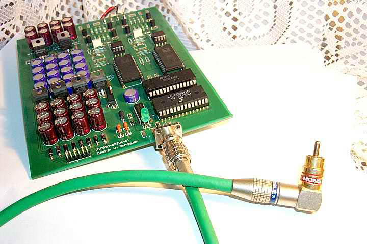

Becuse the AD1864 is very same the AD1865 one the level. but the AD1864NK is not easy to get one.
I think the NPC5843 fit the AD1864 is enough,and other, because
I have the NPC5843 stock, so .
Maybe I can made a DAC using AD1862NJ , each channel using 2pcs.

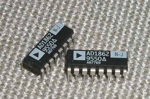

AD1862 N-J is best R-2R DAC for today. Poorly only that , it too stopped in a manufacture.
Don`t use R-2R parallel or balanced. A single DAC per channel is perfect. Parrallel or balanced R-2R DAC will kill a sound. Better use trim circuit for tuning LSB.

So I keep a few for myself use,I will do it next after DAC for normal use. (AD1864NK board is for PC audio)
The best R-2R DAC in today,I think AD1862NJ and PCM1702(or 63),is best choose with two type sound quality. so all good.
Parrallel use the R-2R DAC is no problem, the LSB adjustment is require.is my mind.
