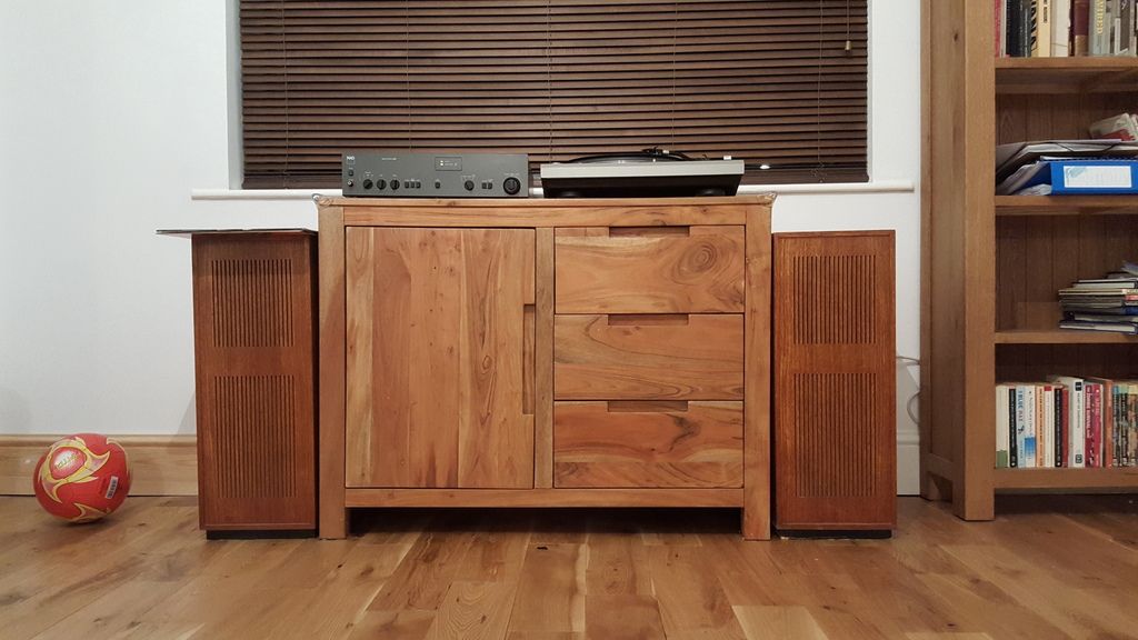

I've been renovating my house for a couple of years now and I've just about got the living room finished. I've knocked it through into another room to double the size, it's about twice as long as it is wide now, 30m2, I've stripped all the wall paper and had it skimmed by a plasterer and repainted the fresh plaster. I've replaced the carpet with oak flooring and high skirting boards. It looks really nice. I haven't finished the skirting yet but as the wife and kids are away for the weekend I dragged the bare bones of my big HiFi kit out of storage and rigged it up so I could listen to some new vinyl. I think I've ruined my acoustics no matter what I do It sounds like I'm sat in a shipping container, there's nothing in this room but wood and leather and solid walls it sounds so tinny.
I was really looking forward to some serious HiFi again and now I'm going to have to wait until I do the next room, my office, which will be thick carpet an wall to wall tapestry I've just decided!

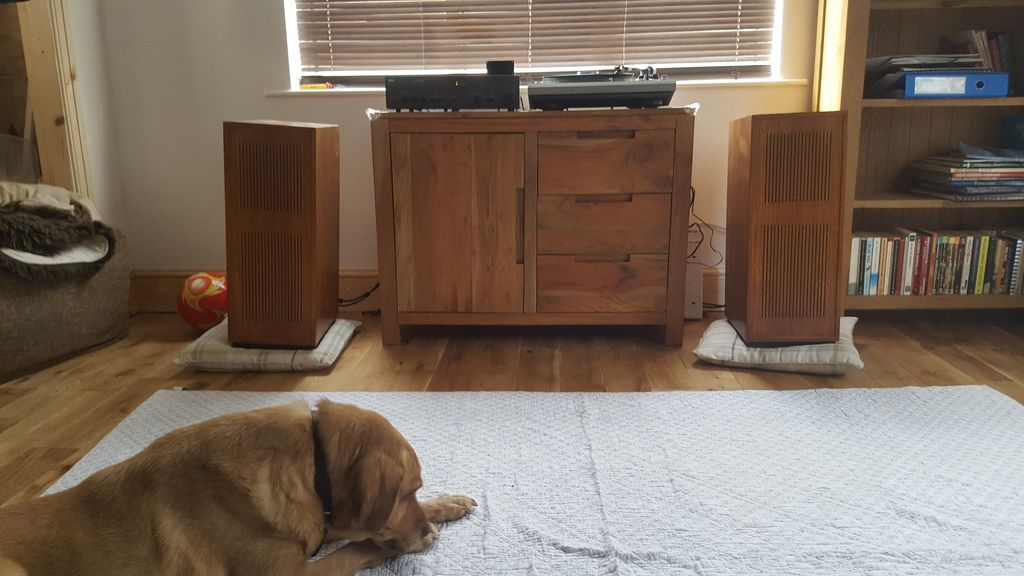

I've been playing with it a bit positioning throws and the odd Labrador around the room to try and soak up some of the reverberation.
I'm not sure if I am imagine it or not now but isolating the speakers from the floor seems to have improved matters a bit. I wonder why?

You all missed the the first and foremost non negotiable - Flat hard surface between the speakers is very bad.🙁
Now that you moved the speakers forward from that cabinet, you should have a more accurate soundstage - less diffraction and reflections above 1KHZ.
Remove the cabinet from the center, place components on a lower open shelf stand -a really low stand, absorb on the wall below the window, turn the blinds at 45 degrees facing up and leave carpet in front. Then move speakers in and out to find the flattest bass possible while paying attention to the soundstage as the speakers get close to the wall.
Things certainly improve when I pull the speakers well in front of the cabinet! the sound stage is so much better. Thanks Joel
I need to keep everything as toddler proof as possible which is why the speakers are all tucked up next to the cabinet. But I'm quite happy to pull the speakers forward and chuck my beanbag chair in the optimal position when I get chance to do some listening.

Try it with nothing between the speakers by moving the rig to one side. It can have a dramatic effect on imaging.

- Try to put your speakers facing the width of your room, and not the length.
this way your speakers would be far from the corners and side walls.
- To get the best bass definition, the speaker cabinets, should not vibrate at all (specially back and forth).
putting them on soft pillows is a No No. three spikes on bottom of your speakers are sufficient.

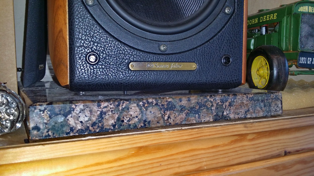

If you are worried about your nice floor, you could use heavy garden flags or Granite slabs (as heavy as you can manage),
sitting on three thin pads (not to scratch the new floor) and then speakers spikes directly on the flags.
Three spikes and three pads means 'no wobble'!

Here is what I did to my office speakers.
The slabs are left-overs from my kitchen.
