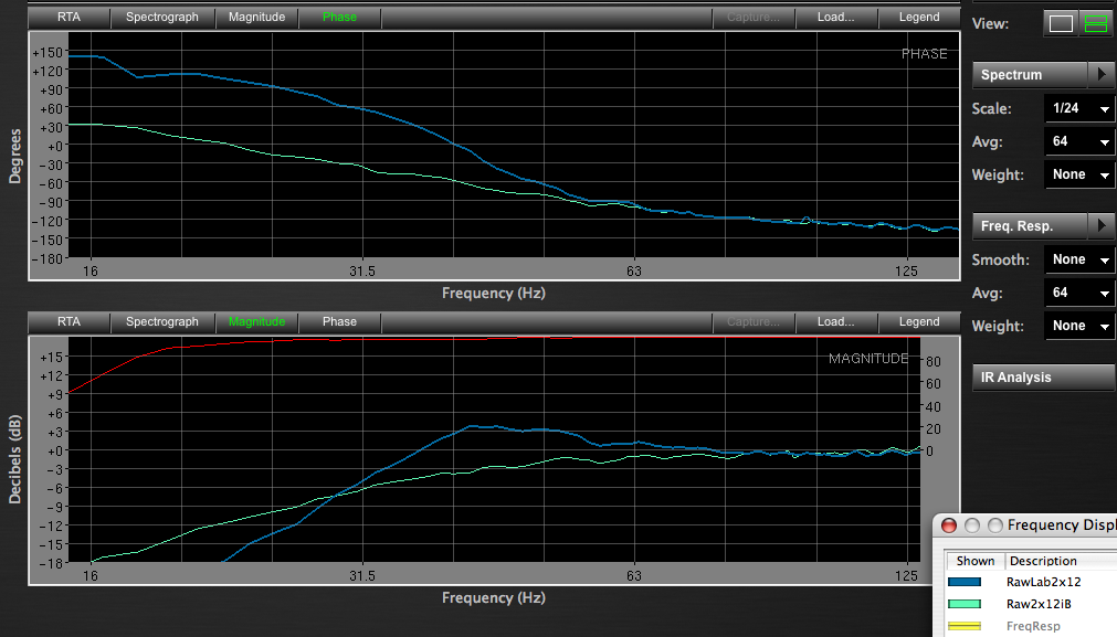

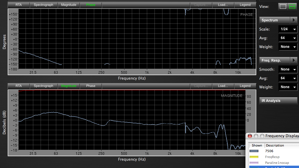

Below are magnitude and phase response charts of Sony 7506 headphones (7506Phones) and Lab 2x12" in a 36Hz Fb box(RawLab2x12) , and the same speakers with the ports sealed (Raw2x12iB).
Ported vs sealed is a trade off of LF volume vs transient response, though the LF phase response of the studio standard 7506 phones is somewhere between the BR and sealed Lab 12 response.
As you can see in the magnitude response chart, the Lab 2x12" Fb 36 box has as much as 6 dB more LF output than the same box sealed (IB) down to just below the low B on a 5 string bass guitar.
It takes four times the power at 40 Hz (low E on a four string bass) for the sealed box to achieve the same level as the BR, but the excursion at that level (assuming the speaker wouldn't burn up, and have extreme power compression as it actually would) would make the sealed box distort like a pig.
To maintain good impact, a sub must be matched in phase response to the top cabinet at the crossover point. The phase response down low, around Fb, is not nearly as critical in terms of sound quality.
To my ear, I generally prefer the clean LF output a BR offers over the "transient perfect" but low output level a sealed box can have.

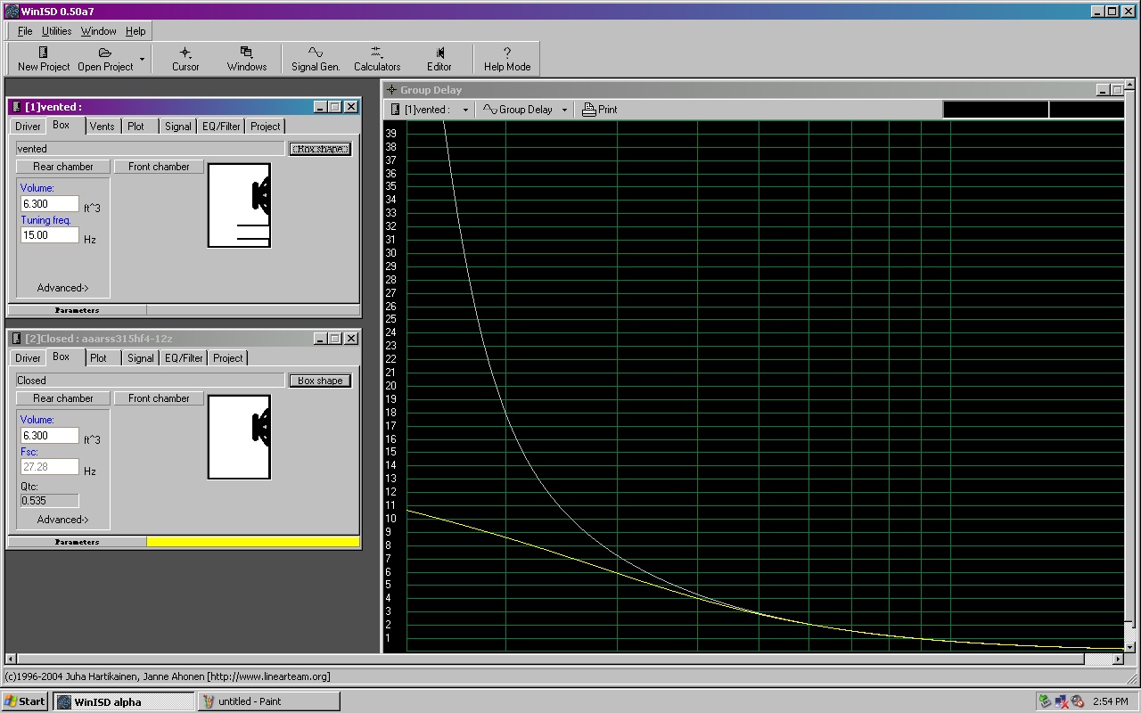

I've read that below a certain frequency (say 30 Hz) you can't tell the difference in transient response between a sealed vs a ported enclosure, although a ported is 2 to 3 times worse.
Below 25Hz and 30ms of delay the perception is negligible as the only thing you have to tell if the sound is behind is the 1st harmonic which is below 50hz.
In contrast if you have a BR box tuned to 50hz and the kick drum is tuned to 60hz with the first harmonic at 120 you will notice the ~35ms delay a lot. With the right driver in the right sized box (I use a sealed box volume Qtc ~.5) tuned very low (12-16hz) the speaker will sound like a sealed box down to ~30hz, then shifting to the Qp as the port couples to the box volume.
The pic below is the group delay for the rss315hf-4 in the same box volume one ported one sealed. I happen to have this design sitting in front of me and it sounds great.
edit: sorry you can't see the Hz at the bottom of the graph, the far left is 10Hz, 30hz is where they are 1ms apart.
