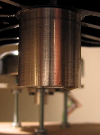

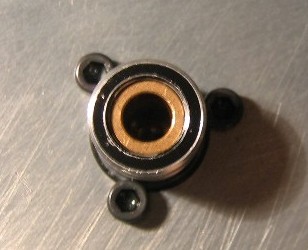

Here are the pictures. The bearing assembly unbolts from the subassembly. The bottom bearing looks just like the top. Its hidden behind a little plate that has the thrust bearing integrated into it.
Note the MDF, this is the remains of one beatup oracle alexandria.

which version Alex?
if the plinth is mdf, painted , then it is a Mklll. If aluminum , then a Mkll. How did the bushing get beat up? I've owned my Alex for more than 15 years with no problems.
Except the mistake of putting an old SME 3009 on it, and never getting it "right. Finally put a magnesium 309 and magic...

I don't remember which one it is.
The original plinth was a composite plastic. The spring tower mount broke off of the table.
As for the bearing, if you do some reading you will find that most of the bearings in these tables are worn. its very common.
I could never figure out why I wasn't happy with the sound of my table and after the advice of some guys online I took the bearing assy. apart.
The top bearing was absolutely fine, however the bottom one is not as tight as it should be. I took apart the bearing assembly and flipped it over and slid it onto the shaft with just the bottom bearing. Lots of play.
Just for an experiement to see if it was the bearing, I ran a heavier (well tempered silicone) oil in it. The sound quality was dramatically better.
The old plastic plinths in these things sag, and then its impossible to level the table. My solution was to gut the oracle (since its already broken) and build a new plinth. Another common problem is the aluminum subassembly warps/twists. Mine is in good shape.
Also, the genious who had this table filled the whole damn table with lead!!! Thing was rediculously heavy, and it screwed up the suspension. No doubt was the reason the plinth broke.
I just don't want to go any further until I figure out that the bearing is pristine. Does not make too much sense to build a table around damaged goods.
