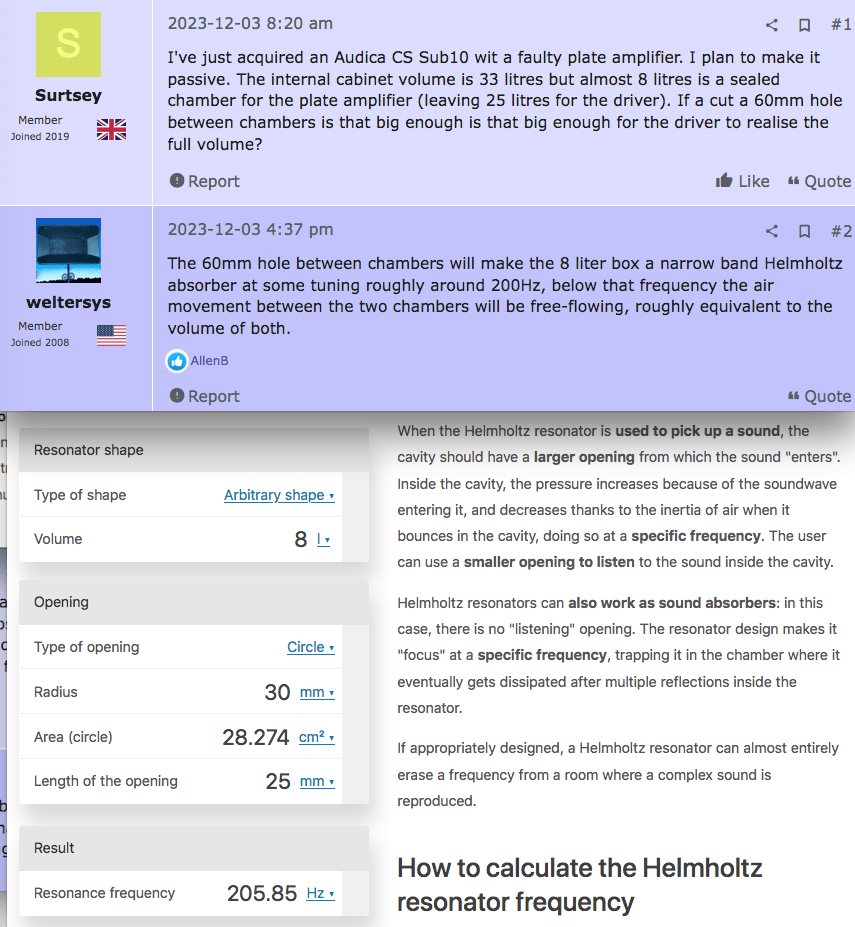

@weltersys made a comment recently which has confused me. I recently acquired an Audica SUB10 with a faulty plate amp. I discarded the plate amp and made the unit passive. However, the plate amp was housed in its own 6 litre compartment. I used a hole saw to make a 60mm hole through to the main chamber, adding the 6 litres to the main cabinet volume. @weltersys informed me that I'd created a Helmholtz absorber @200hz.

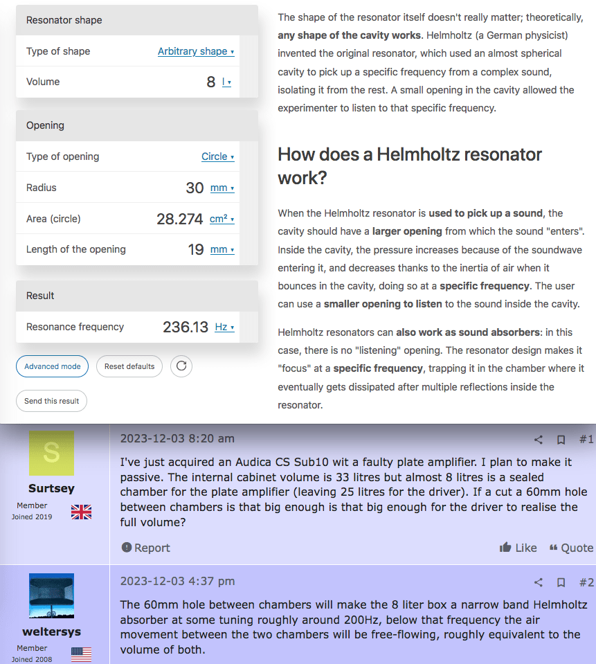

The absorption/cancellation Helmholtz frequency would depend on the chamber volume (8 liter), the hole diameter/radius (60mm/30mm) and depth, which you did not specify.
I used 25mm as a guess, resulting in around 200 Hz in this calculator:
https://www.omnicalculator.com/physics/helmholtz-resonator
The benefits of making another hole would be the chamber connections would have more area, less restriction and chuffing noises.
I don't know if those internal noises could even be heard through the external bass reflex port (s).
The Helmholtz resonance frequency of the secondary chamber would be higher, whether that is a "benefit", and the depth of narrow band "muffling" achieved would require testing.
