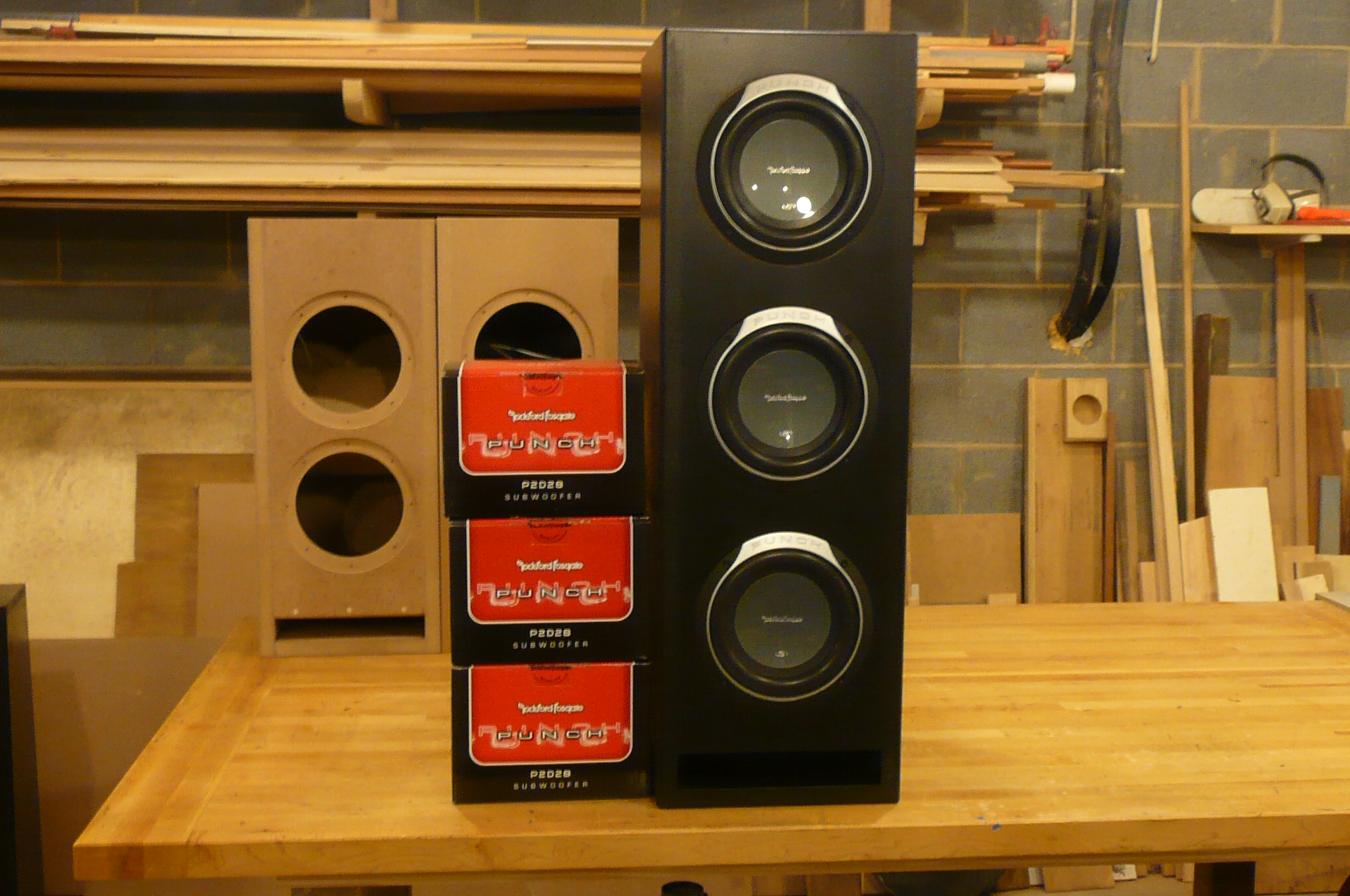

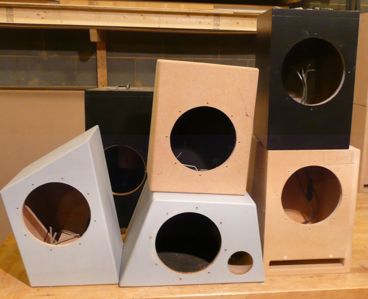

If you can find out more info on the driver that would be the best, if not take some pics.
A 8" car woofer can work in a really small box.
I'm a fan of 8" woofers, car and HT. I was on a roll for a while, cranked out a bunch of them. The tall black one has been sitting around for a while now, never used.
