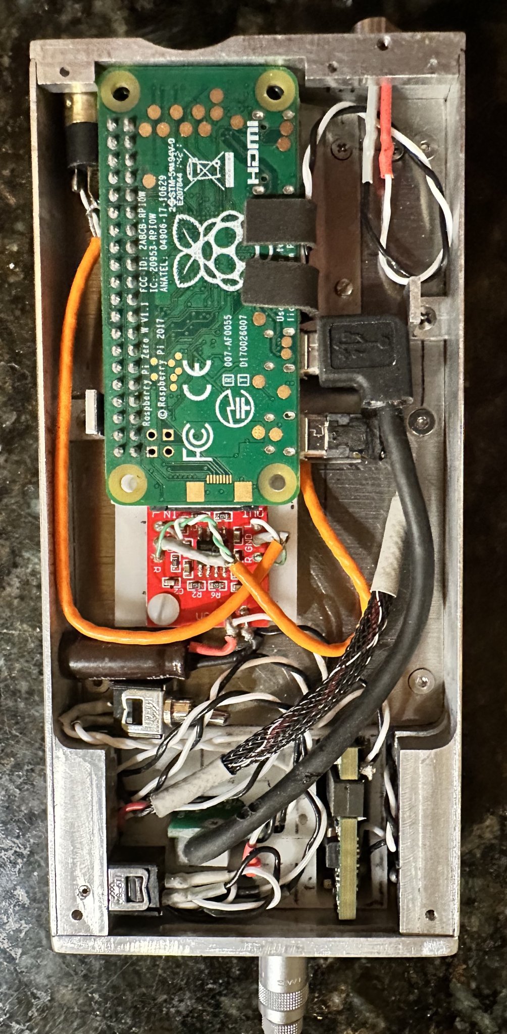

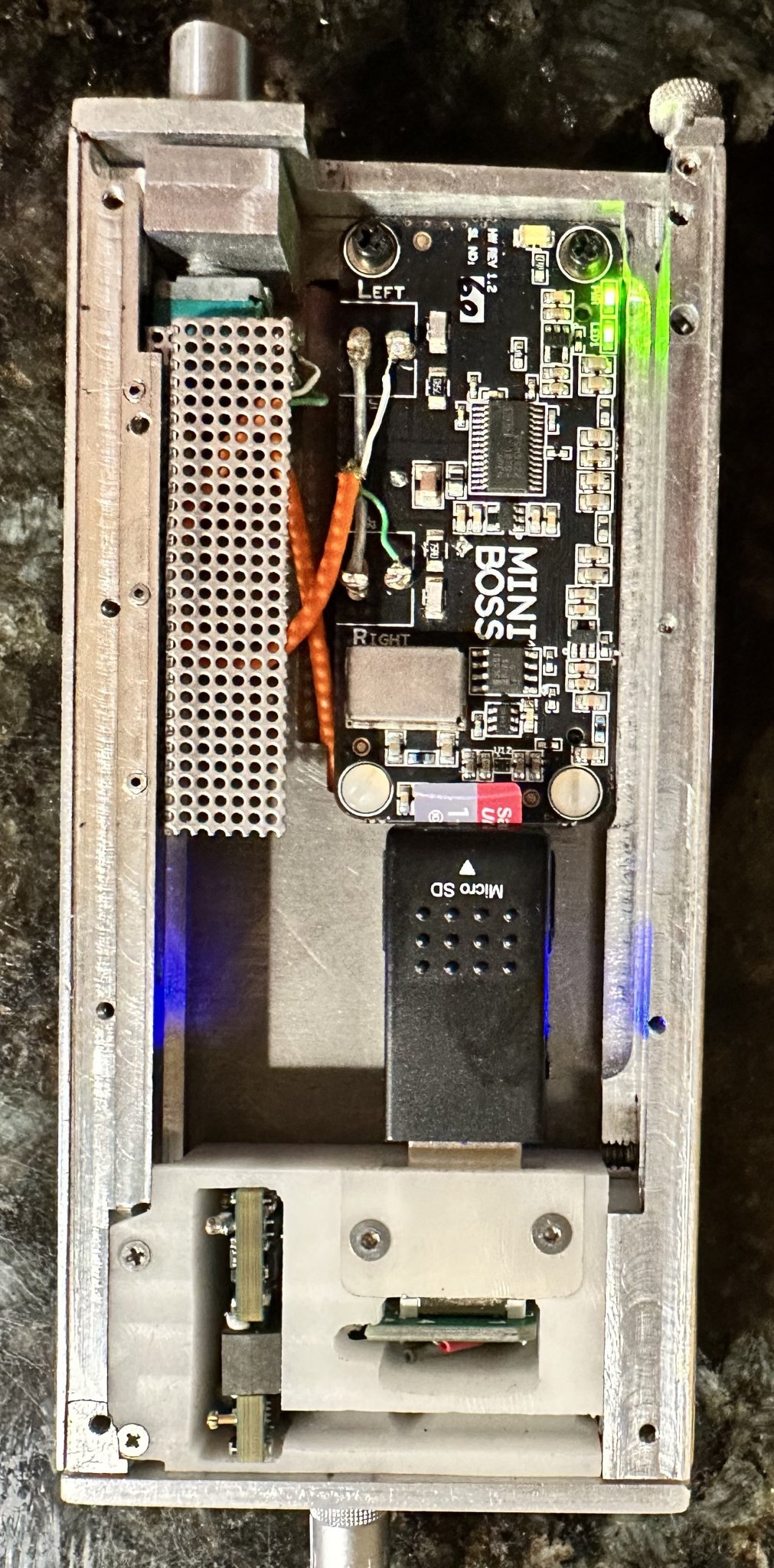

I have built a smaller version with a Pi Zero W and an Allo Mini-Boss. My first thought was to use an M.2 memory module with a USB adaptor. I also included a postage-stamp sized headphone amplifier in it for a little more signal. No batteries, but a DC-DC converter and a 12v input in addition to the 5v.
I got the Pi Zero running and set up, but for whatever reason, the M.2 memory wouldn’t mount. Plan B was a 1TB MicroSD card, less than I wanted, but it did mount and compile the library. I also picked up a 2 TB USB-C portable SS drive (Crucial X6). I have been unable to get that to mount.

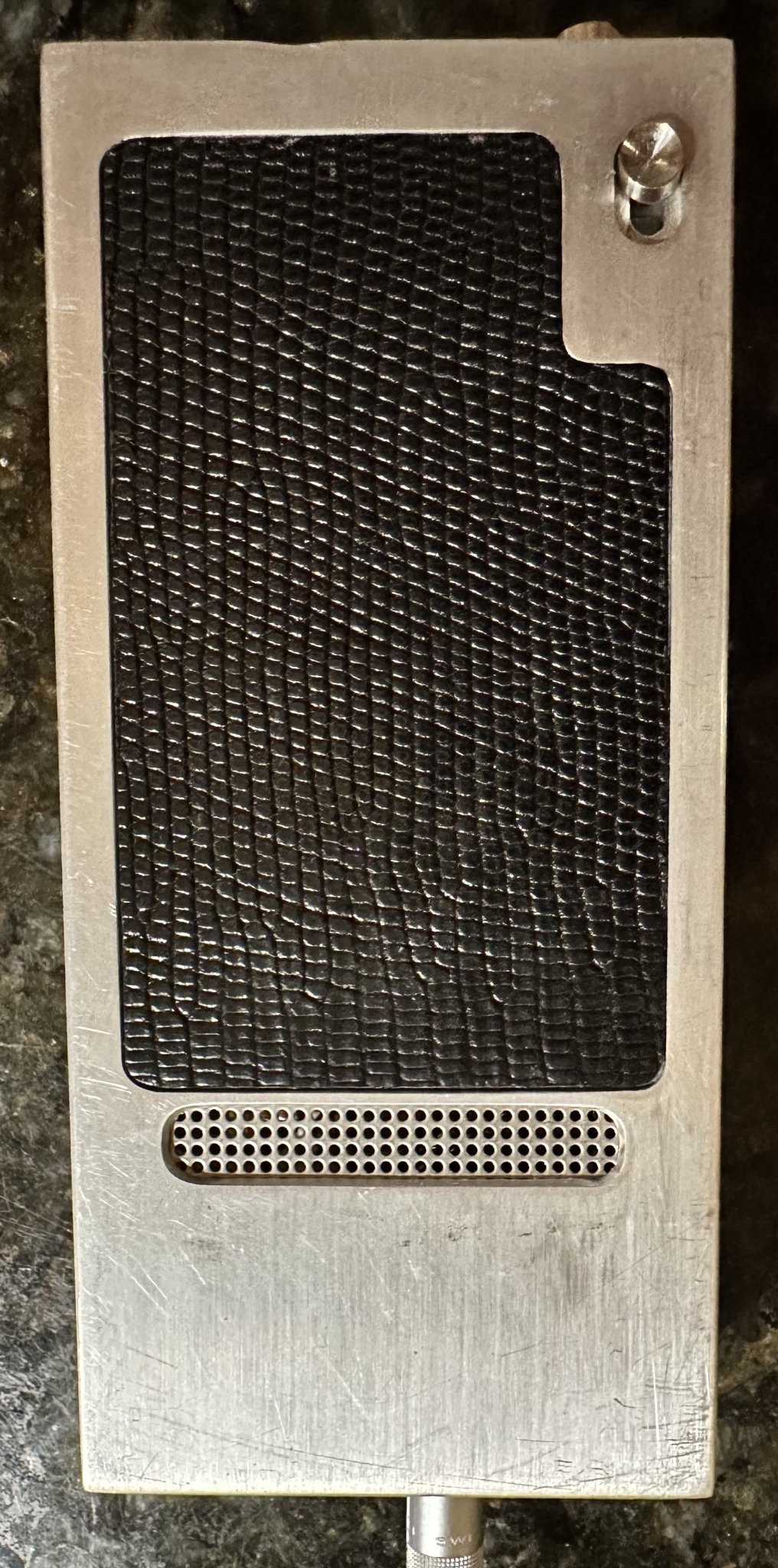

This small Pi player does play, but it has a loud ticking sound at about 4–5 hz in the headphones, and some scratchy noise as well. These sounds are always at the same level, so when the volume is turned up, the music gets relatively louder making the ticking somewhat less obvious, but it’s nowhere close to usable. I have shorted across the inputs and outputs of the headphone amp board, thereby bypassing the amp, and the volume lowers but the ticking does not go away. The case is aluminum and titanium with a plastic insert on the lid where the Pi is to allow WiFi signals to pass. If I put my hand on top of this, the ticking gets quieter.
The ground is not connected to the case, but when I temporarily connect either the power or signal ground (should be the same here), the sound does not change.
I have heard this kind of ticking before on RPis, and have no idea what could be causing it or how to fix it. I have a Pi Zero 2 W on order, as well as a couple of different USB cables to fit this tight space. We’ll see if any of that makes any difference. Any thoughts or suggestions of things to try?

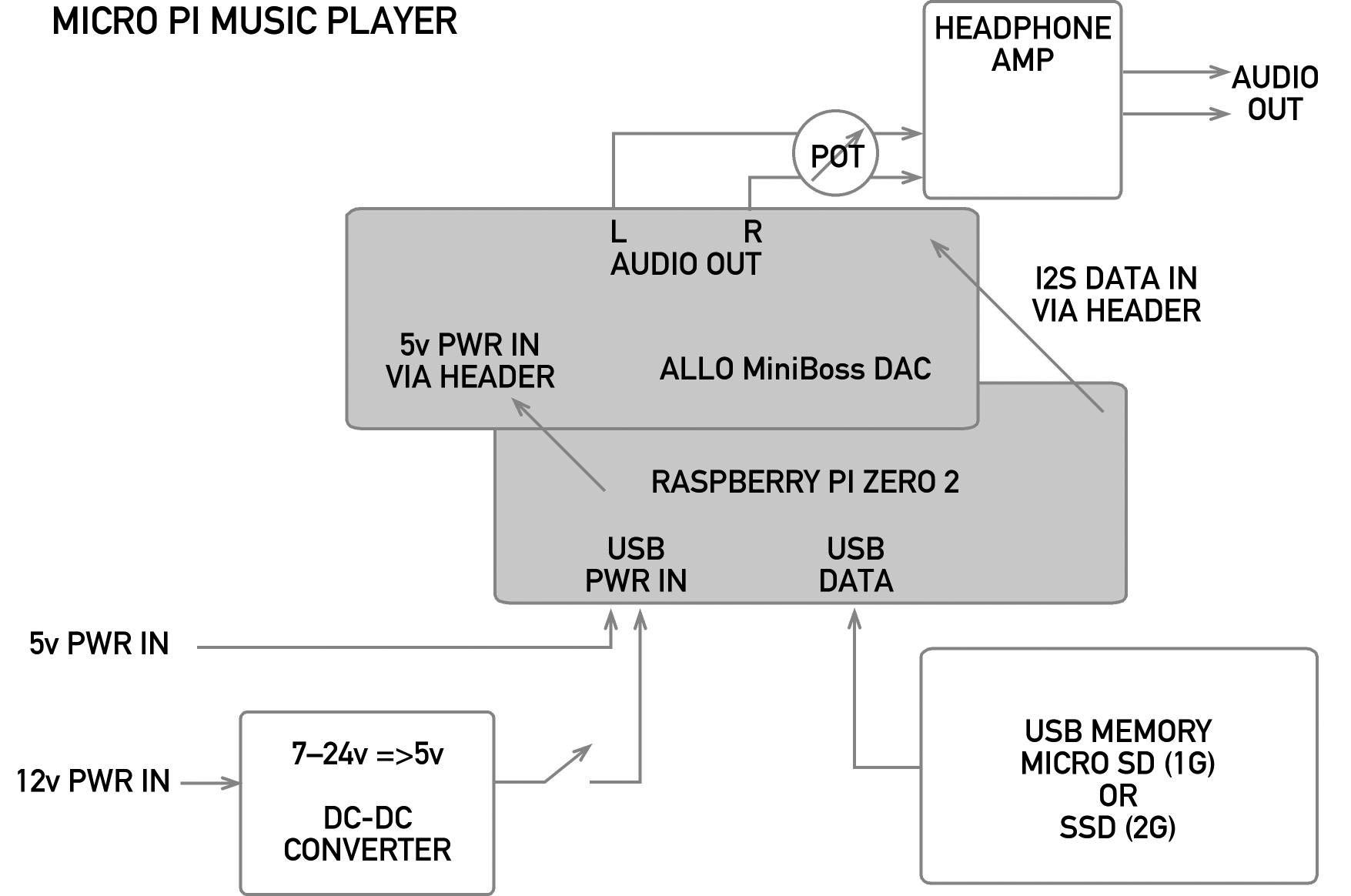

I have two devices. I understand that running a full-sized Pi on battery power is not practical, which is why I've been attempting to get a Pi Zero device working. They're both pretty similar in their organization; there's only so many ways to put one of these together. I'm not using a screen on either. A block diagram of the Pi Zero device in the photo is attached. It's the one for which I'm having the noise problem. The full-sized Pi one is pretty much the same, except batteries or an external 12vdc power source are connected to the DC-DC converter.
As I mentioned, the noise problem remains the same even when I temporarily ground the negative rail to the case. I'm still looking for suggestions for what to try to fix that. I have a Pi Zero 2 waiting to be installed to see if there's something wrong with the zero w that's in there now.
Any thoughts appreciated, including where is the appropriate point in a device like this to make the ground to negative rail connection.

Can you isolate the area where you think the noise comes from. An example disconnect the amp and listen if the tick, tick is in the audio. Power each module individually to see if it is the power supply, you must have a lot of phone chargers available. If you have maybe a few batteries around try powering each box individually with its own power source. I had a similar problem once that my modem was running off the USB power of my PC, so was everything else. Took a while to figure that out. The culprit is usually what you expect least.

I have tried several different 5v power supplies, and all give the same (noisy) results.The ticking and other noise comes out of the DAC, but I don't know whether it originates in the Pi or the DAC. When I bypass the little amp board, the same noise remains, but obviously at a lower level. As I mentioned, the noise is constant; when I turn the potentiometer up, the music gets louder, but the noise stays at a constant level. At higher volume levels it's not that noticeable.
I'm using Moode 8.5 (released in February of this year). I have the DAC/driver set for Mini-Boss.

Do you have an oscilloscope?

But getting back to the DIY solution: I'd strip the system down to its bare minimum. Can you get it running with a USB DAC and a single power supply? Build out from here.
How's the switching between power supplies handled? That's not clear from the block diagram.
