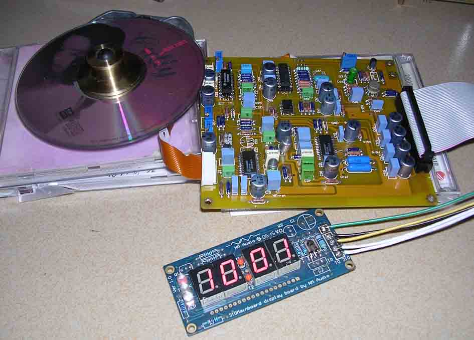

and i would like to have a show of my project
2 weeks ago i finished the test of it.😀
i once have a CDM9PRO used in an old PHILIPS CDROM.but i have not keep it for a long time.gave it to friend.
