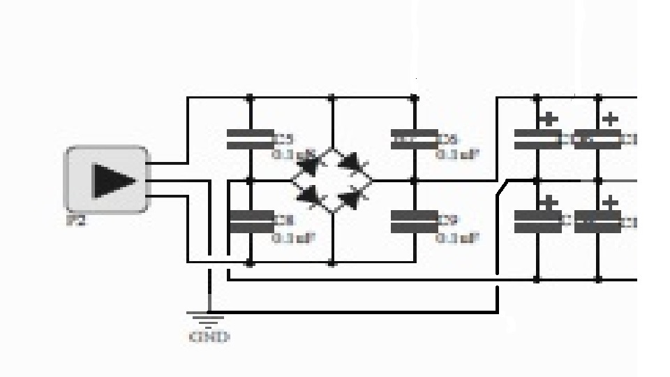

I have the parts of a PSU kit, but don't have the schematic... which should I build?
I received in the kit 8x 10nK400 caps, 2x BR84 rectifiers, 4x 10000uF A7088 caps (very expensive!), and 4x 10000uF 8925E caps, but I'm not sure which circuit exactly he had in mind with such components.
The transformers I have: 2x 40-0-40v / 3.6A *
Hope I made this understandable, but most PSU's are very simple.
Lamir
* is that 4 x 3.6A in total? that's insanely high A.
Those components woulod make a simple basic PSU.
The 10000uF caps are mounted in pairs across the DC outputs of the bridge.
The smaller caps are mounted across the diodes of the bridge.

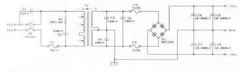

That's interesting, I was expecting something more like this:
attachment.php
From this page.
The secondaries have 8 wires: 2 x 40v, 2 x 15v. The 15v aren't useful for the amp since they're only 0.4A, but I could use it for the LED - one diode, a 270ohm resistor, and I should get an ON led..?

Don't take too much notice of what appears on the TNT Audio site. They appear to believe that scattering capacitors around will fix problems (possibly non-problems) yet are not too bothered about putting grounds in the right place.
I am not quite clear what the point of this thread is. Given a normal set of PSU components one can make a normal PSU. The usual mistakes people make when building these do not come from the circuit but from implementation details, such as grounding and wire twisting, so the circuit more or less writes itself.
That's not a good psu for audio. AndrewT will sort you out.
Why is it not good? C1, C2, and R1 are there for no reason?
Also, for safety, always put the mains fuse as the first thing your power cord connects to. Never after the power switch.
First thing to happen when I connected the (a single chan) PSU to mains: blown F7A fuse. I'll add a soft start, it'll make it safer too.

4 x 10 000uF 63v caps is consistent with 2 x 40v windings. This would make a +56v & -56v supply with 1 rectifier bridge and 2 x 20 000 uF caps.
The second set of 4 x 10 000uF 63v is not consistent with 2 x 15v windings. This would make a +21v & -21v supplier that requires no better than 25v caps.
Could be there are other configurations I did not guess....

Try to keep the PSU symmetrical. ie use one of each type on each rail in parallel with one of the others. I would add a small resistor between them in CRC configuration, something like 0R1 3W.
