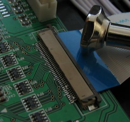

i have problem with my Hami lcd. help
i opened the lcd today, and accidently tear the cable out of the board.
how can i fix it? please, some one help.
i am so helpless now.
thank you
I don't see anything wrong in that picture. If the cable is loose but not broken and you want to put it back you just pull out the darker piece of plastic on front of the connector, put in the ffc as far as it goes, and press back the plastic piece.
