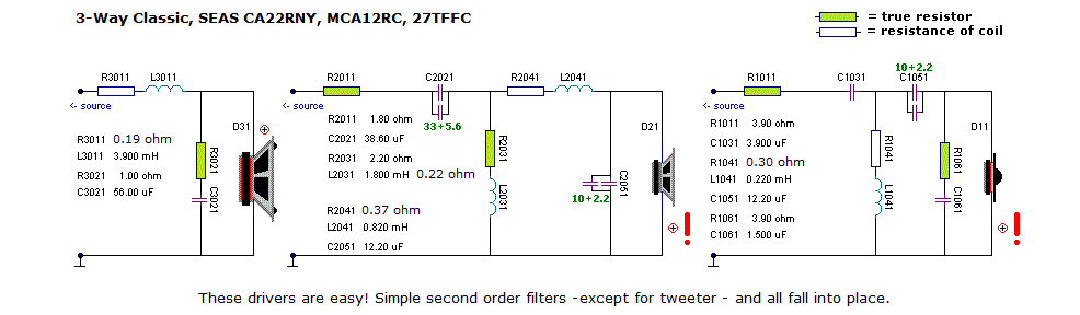

I have the option to buy 4 driver units as part of an estate sale, a sad story for someone I know but life goes on.
There are 2 Monacor SPH-102KEP and 2 SPH-200KEP, unused and still boxed, asking price is €150 for the four.
Speaker cabinet and crossover design I last took notice of in 1976 when I built a pair of closed 3 way cabs with Fane units. About the only thing I knew was to make a seperate enclosure for the mid range and buy some good sound absorption batts to line the cabs, chipboard cabs I might add😱. The crossovers were probably very wrong off the shelf units from Central Radio in Manchester but it all sounded good from a QuadII gifted to me.
Are these drivers a suitable pairing to use in 3 way cabs with a tweeter yet to be decided on?
I might find it easier to buy some drivers with well established and proven cabinet/crossover designs for I know that cab and crossover design is a skill that can take years to learn but I cannot resist a bargain.

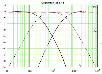

If you are up for it, I think we can sort out a filter easily enough, like Troels Gravesen's 3 way classic:
The theory is easy enough:
You will get a superb result, even if Kevlar drivers can have some breakup. That's what you are in for.
Looking at the spec sheets, I'd say they'd make a good 3 way, perhaps starting with a simple 2nd order LR crossover. Two concerns - the rising response of the 102KPE may need to be dealt with; and if they've been sitting unused for years, suspensions tend to harden, they may take some breaking in.....

I just reviewed those Monacor drivers. 90dB reflex woofer, 85dB mid. Both with better than usual low impedance. Looks very similar to Troels' 3 way:
SEAS-3-Way-Classic
The woofer has a bit of Kevlar breakup around 7kHz, but you could take that down with a simple tank notch if necessary. I think Troels' filter would work as is. Maybe increase the 0.82mH to about 1.2mH in the mid filter, but I don't think it will matter.
SEAS-3-Way-Classic
