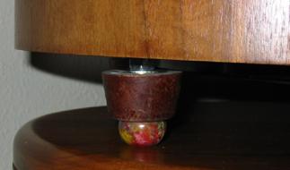

I'm interested in how you couple the sub to the floor as I make down-firing deep-bass units too.
I find that as there is no real likelihood of backward/forward movement, spikes are not necessary. Therefore, rather than couple to the floor I tend to isolate.
I'm currently using door-stops bolted to the bottom of the bass speakers and these are supported on 'superballs' (childrens' toys). This is a low-cost solution but works well. I don't glue the superballs to the door-stops but tend to just slip them under in situ.
The floor doesn't vibrate as much and this gives a cleaner bass.
Just to repeat though, I recommend this for downward or upward firing subs. With others the results may vary.

Interesting. I always have been told that spikes are necessary in downfiring subs. Do you have a simple sketch or a photo of the system you use in your subs?
In my DIY project I did not use real spikes, I used some rounded nuts that act like spikes due to the small contact area. This solution works fine, at least everything else except for the contact points of these nuts and the floor rattles with the low deep frequencies produced by the sub, I guess.....

I haven't found spikes necessary. They just rattle the floor boards. I've attached an image of the bottom of one Little Awesome which is on top of another one. The same applies when they are on the floor though.
Thinking about this a little ...
It's cheap enough to try an arrangement like door-stops and superballs. You could just place the door-stops on the floor with the superballs on top and the sub on top of that. I suggest four of these supports.
Then you can listen and compare the sound to your rounded nut supports.
Whichever sounds better to you after a reasonable trial IS better.
PS: One further advantage of the decoupled rather than coupled approach is that there is a reduction in the transmission of bass throughout your house (and sometimes beyond). This may be important if you have young children or others you don't want to disturb.
