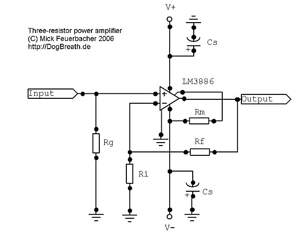

I have one of these left from a cooked 2 ICs Behringer amp - I suspect it was the other one cooked so I kept this one, I guess 50-50 it may work.
Is there any way I can test this with a meter other than building it into an amp first ?

I built the chip into a 4 resistor amp (muting bypassed) and I get nothing in the ouput, no great current drawn either
Then I measured that pin 3-out to 7-gnd is 33Ohms only - is that how it should be ?

try this it's about as simple as it gets and cheap too just for testing, test and see if you get any dc on the output this would indicate shorted output transistor if nothing input a signal and try it on a scrap speaker, hope this helps.
