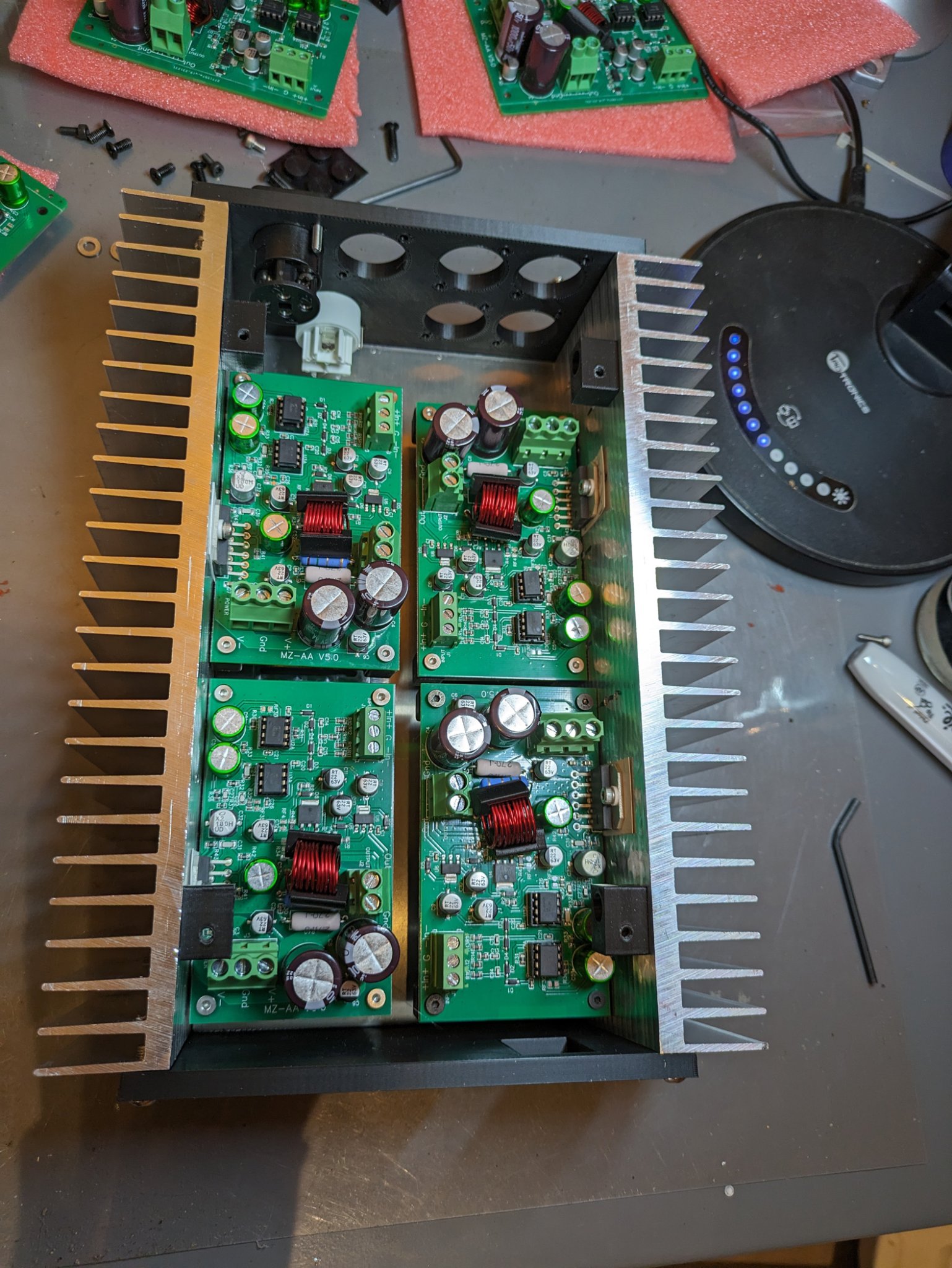

I just built 20 high quality composite chipamp (class AB) amplifier boards but only really need 10 and would like to sell the extras. These are my version 5 (sigh) but they're finally pretty good and what with high fixed-costs I decided to build more than I need.
Contents: completed and tested amplifier board(s)

My personal opinion is that these sound better than any amplifier I've ever owned. I listen to music at moderate sound levels on fairly efficient speakers. I use 4 of these amplifiers per channel (two in parallel for 4ohm woofer, one mid, one tweeter) in a DSP amplifier setup (so 8 total for stereo) - hence the need for 10.

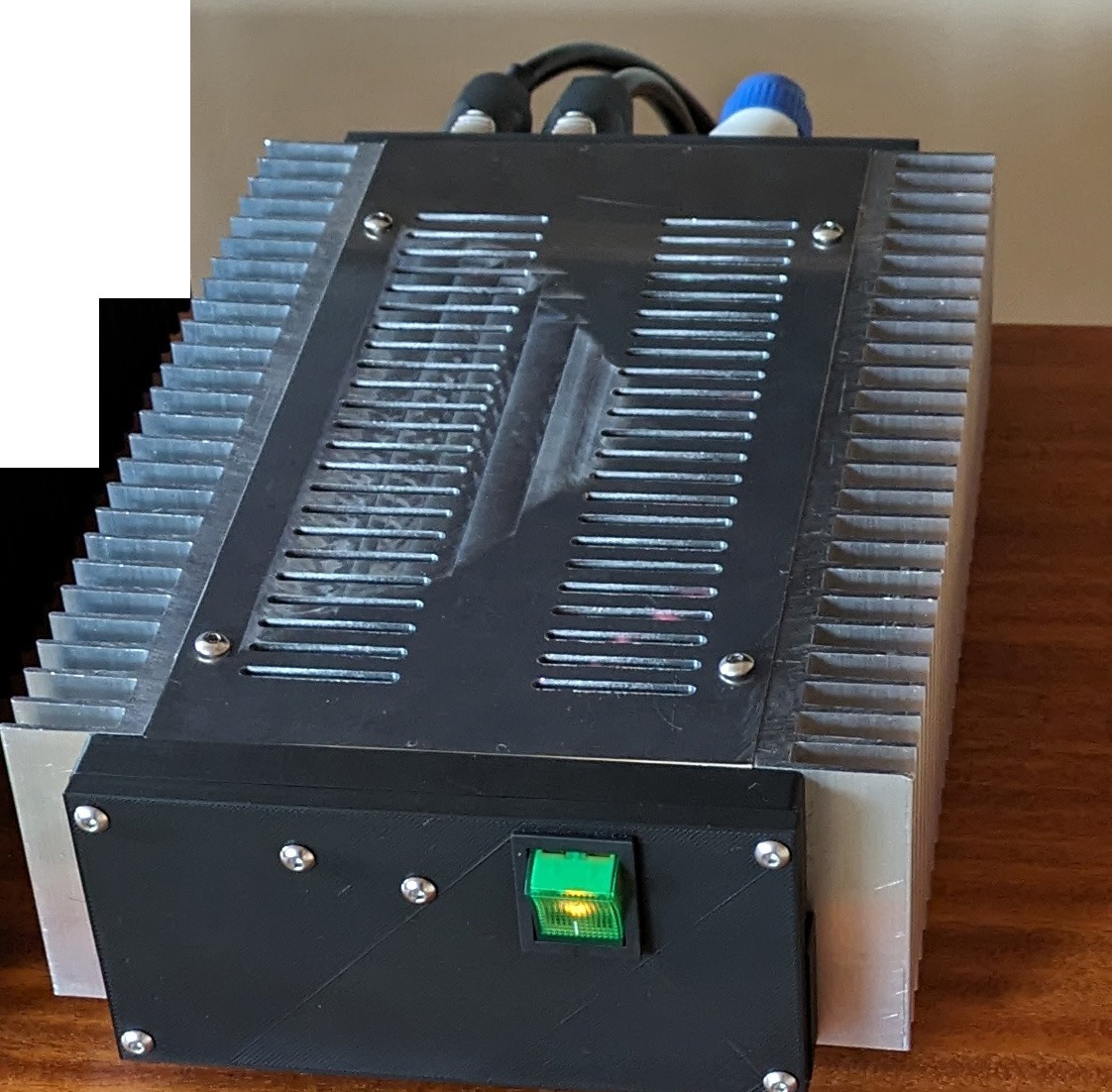

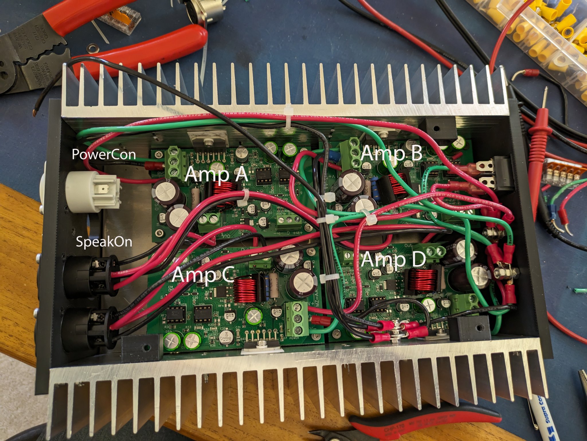

Here's the (first version) 4-channel amp wired up and running a 3-way speaker. The S/N ratio is 101dB (rounding up). Note 5W@8 and 10W@4 and above measurements go through a resistive divider which reduces the S/N ratio by 3dB or so..
The power wiring here is causing the THD of the top right amp to nearly double from 0.0011 to 0.0018 at 5W@4 but the S/N is unchanged at 101. B2 is after moving the wiring out 1/2 inch. The enclosure is a bit tight for running wire and general maintenance. Next enclosure will be slightly wider.
The enclosure is 10"x5"x3" internally - and I caught the SpeakOn mistake.
