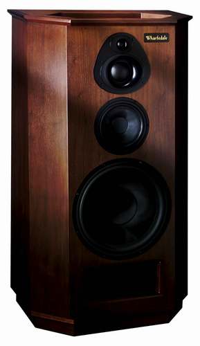

I dream to DIY "Wharfedale Airedale Heritage", please help me
So, It (Airedale Heritage) is my DIY loudspeaker project in dream but I don't know any schema and speaker components (driver, crosscover...) for DIY it
Who can help me now, please.
Thank you so much

Well, there's enough info in the product brochure here to design a clone from:
http://www.wharfedale.co.uk/images/ranges/brochure_24.pdf?PHPSESSID=4ccc6bf4ccc154534e2b6692d6a39ad4
But I think it would be expensive (especially if you want to use Alnico drivers), and huge, ~ 180 litres.....and as a 5 way difficult to implement
I think you could get as good a result with modern drivers in smaller cabinets, (but it wouldn't look as impressive...🙂
I guess the starting point is to decide what drivers that can give a similar response will suit your budget.
a 15", 8", 3" mid dome, 2x 1" tweeters & a super tweeter per side...😱

Alnico is the type of magnet used on the speaker, not a brand name, very hard to find nowadays.
If you want to make an exact copy, Wharfedale make their own drivers, if you bought drivers from them (assuming they were available) I'd imagine they wouldn't cost much less than buying the Airedale.
So, if you're rich, buy the Airdales, if not (like most of us) decide your budget and build a clone. This means finding speakers within your budget that will give the same performance as the originals. I'd suggest looking at SEAS and Peerless drivers as a good place to start.

2 or 3 way is much easier;
I don't know much about 15" drivers so someone else may provide a suggestion (Maybe P-Audio HP15W?)
with SEAS 8" or 6.5" mid, & SEAS tweeter.
Look at the 2 way projects on this site:
http://www.troelsgravesen.dk/Diy_Loudspeaker_Projects.htm
and think about adding the 15" as a sub
(you can always make the cabinet LOOK like an Airedale) 😀

The Airdale goes down to 25Hz, so we need a 15" driver that is efficient, has largish Vas, and will go that low.
I once had a similar dream to Langtuhanoi about the old Tannoy York Cab, I ended up choosing the 10" Peerless 850146, which would be perfect for this application, but unfortunately is no longer available....
Langtuhanoi, an alternative to 1x 15" woofer would be to use 2x 10" woofers, for Hi Fi these are probably easier to get, and would give the same surface area as a single 15".
Most 15" speakers available seem to be for PA or Car Subs, not really suitable

I just modelled a pair of SEAS L26RFX/P 10" woofers in Unibox,
In a 180 Litre cabinet tuned to 24.5 Hz, that looks to be a pretty good way to emulate the Airedale's size, response and tuning at the low end...

The Airedale design is follows the old 1950s/60s way of doing things, that was what they had to do to get deep response in those days.
Many modern drivers are much better, so you can get as good or better response in a smaller driver compared to many of the old drivers (some will disagree of course...).
Most people (or their wives) prefer smaller cabinets nowadays, another reason why 15" isn't common in home audio.
So don't get stuck on a 15" driver...(of course a smaller one won't LOOK as impressive 😉 )
Well, the Tannoy York is similar to the Airedale,
you could scale it to 180 litres and tune the ports according to the drivers you choose:
http://www.44bx.com/tannoy/images/YorkDiag2.gif
more info on original Airedales here:
http://www.audioheritage.org/vbulletin/showthread.php?t=6204&highlight=airedale
