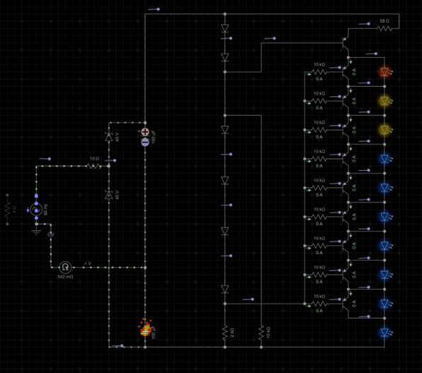

I could use some assistance with the following standard thru-hole VU design. I would like to modify the wattage points at which the LED's activate. What appears to be the variables n this example is at the Zener diodes in most of the LED circuits.
Can someone please tell me how to calculate what value Zener diodes are needed to attain activation at the predetermined wattage? I haven't been to school in 30 years and in all my efforts, in every calculation I try, I am unable to even simulate the circuit below to even get the values shown in this schematic. I am obviously missing something, and it's driving me bonkers.
Example:
LED #7, Zener diode value = 18v in this circuit, the LED activates at 50 watts and above.
- What calculation would I use to determine the Zener diode value needed to have the LED activate at 80 watts and above?
This example is using an 8-ohm speaker connected at points LS. (I am only interested in modifying LED's 5 thru 10, if that helps simplify)
Your assistance is GREATLY appreciated!

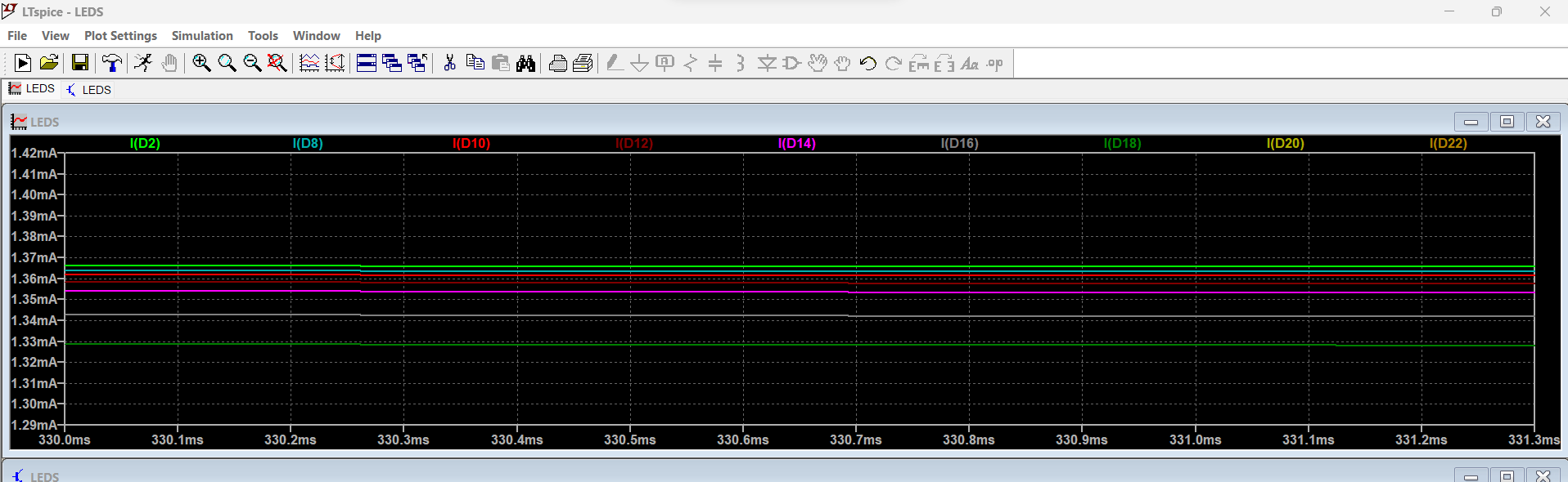

Super quick simulation showing LED current for a 27 volt Zener. Only difference here is the input voltage at 31 volts (just coming into conduction) and 34 volts peak (fully on). An unknown with currents is the fact all the preceding stages will be on. Its easy to copy the LED section in the sim multiple times if anyone has the time.

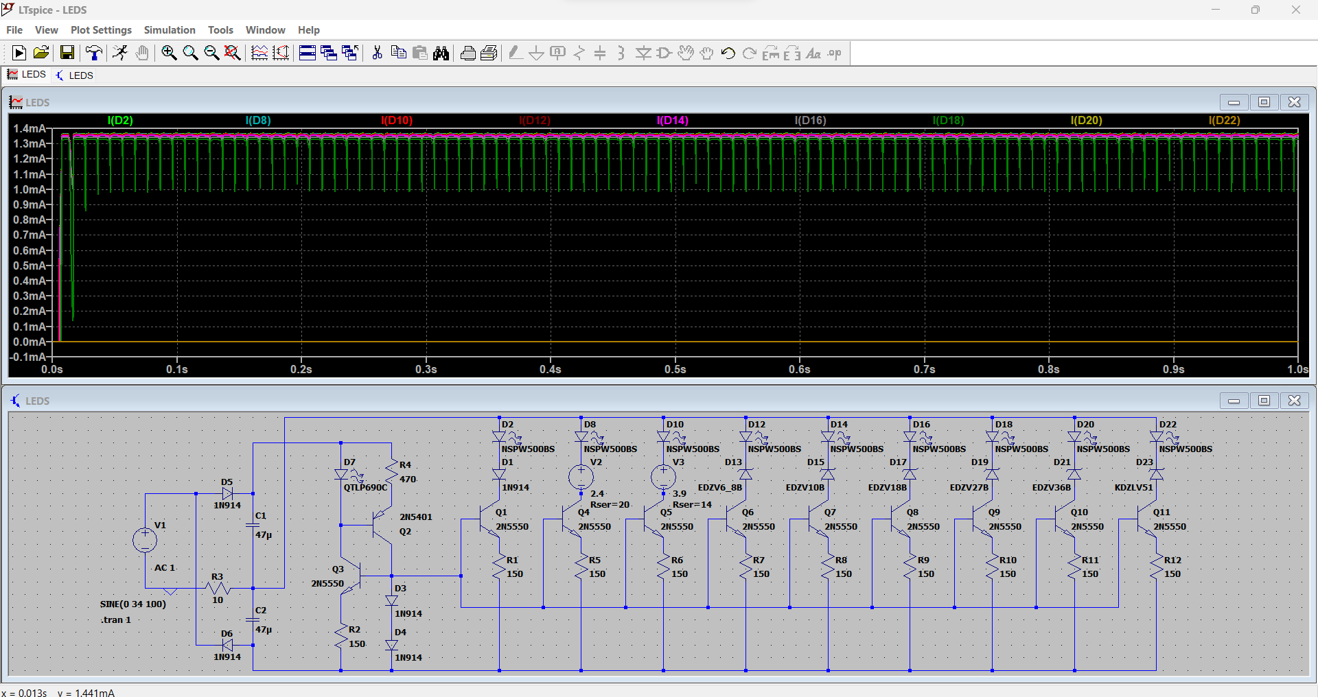

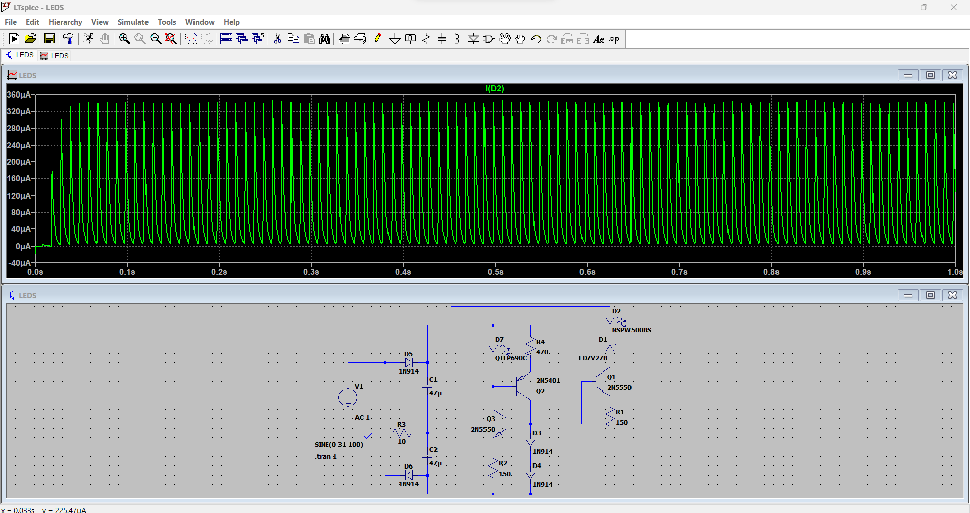

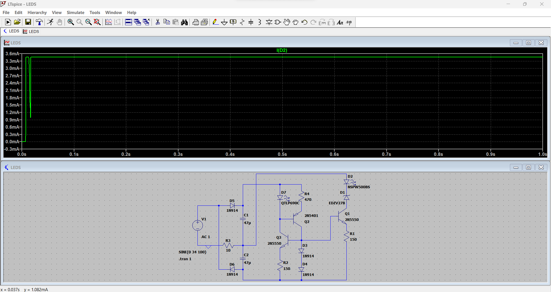

I copied the LED's over and swapped the Zener's. No models for the 2v4 and 3v9 Zener so I've fiddled those. The LED current falls as expected but is still plenty with high efficiency LED's. The last two LED's here are at zero current (traces overlaid.
Currents in detail:
Currents in detail:

I was thinking of getting LTSpice. Do you like it? I am currently using EveryCircuit.com. Visually, it's good, but it has no canned components to pull from, so its manual entry 100%; and the parameters for Transistors and Diodes are non-conventional parameters that are driving me mad (meaning they don't correlate to datasheet parameters of said components). I would like to know your thoughts as to what you like about LTSpice, for comparison.
Also, with the Sim above, I noticed you dropped R12, and the circuit still sims. I'm just curious what drove that choice?
My ultimate goal is to find a way to Sim the circuit so that I change out the ZD's with various other values to see the net effect. I would like to be able to morph the LED's to approximate power levels of my choice.

Thank you, @WhiteDragon! I downloaded the Tina software, and the parts library had everything I needed! It had all the parameters necessary for the sim software I was using! It's also very functional. Much appreciated!

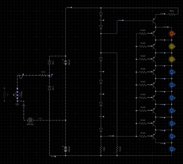

Hi @Elvee,
Thank you for this design! I modeled it in my animated sim program, and the LED lit up on my first try! Nice! 🙂
I did notice something that may cause issues, at least in my application.
- Since my design is meant to be placed in parallel with 4- or 8-ohm speakers, such variation will likely cause issues with the amplifier.
Nothing against your design, it obviously works just fine and is solid. I am only pointing out that I do not have these issues with my design in my Sim. My design ohms out between 3.87 and 3.99ohm when in parallel with a 4-ohm speaker, regardless of frequency (at least in my sim). I have built several live CCA's of my design and have them in use to this day, so I am confident in the design. I am sure that my issue here mainly lay with dusting off my brain and learning the sim software quirks so I can adjust my meter to my liking.
I appreciate you, and everyone that has helped me. I am blessed to have found this website and the great people here.
- I noticed that the reaction time of the LED's activating was significantly slower than my schematic. (Could be an artifact of my Sim software, so may not be of significance).
- I also noticed that the circuit seems to be very reactive to variation of frequency of the sine wave. It reacted fine during 1Khz and above but burned the caps at 100hz and below.

Sorry but that schematic is wrong, or at least very poor.
ALL transistors activate at the same time 😱 since all bases are joined and all emitters are identical: 150 ohms to ground.
All zeners do is making higher power LEDs weaker or turn on later; you will get exact same results with a passive VU meter: only Leds, Zeners, and some current limiting resistors.

These are all artifacts: the frequency response only depends on the 100µ capacitors, and if you want the circuit to work at very low frequencies, you simply need to increase them.
If the voltage rating of the caps is compatible with the power of the amplifier, there is no risk to blow them.
The value given by your ohmmeter is completely nonsensical: the impedance cannot go lower than the 10ohm series resistor.
You should use a less fanciful simulator, or even better breadboard the circuit
