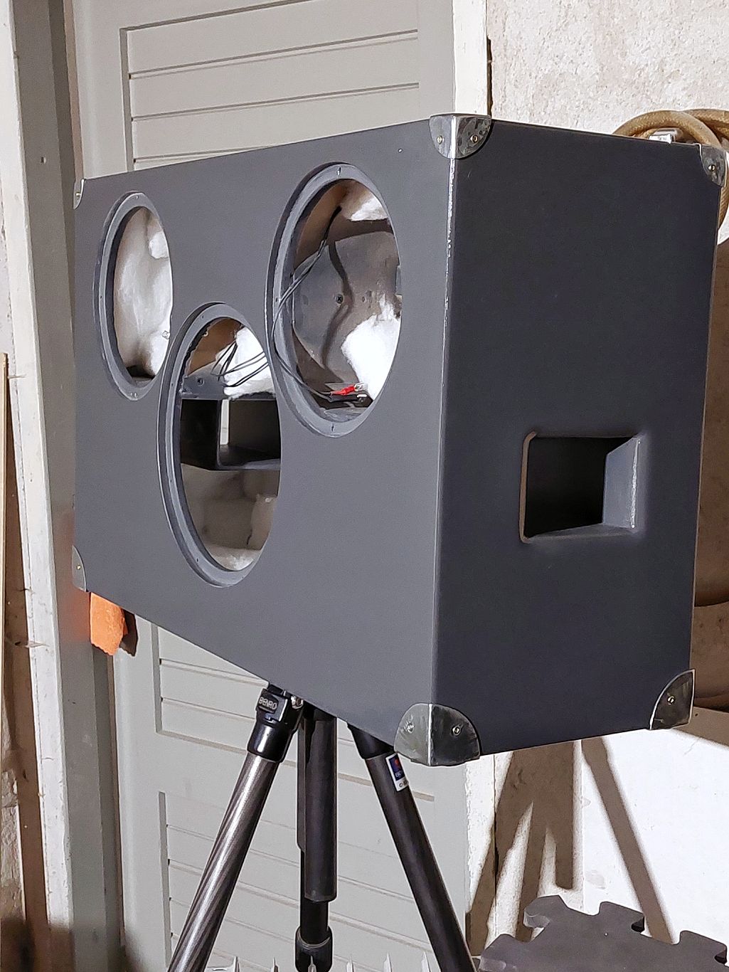

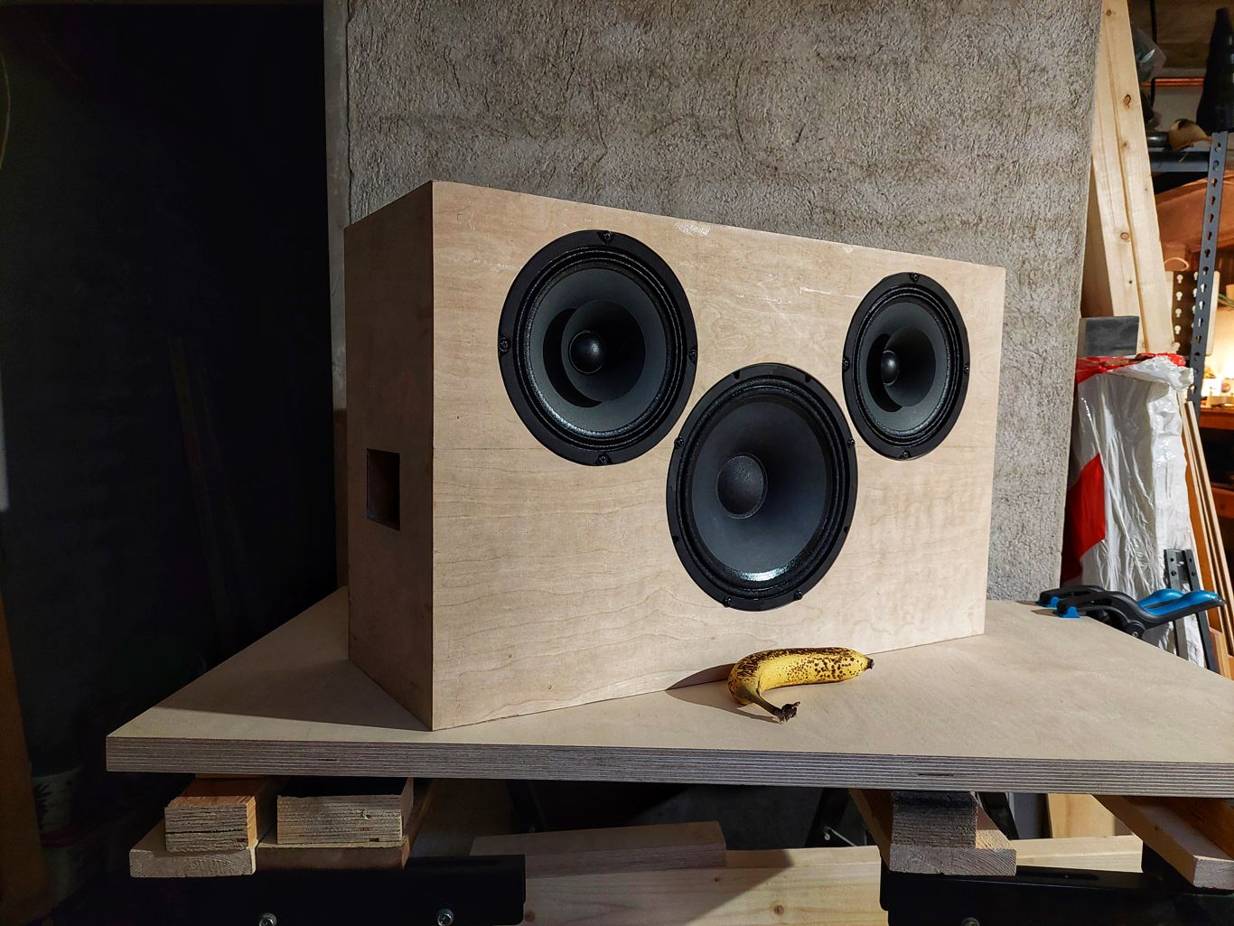

The 95% finished speaker, grills are temporarily attached because I didn't get all the parts when I ordered the smaller grills due to my mistake.
2x 8" Sica 8 D 1,5 CS full range speakers in ~10l closed compartments

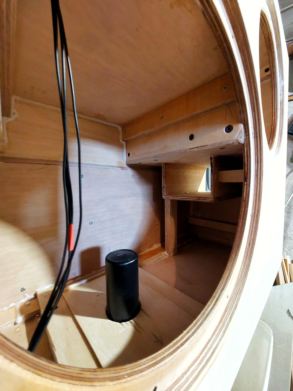

B&C Speakers 10CL51 10" woofer in ~32l ported enclosure, calculated tuning frequency of 65Hz
JAB4 amplifier, 30W for the tops, 60W for the bass.
307Wh battery with selectable 12-24V

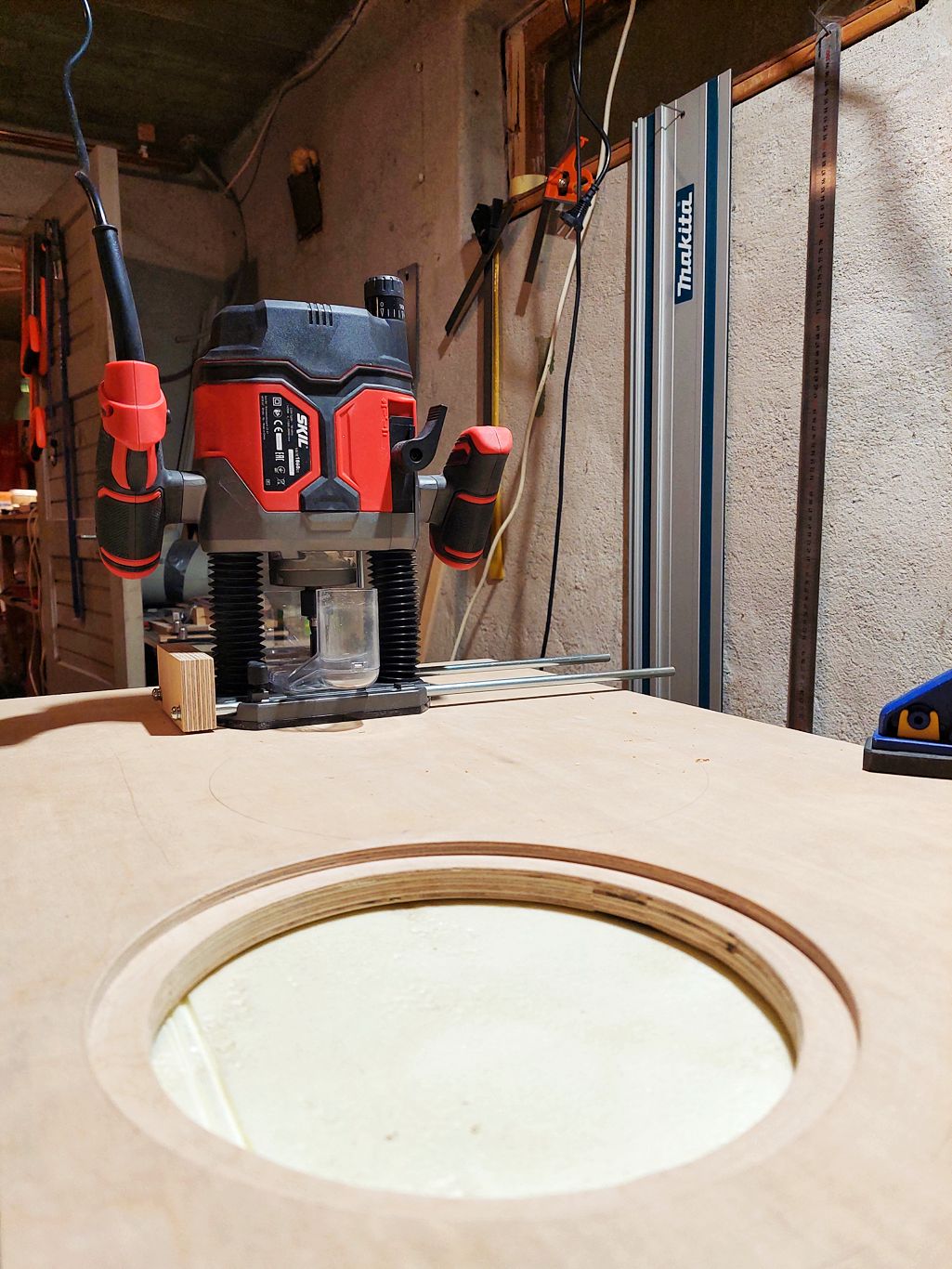

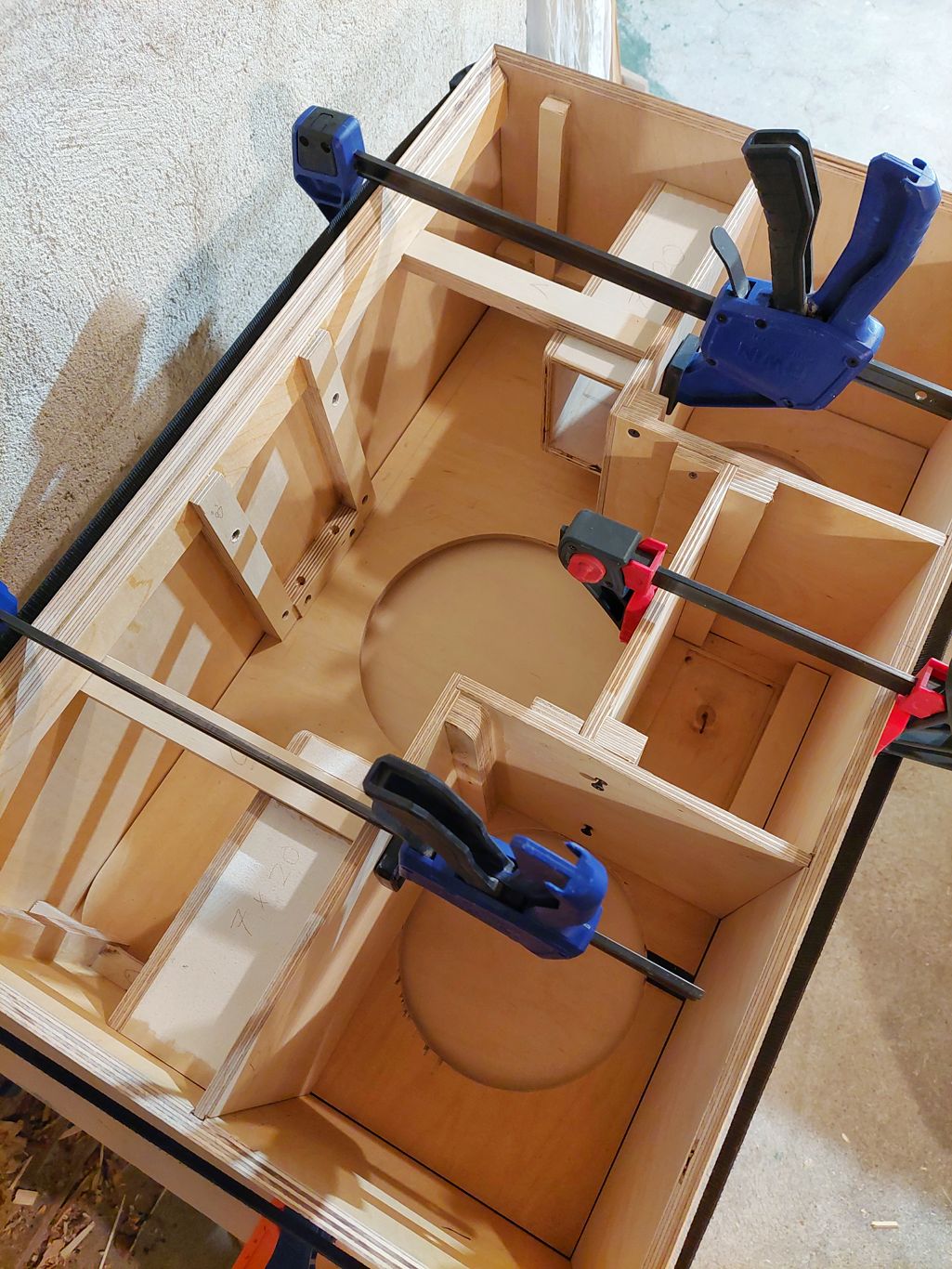

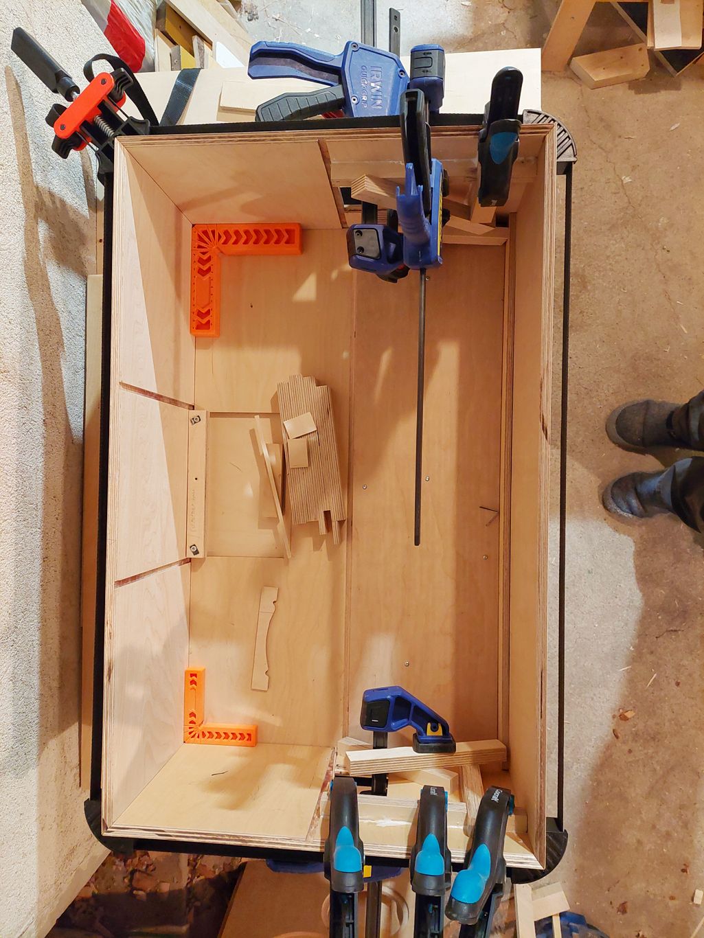

Due to weight constraints the enclosure is made from 9mm baltic birch plywood, front baffle and back of the bass enclosure has 2 layers. Supports are mostly from 20mm thick plywood strips, a lot of them have half lap style cut outs and/or grooves routed to the walls/parts to make it as sturdy as possible.
When you see the router as a spanking robot, you can't unsee it.
Front baffle miters and 2nd layer that fits inside the outer walls for more glue surface and stiffening.

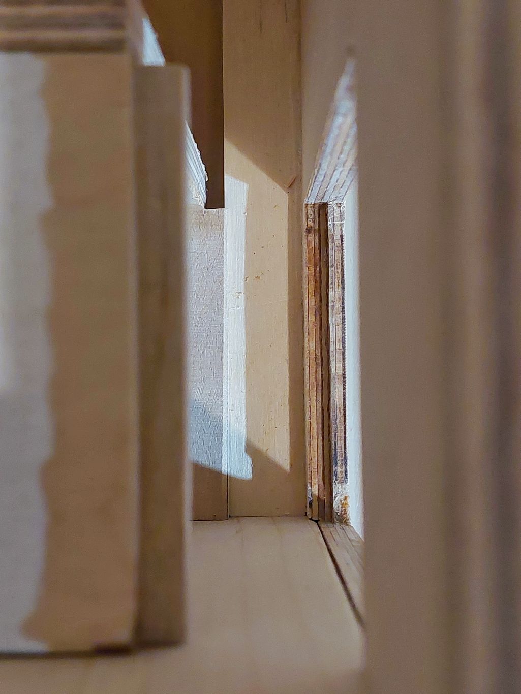

On the left side, top and bottom of the enclosure, there are grooves for the closed compartment walls to slide into. Tight fit, had to hammer them in gently after a few rounds of fine tuning.

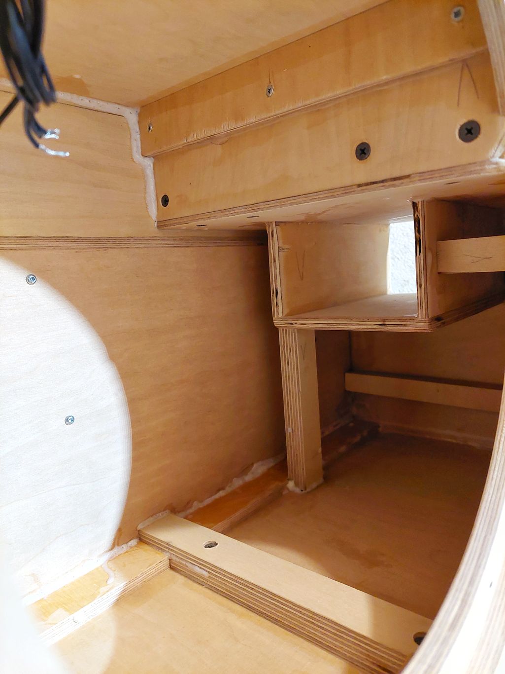

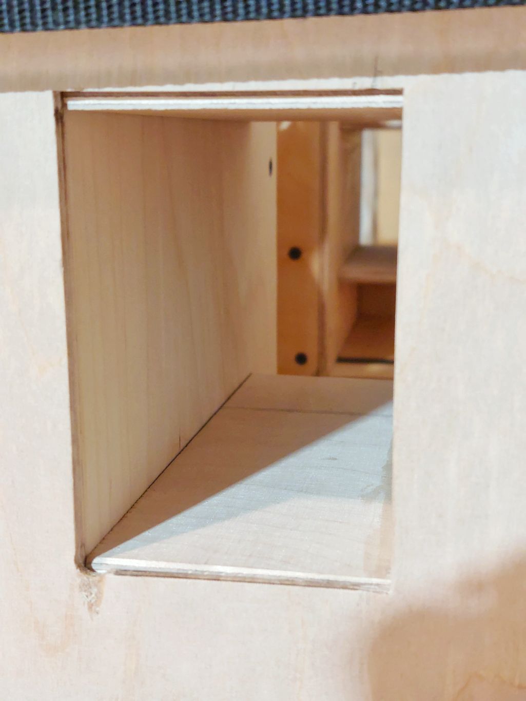

Better view of the routed groove and support structure for the ports being glued.

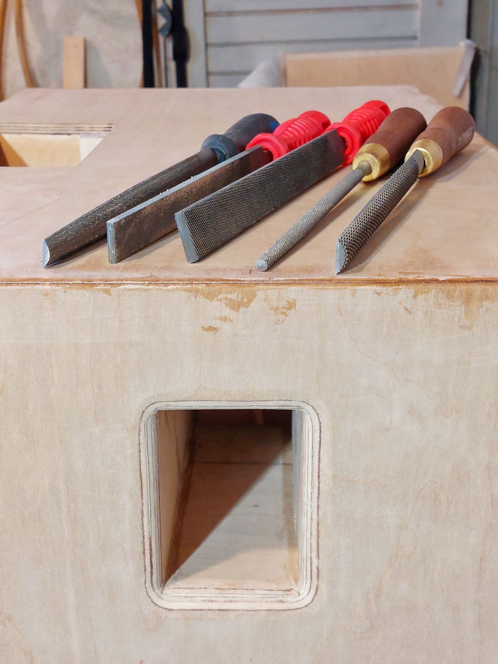

support grooves/rabets for the ports, which also work as carrying handles
Top view of the port connection structure
Better view of the layout

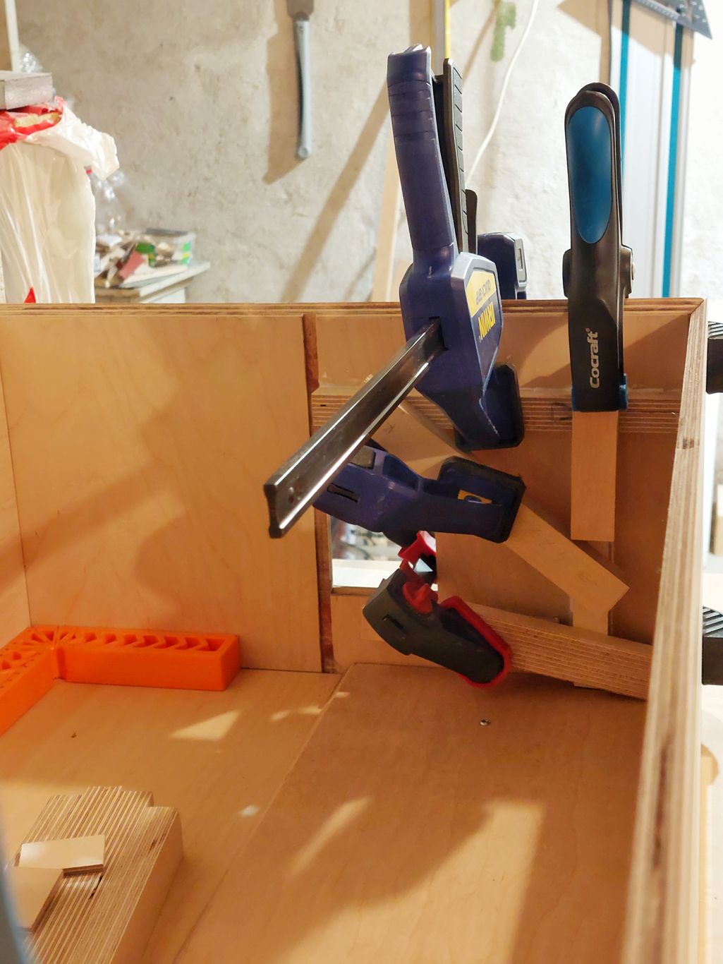

Had to use some screws during glue up to line the parts exactly.
The main glue up required some creativity to get the whole thing warm enough for the glue to dry, my basement workshop is pretty cold.
First testing before finishing touches. Banana for scale.

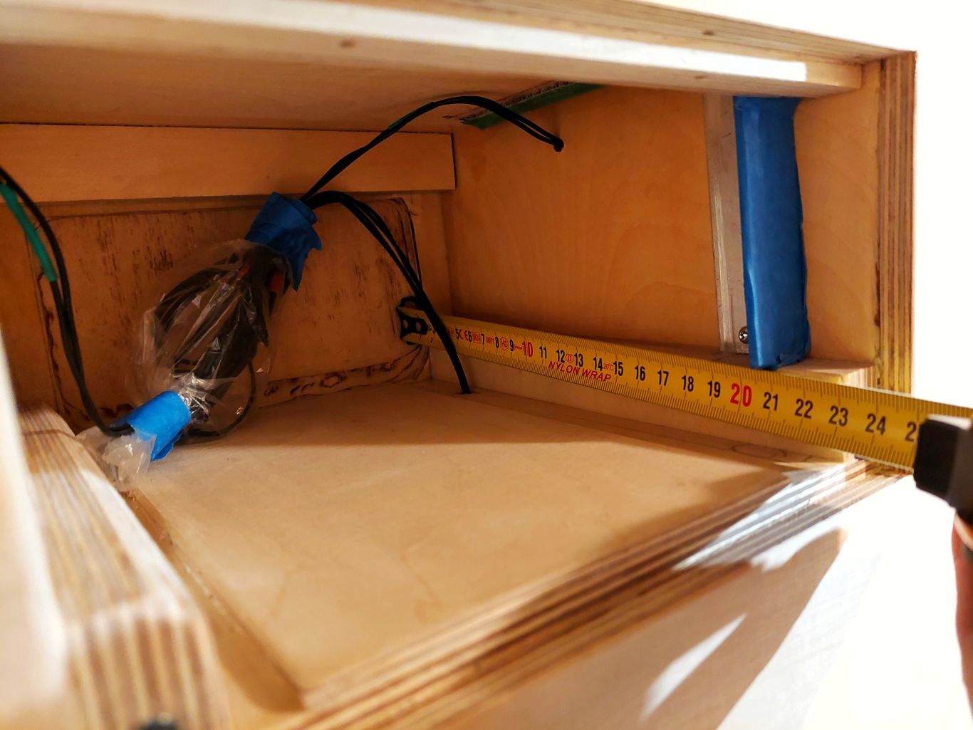

Battery and amplifier slot. I managed to measure this wrong, not twice but three times. Had to carve more room with a Dremel to get enough depth and make everything fit. The door has a piano hinge and magnets, which I don't have photos, the door closes with a satisfying click.

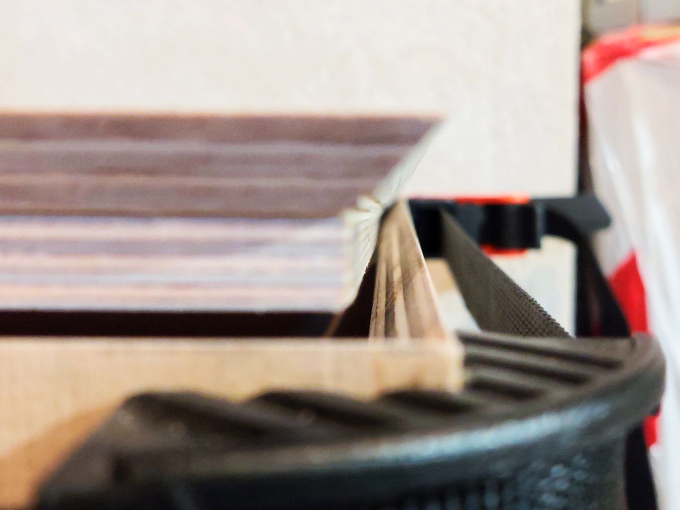

Rounding the port/handles before painting.

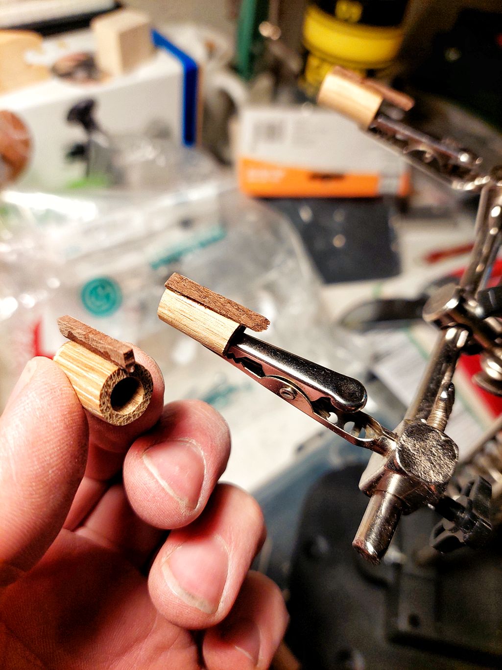

I made potentiometer hats for the amp from red oak and merbau

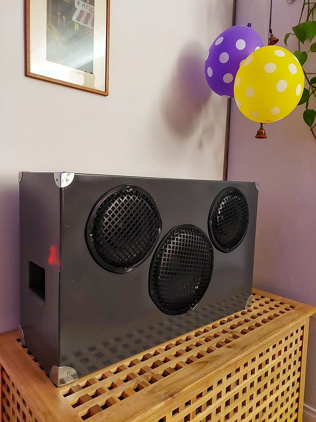

After painting and lacquer just before attaching the elements.

Some minor flaws here and there but I'm mostly happy how this turned out. This doesn't sound like an off the shelf bluetooth boombox, this sounds and feels like a small PA top. I didn't do any measurements (yet) but from the feedback I got from my group of friends who participated on the first outdoor pressure test, everyone was surprised how punchy, physical and fat but not bloated the speaker sounds. The group has combined experience of 200+ years of party organizing, djing and pro audio and aren't afraid to point out any flaws. Needs some taming on 500-3000Hz range, a bit shouty before any eq with just digital crossover. The bass enclosure tuning is very close to the VituixCAD simulated/ calculated ~65Hz. When I tried this in my acoustically treated listening room and put it in a spot that wakes a 63-65Hz room mode, my attic hatch in the ceiling started to rattle with the bass. Can't turn the amplifier to half volume or something starts to rattle.
One guy who has a lot more experience on building speakers was suspicious when I told him it is made mostly from 9mm plywood and weights just shy of 25kg, I asked him to knock around the enclosure and he just started to laugh and kept knocking, it is surprisingly stiff and only slightly vibrates when playing as loud as the amp can handle.
