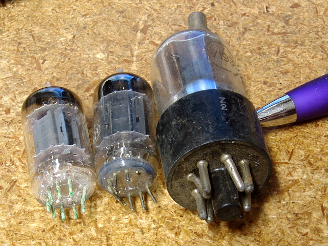

Here's some photos of where I am now.
1. very old 6AV5s test mules of uncertain provenance (was gonna say parentage, but it was Sylvania what birthed 'em; ALL my 6AV5s are Sylvania...) GLOWING at 25 watts dissipation: 380V plate, 61V cathode across 780 ohms, 78 mA x 319V = 24.95 W
After a few hours at this op point, these old horses just started spitting & DIED.

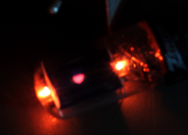

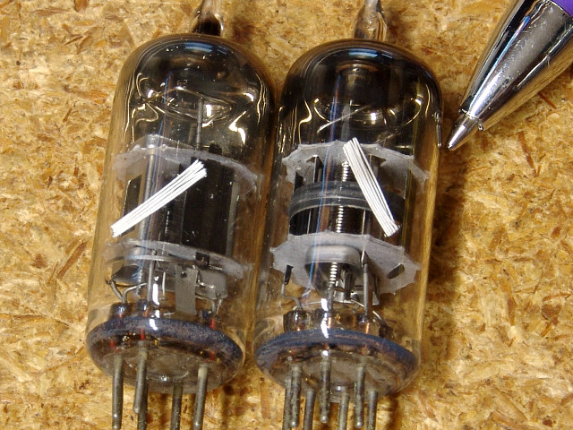

Red Plate at Night, TubeLab's Delight
The Red Plate Tube was one one of a pair of ancient test mules running (at that time) at ~25 Watts, AFTER seeing abuse in the high 20-something-watt range over the years.
Indeed, these tubes ground to a halt about an hour after the Red Glow, and were replaced with a fresh pair. This is the first set of 6AV7s that I've actually destroyed, so I figure they donated their little Bottle Bodies to science.
Based on George's earlier observations, it appears that the tell-tale warning sign is the concentration of the glow, rather than an even distribution across the plate. Don't know the mechanism of failure, but from the sound of it, the plates warped into/too close to the grid or screen. Perhaps annealing and consequential loss of strength? or maybe just plain ol' MELTING.
I didn't toss them; considering a TubeLab-style autopsy, if I can find a hammer bigenough and a place to stand...
I usually put the tube inside a thick paper bag with the end rolled shut, place that on a hard surface then tap the tube gently with the round end of a small ball peen hammer, or give the glass end a little squeeze in a vise. Those tubes have a big empty space at the top, hit or squeeze that area to avoid damaging the guts. I then cut the tops off the plate tabs and grid rods where necessary to slide the top mica off. Then you can cut through the plate tabs at the bottom where the wires are attached and slide the plate off. If the tube just suddenly stopped working, the usual failure is a warped screen grid touching a beam forming plate or the control grid, or a tube arc taking out the little strap that connects the cathode to the base pin. Continued operation in the red zone usually leads to vacuum contamination causing grid current leading to a runaway condition.

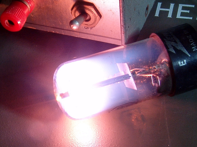

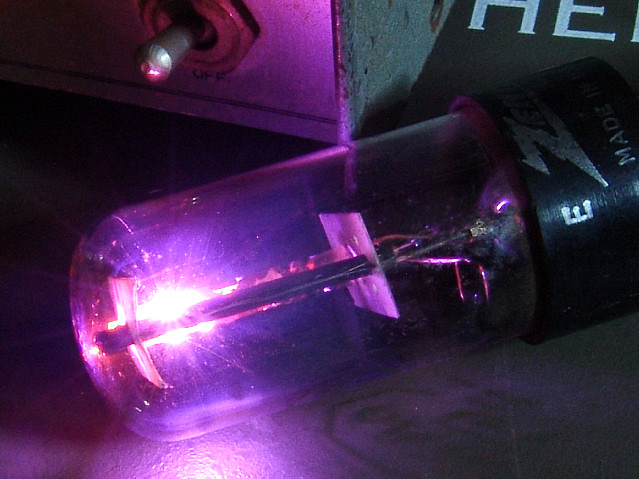

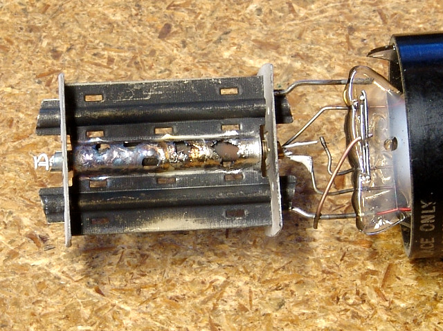

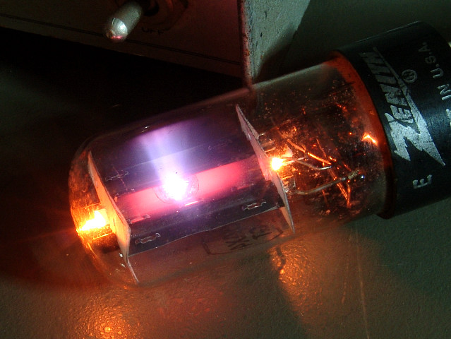

It's pretty hard to melt a plate, even if that's what you are trying to do. Usually the glass will melt, crack or shatter first.

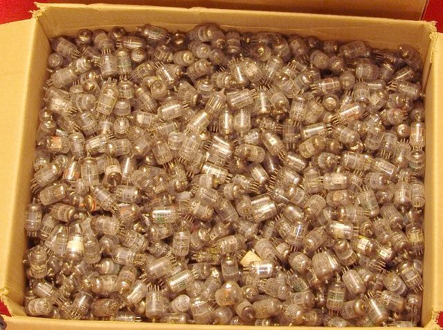

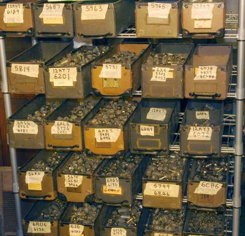

When someone gives you over 100,000 used 50 year+ old tubes that were all stored in an abandoned and vandalized warehouse in the Florida heat, rain and humidity, you have a lot of "test subjects." Nearly 1/3 of the tubes were broken. It's a sad site to find the remains of maybe a hundred transmitting triodes like 211's and 845's that had been thrown against the concrete to break them. It looked like multiple paintball style battles had been staged with tubes as the projectiles. That stuff all went into the dumpster on site. As did most of the corroded and mangled tubes. The rest were transported 200 miles to my warehouse where I began to spend nearly 5 years sorting them all.
First you find and toss all the really nasty and useless tubes that are still mixed in to boxes and drums full of tubes. Then you sort the big boxes full of randomly mixed tubes by size. Then you sort them by type number. In the process you find some gems like the WE417A's and 5842's. But you also find some strange stuff. What are the odds of finding a tube with a spare heater stuffed inside the glass? What are the odds of finding TWO of them with the same type number?
I also found a damper tube with a hole burned through the plate. Even so the tube tester said it was good, so I decided to perform further testing to see if it really worked......it did, and met the specs for current handling and voltage drop. Now, I didn't want to ever use this tube in something, or let it get mixed in with the stuff I kept, so I decided to "test" it a little more.
I already had it connected up to a small power supply to run the heater, and a bigger power supply to feed the plate. The first picture is a bit out of focus, but clearly shows the hot cathode through the hole in the plate with no plate current. The tube is a 6AX4, rated for 165 mA of continuous plate current.
I kept cranking up the current until things got interesting. Of course the plate got red when I was somewhere over half an amp of plate current. A neat blue ray started to appear at nearly 1 amp. I cranked it up to 1 amp where the blue got pretty intense and grew into a plasma that enveloped the top half of the tube. I let it run at this level for over a minute expecting the plate or the glass to melt, but the tube started arcing, and the glass cracked letting air inside and killing the show. The autopsy revealed several new holes in the plate, and flying bits of metal likely caused the crack which can be seen across the top of the tube in the last picture.
