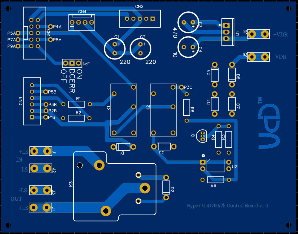

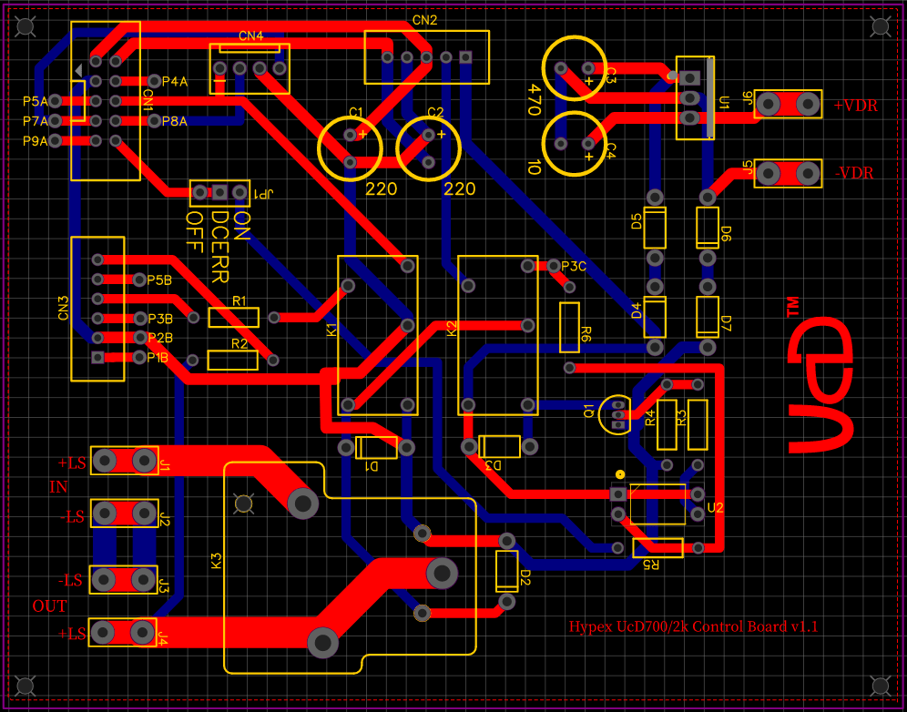

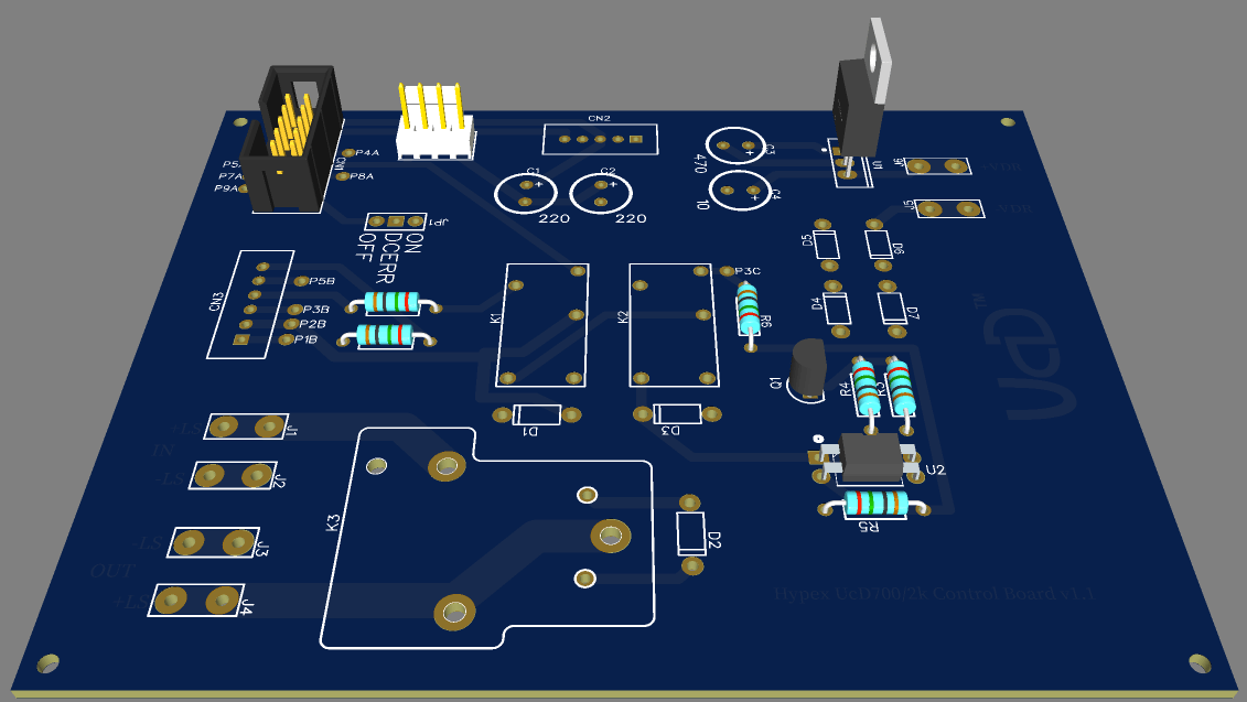

I've ended up designing my own UcD700/2k control board to simplify the Samson amp conversion, though the board should work for other old amps as well.
The board is made to provide easy connections hookup through JST-XH headers, plus speaker protection in the event of a module DC-Protect/Error detection as this is mainly designed to use with linear power supply(s) rather than the recommended Hypex switching power supply.
Also since most old class a/b amplifiers already comes with split(+/-) voltages for both HV for the output and LV for the signal, the control board will include a simple VDR circuit to provide the +15V through a 1% precision TL780-15x regulator per module.
The simple protection circuit consist of an SFH617A-4 optocoupler and a 2N3904 transistor to activate/latch a relay that will disable the speaker and the module on/off relays, and will remains latched until a power cycle.
I've simulated the protection circuit functionality on LTspice with good results, though I will order the PCB's from EasyEDA to test the board functionality before ordering the UcD700HG amp modules from Hypex/DIYclassd just to be sure.
The pinouts are as follow:
CN1 (Connect to UcD700/2k J10)
Referenced to the UcD700/2k J10 header.
CN2 (LV power input header)
1) +24v for the onboard Vdr regulator and protection circuit
2) +24v (time delay) for the K1/K3 relays
3) +VSIG
4) GND
5) -VSIG
CN3 (Utility header)
1) NC
2) GND
3) NC
4) Protection monitor/led
5) NC
6) AF signal monitor
CN4 (Alt header)
Alternative input signal and on/off control
JP1 (Protection circuit enable/disable)
1-2 enables the protection circuit
2-3 disables the protection circuit
Here is the proto UcD700/2k control board preview:
Regards!
