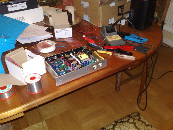

Hi all,
I have just finished an ultra compact amp with Hypex modules.
The amp consists of 2 UCD400 amps and one SMPS400.
Pity is, I bought everything at the same time at HiFi kit here in Sweden, thinking the parts would be compatible.
However the SMPS puts out about 70Vdc at my nominal line voltage which is 239Vac tripping the OVP on the amps.
It seems the on board caps and power FETs can handle the 75V limit the higher serial numbers have.
Is there a quick fix I can do ,without risking the modules, to set the OVP to 75V nominal.
Also I would like Hypex to include in the SMPS datasheet the maximum external cap the supply can handle
without the current limit inception to kick in making the startup ramp non monotonic.
I added 4x4700uF and it restarts at least once.
Regards / Mattias

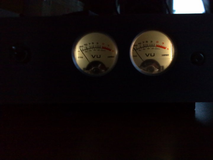

The cases looks good. I looked in to computer cases too.
Mine was an old modem. Just made the panels.
Rgds/ Mattias
Rgds/ Mattias
Someone at Hypex told me that the "old" modules can be adapted with changing 2 components on the module.
