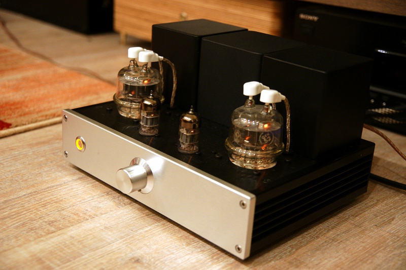

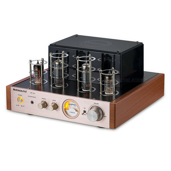

yes this is a fake tube amplifier - there are no output transformers - just empty decorative cover. SS amplifier with tubes.
Exposure of fake Chinese tube amplifier Nobsound MS-10D MKII. - Stereo Amplifiers & Pre-Amps - StereoNET
but I have seen that a real DIY tube amplifier is built into this chassis
I was hoping to use the chassis for a "REAL" tube amplifier.
I knew it was a fake when I bought it hence the cheap price I paid ( £10 )

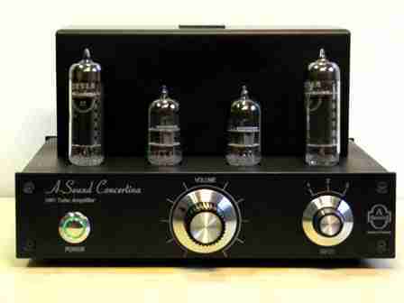

Original A Sound Concertina consist of two indel PP 20W 10K output transformers on top and one indel toroid for B+ and heaters at the bottom. Output was about 2x7W if i remember correctly....Their web page is down ...

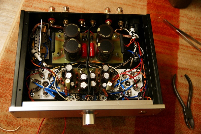

In similar size enclosure i mounted PP gu32 amplifier - yes little space ( i hate small enclosures 😀 ) but indel 20 W PP transformers + power transformer fit there.
