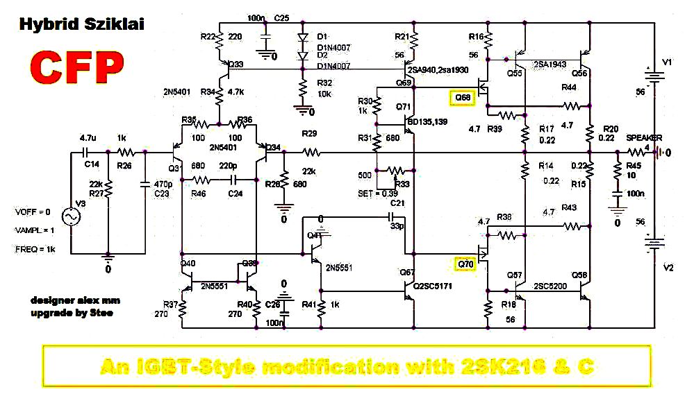

my job here is cut and paste schematic 😀
so the last Thesis is improve accuracy on Output Stage
CFP configuration increase speed
( the contrast on your audio-image )
Hybrid driver ( Mosfet ) increase accuracy
because decrease load on VAS
( the brightness )
how to say?
it may be true 🙂
