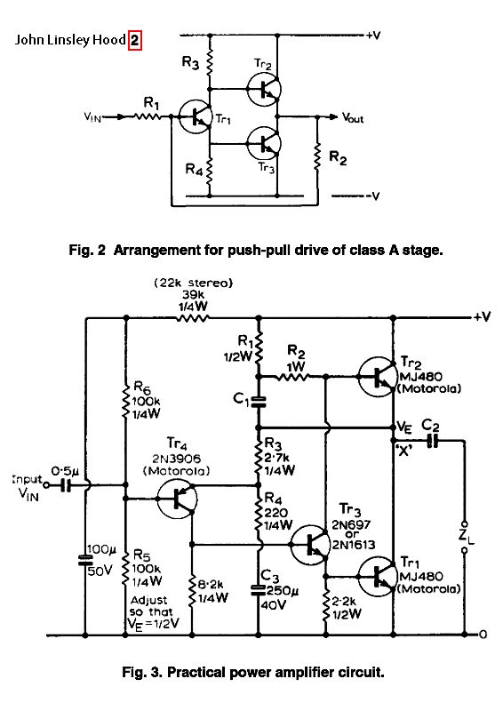

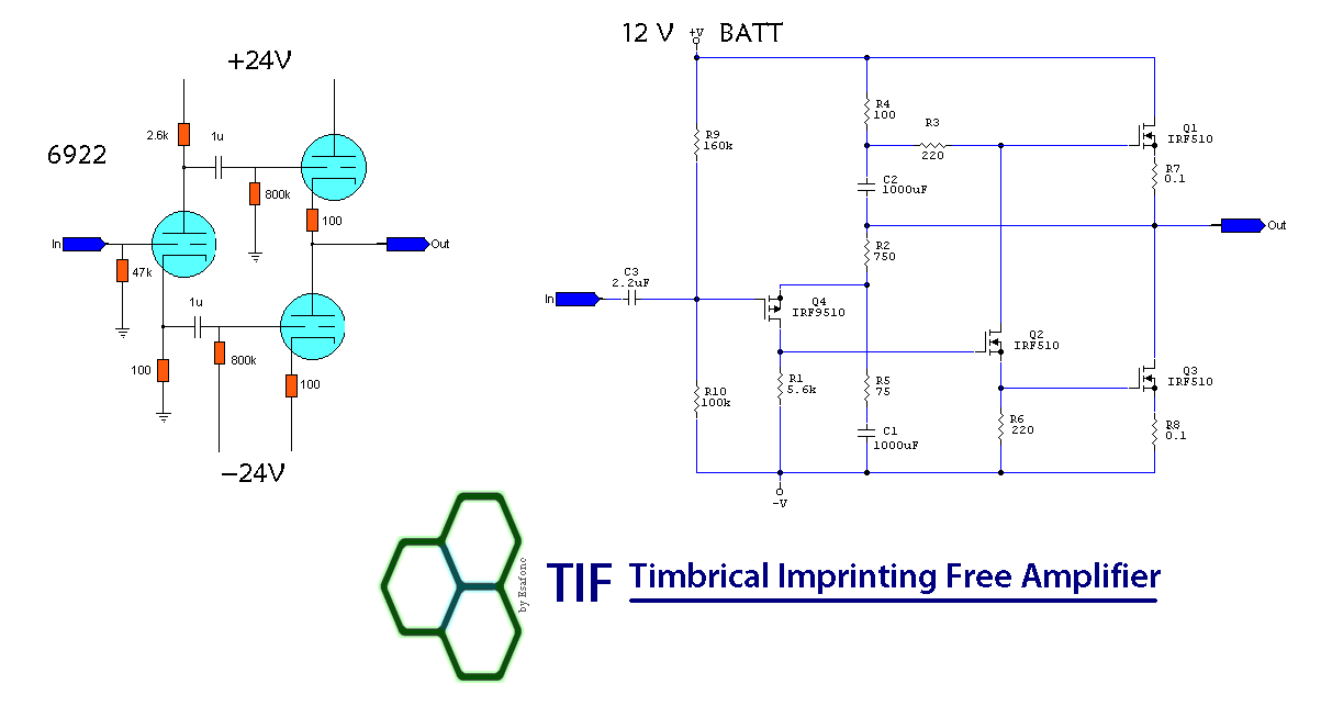

Hybrid amp Futterman's style (sepp)
to have a pure gain
you need the same devices...
see schematic🙂

" Stee
interesting comment Stee. Maybe dissimilar parts 'poison' each other.
I like that term 'imprint'.
Have you noticed that none of the assumed gain equations for true Sziklai CFP circuits measure correct in reality?
So I'll try your circuit (with my mods) in hybrid output section.
