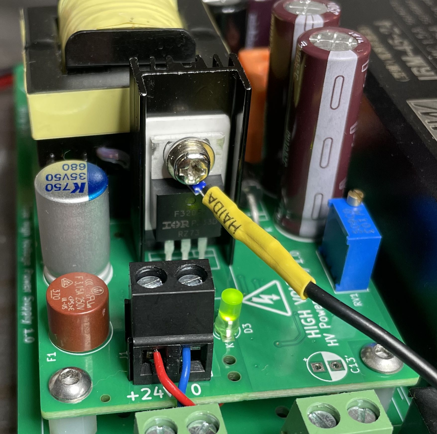

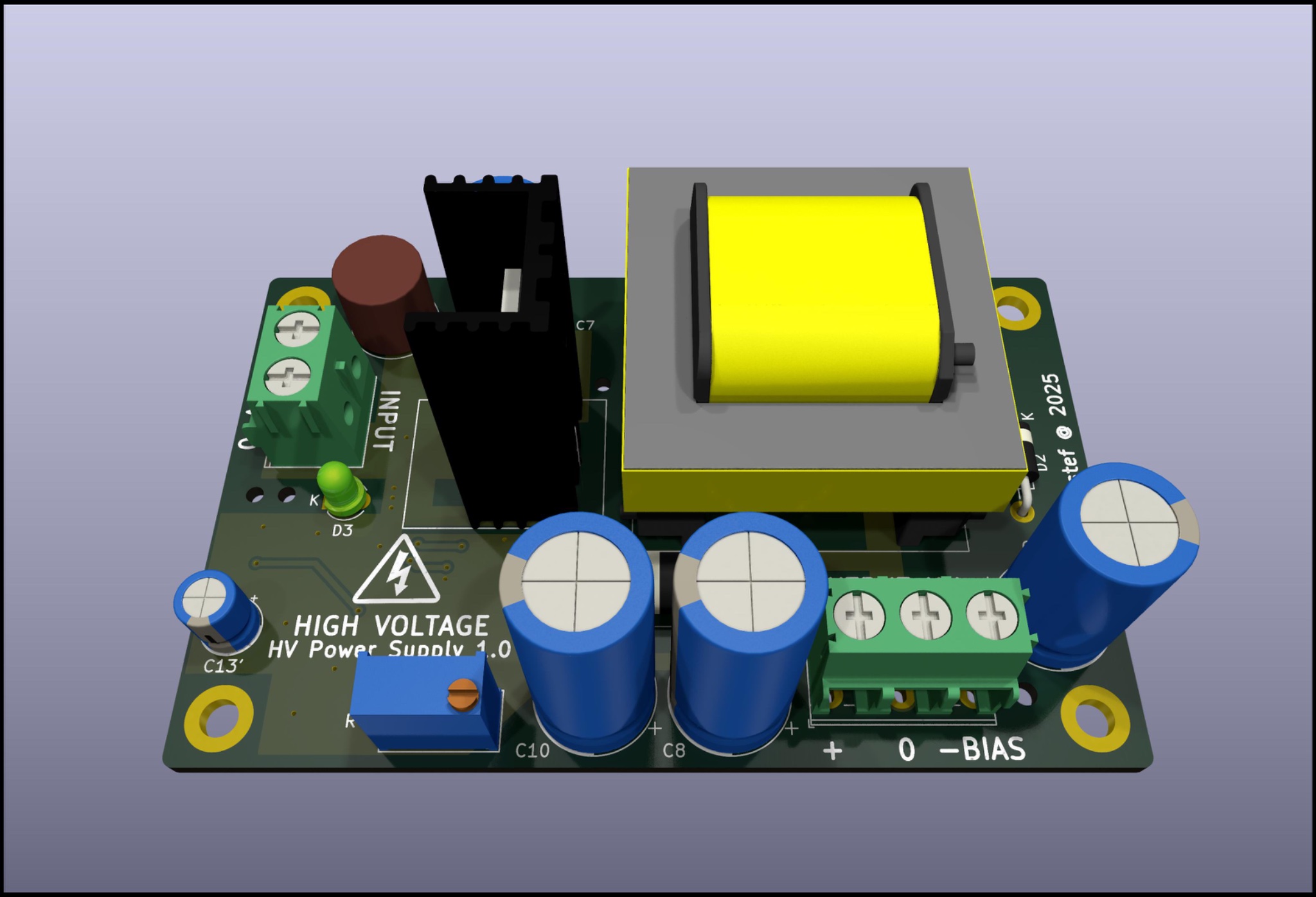

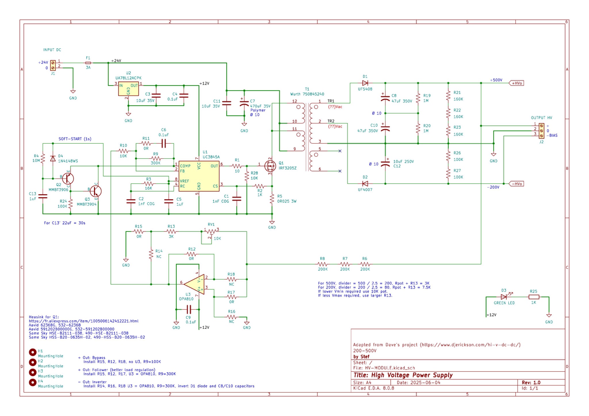

Hello,
I've developed a small high-voltage DC-DC power supply working up to 500V. This board was developed to power high-power audio tubes such as the 300B, 2A3, or others power tubes.
There is a second negative output that can be used to generate the voltage required for a circuit using negative BIAS.
This can replace the traditional solution based on transformer and classic filtering.
You can check out my Github repository here: https://github.com/stefaweb/audio-psu/tree/main/HV-MODULE-UC3845-1.0
The manufacturing files are available on my Github repository in the file PCB-Board-production-1.0.zip.
For those who would like to build the board, you can find the Gerber files in the directory, as well as the BOM and position files, allowing you to manufacture the PCB assembly and SMD components directly at JLPC or another company that offers the same service.
You also have the complete circuit simulation in LTSpice, which can also be downloaded from the Github repository.
In addition to this board, I developed a second PCB that allows this power supply to be powered by a Meanwell IRM-45-24 switching power supply. This board also adds an external CRC filter for high-frequency filtering and improved ripple, a circuit to adjust the negative BIAS voltage and an external 12V power supply to connect accessories.
The files are available here: https://github.com/stefaweb/audio-psu/tree/main/TUBE-HV-PSU-45W-1.0
Enjoy!
Stef.
The characteristics are as follows:
Input: 24V
Positive Output: +180V to +500V
Negative Output: -80V to -200V (no load, only for tube BIAS)
Overcurrent protection
Overtemperature protection
Softstart (1 second by default but more by adding high value capacitor in C13')
3A fuse protection
Possibility to generate a negative voltage on the main output by modifying a few components (inverter mode).

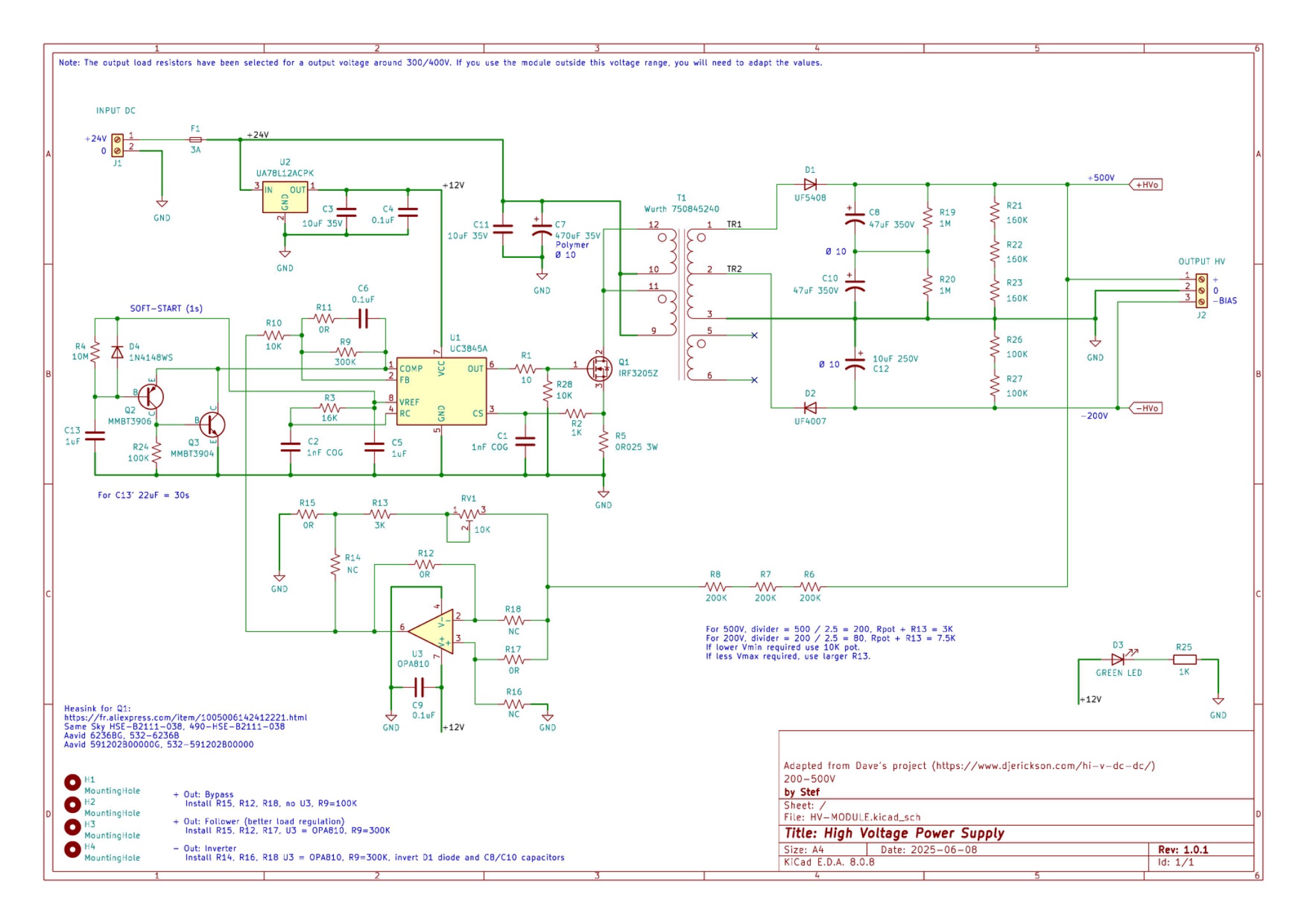

How about you put the soft start at the 24v input with a mosfet to turn the circuit on and off. with a delay.
Or at the ic supply pin, so the mosfet won't have to run high currents.

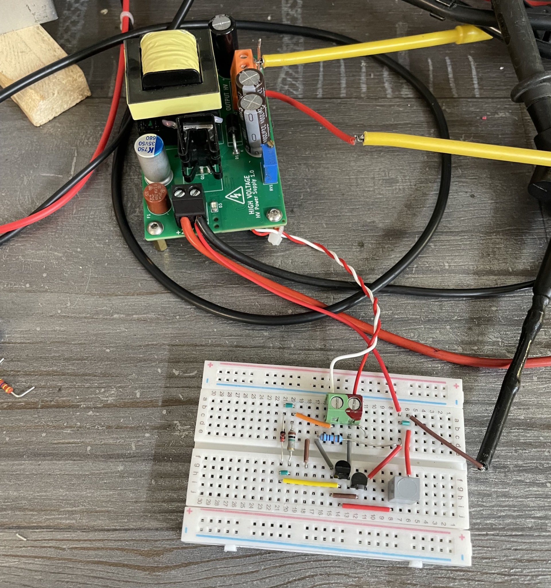

Hello,

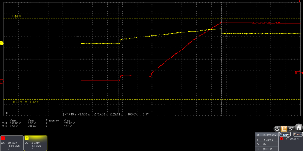

I finally found the problem. It was really simple. I was testing the board with a load of only 1mA. The minimum for regulation to work. If I increase the load, for example, to 60mA at 350V, the softstart works.
However, I'm currently adjusting the softstart to have a longer delay (between 1 second and 1 minute). To do this, I increased resistor R4 to 10MΩ and added a footprint for a capacitor on the top of the PCB. I left the 1uF SMD C13 below as base value. It will be enough to add a capacitor above the chosen value depending on the desired softstart duration.

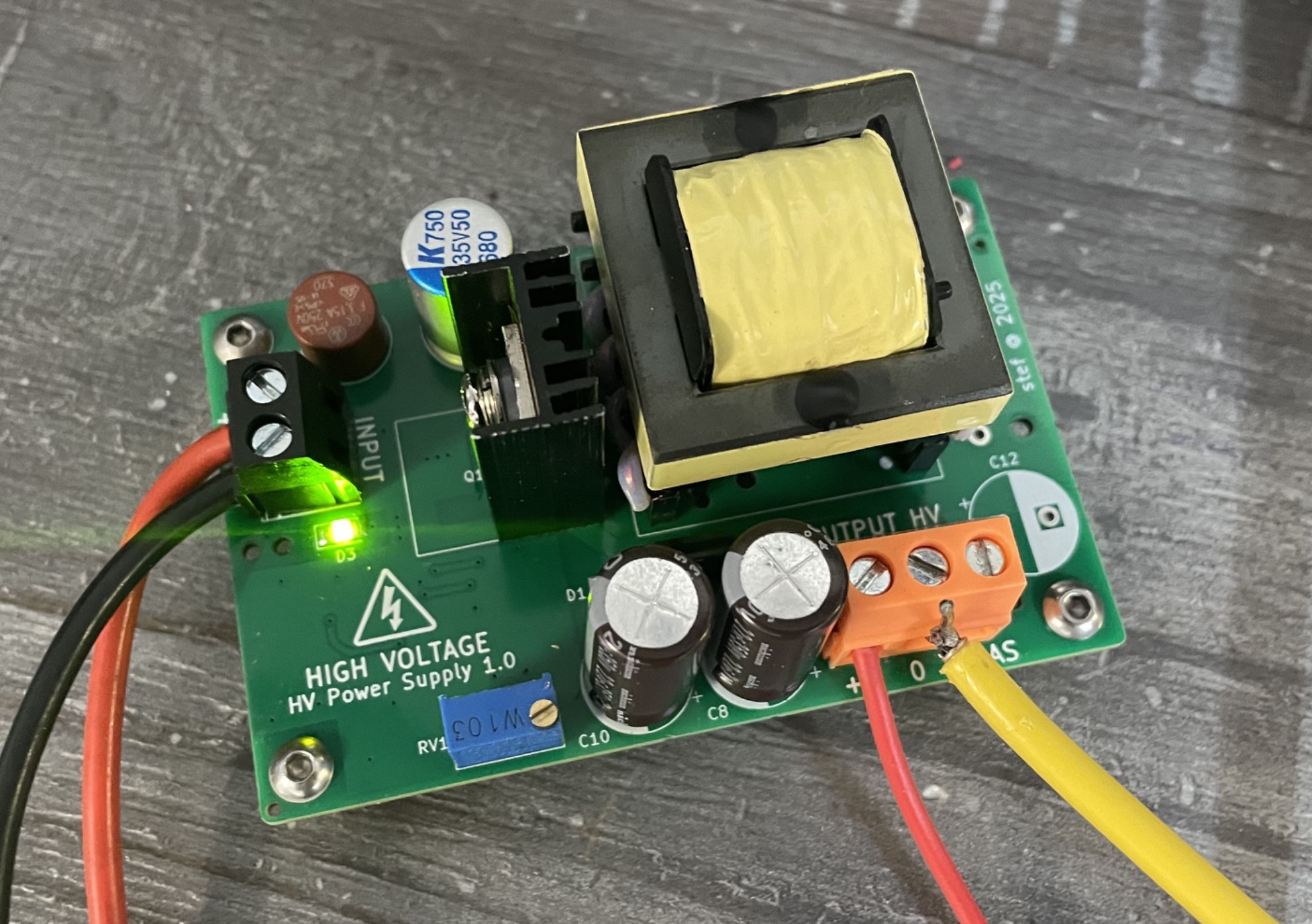

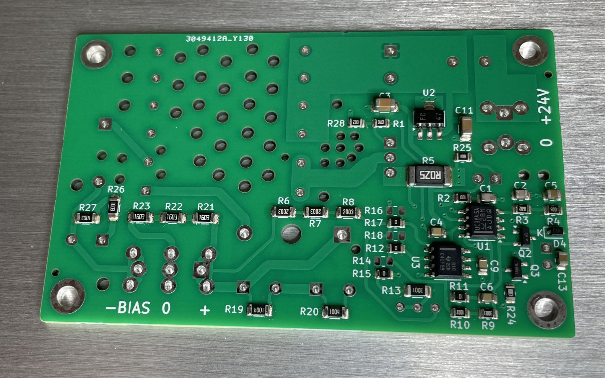

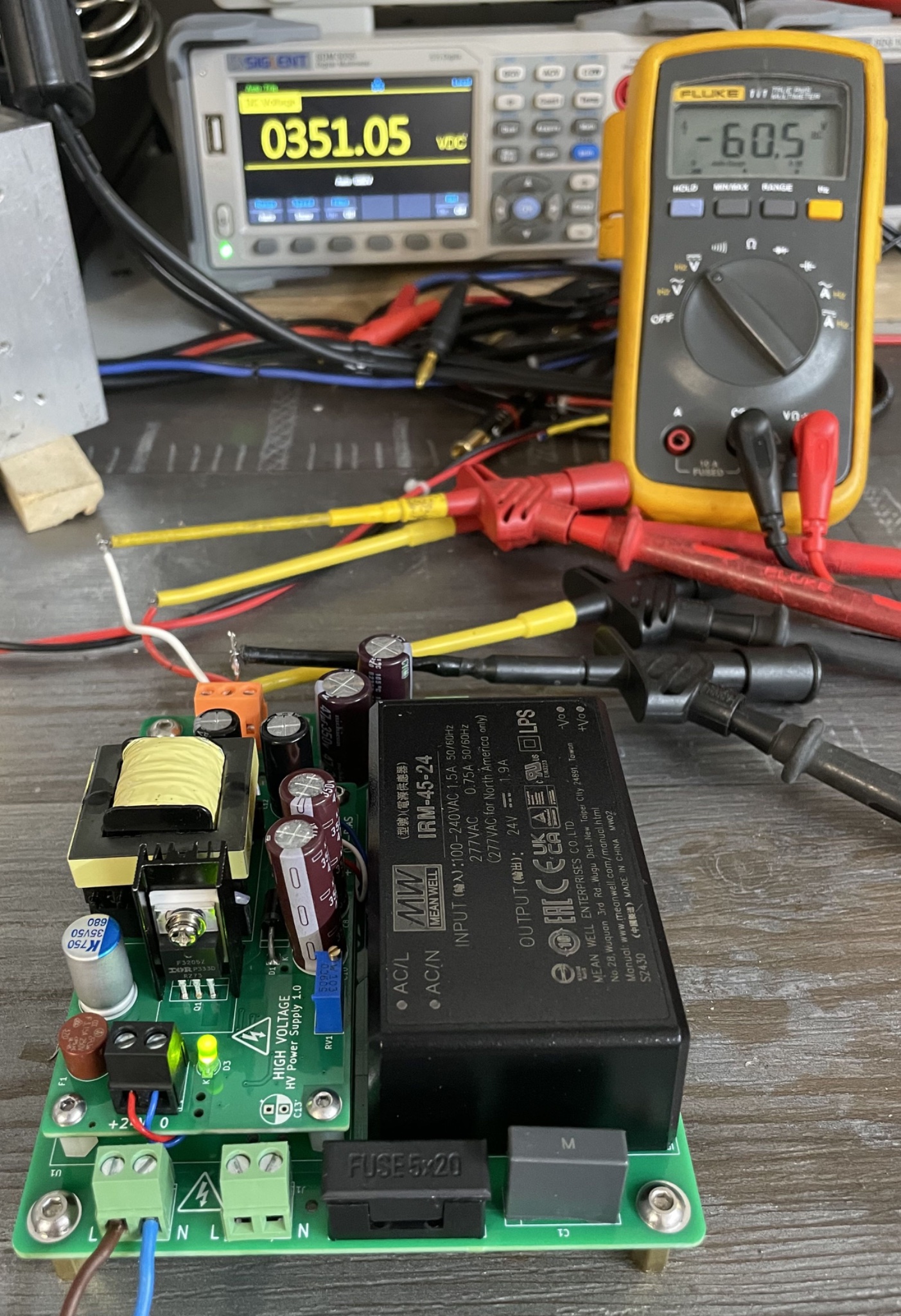

The complete power supply board.
Ripple at 350V 60mA: 45mV hot (85mV cold)
The voltage fluctuates between hot and cold by only 0.3V (thanks to the OPA810)
With the BIAS set to -60V.
Stef.
Stef.

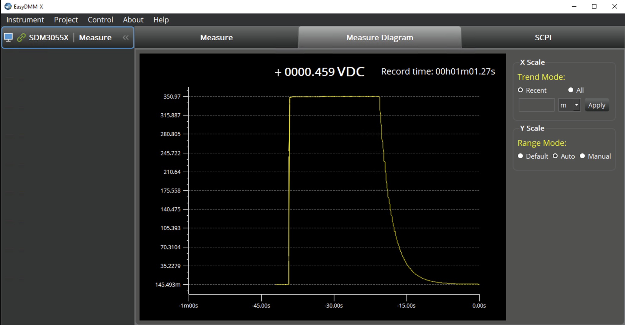

Verify that the VCC voltage reaches the required startup threshold for the UC3845B. It is typically around 16V. If the VCC doesn't reach this threshold, the controller won't start, and the soft-start mechanism won't engage.

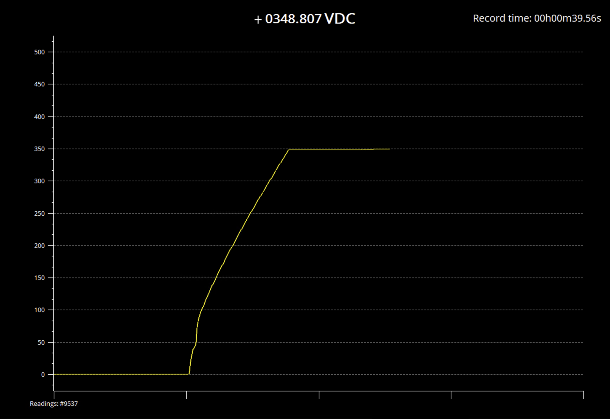

The problem was that at least 3mA of output load is required for the softstart to start the PWM. My first tests were with 1mA (the resistors included on the board by default). The threshold is 2.3V on the COMP pin.
The softstart works very well now. I have a slow gradual increase in output voltage. With 1uF, we have 1.5-second delay. With 22uF, we have a 30-second delay. With 100uF, we have 2 minutes.
Stef.

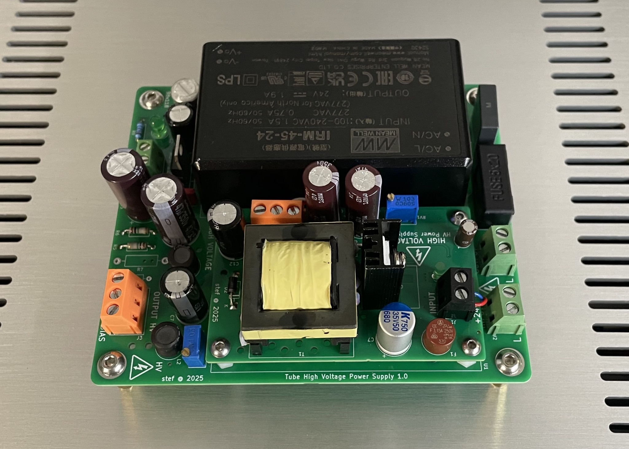

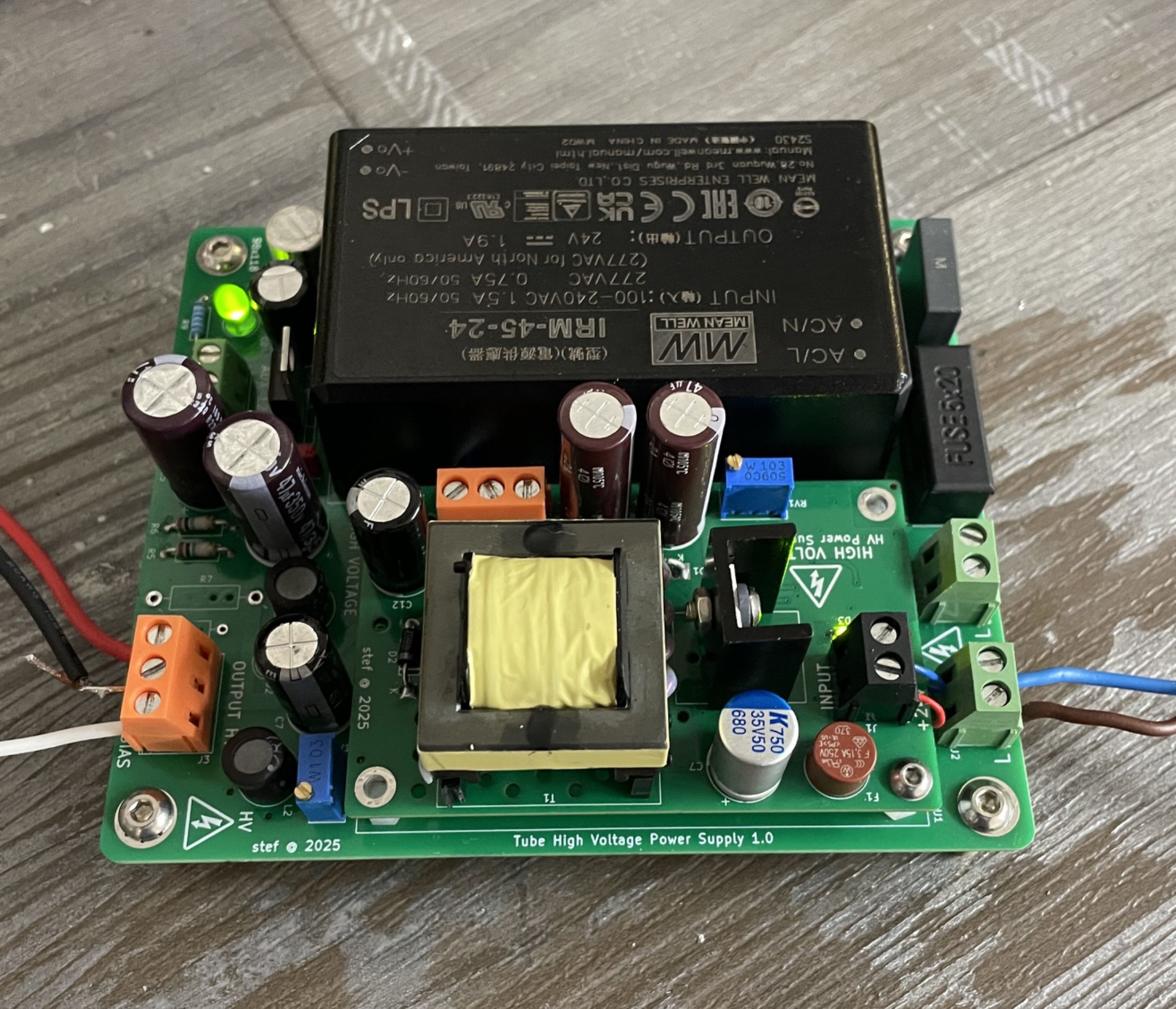

Hello,

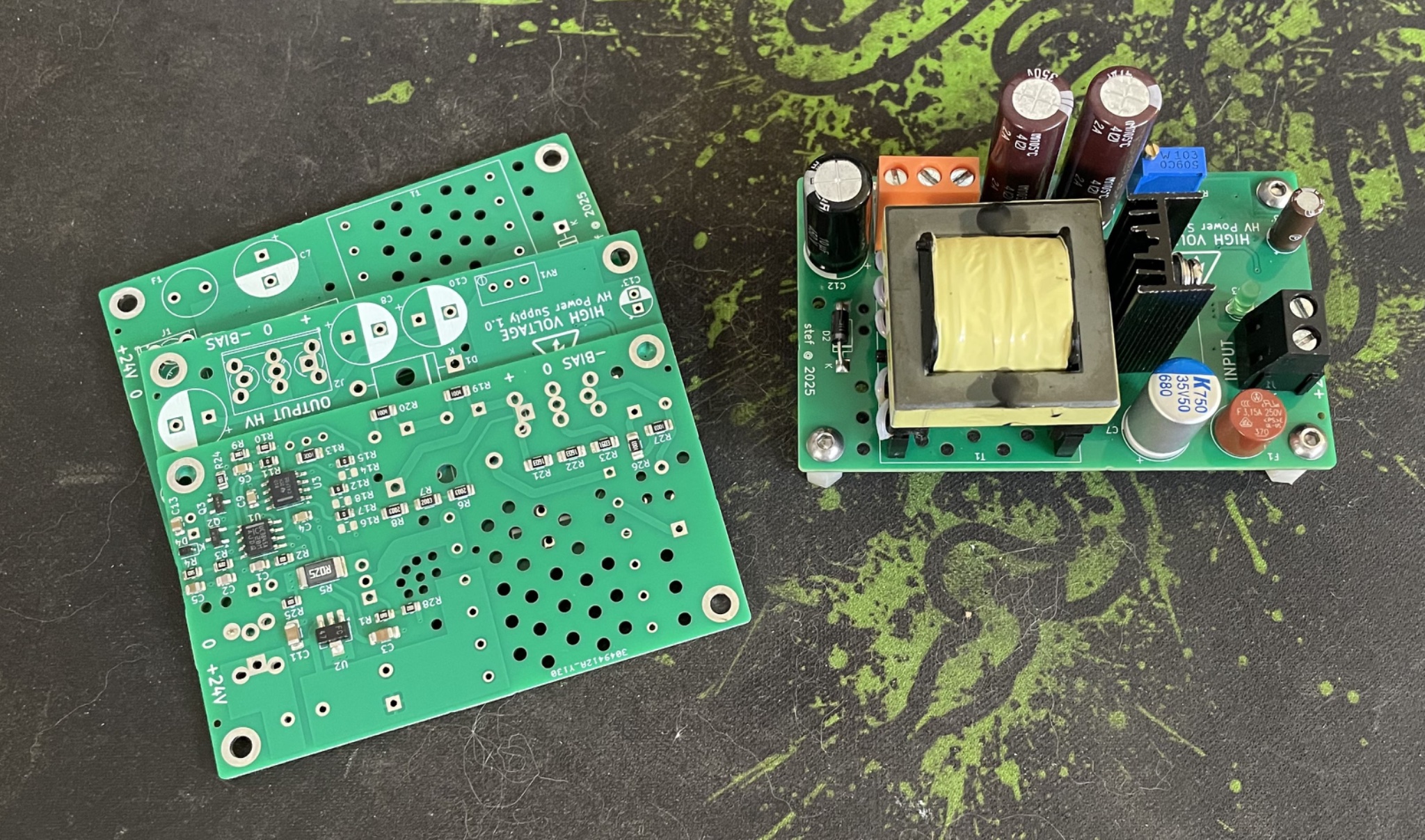

I received the production version of the HV power supply as well as the PCB for the main power supply motherboard.
Everything is working as expected.
I should upload the files on my GitHub repository by tomorrow. The files include the BOM and placement files to have the PCB manufactured directly at JLCPB with the SMD components already soldered.
For those who live in the European Union, I have some spare PCBs at cost price. I do not ship outside the EU because shipping will be too expensive.

Hi Jan,

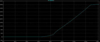

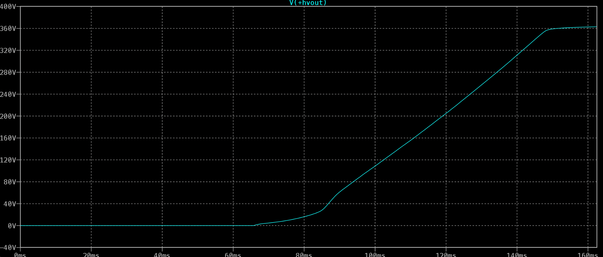

This also works as a solution, at least with LTSpice. So that makes two ways to achieve a long softstart (C13 or R24). I'm keeping the C13 version, however, because it's easier to change the TH C13 capacitor on top of the PCB than to solder an SMD resistor.
I'll try it for real on the old prototype when I have some time.
Thanks.
Stef.

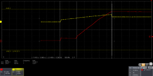

C13=1uF, R24=1K, R3=1M
The slope looks gentler than just with the C13 solution. Maybe a mix of 2 solutions would be even better.
Thanks.
Stef.
I understand perfectly, but I have other urgent matters at the moment. I'm working on a stereo solid-state driver board for power tubes like the 300B or 2A3 (to replace the input tubes).
The 1K test was just to see the effect of a "low" value.
