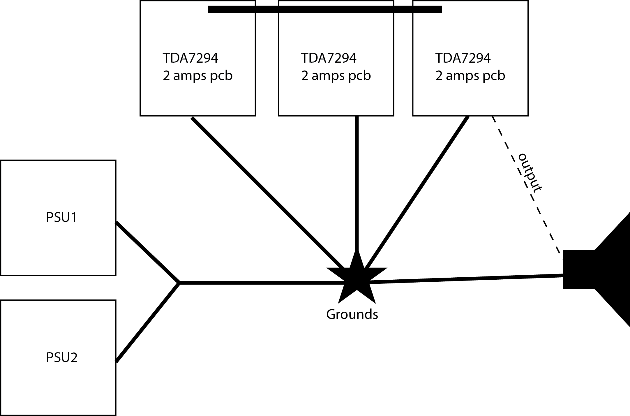

tried one star too. no difference.
single amp = less noise (audible 4-5 inch from speaker).
trying again though to further confirm.
just to add, the amps are dead silent when I disconnect input cables. Problems start when inputs are connected, as more channels are connected, more noise appears

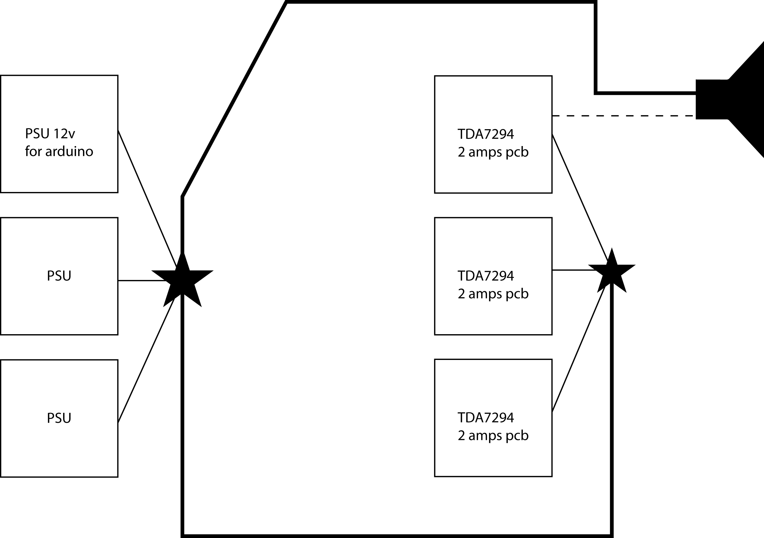

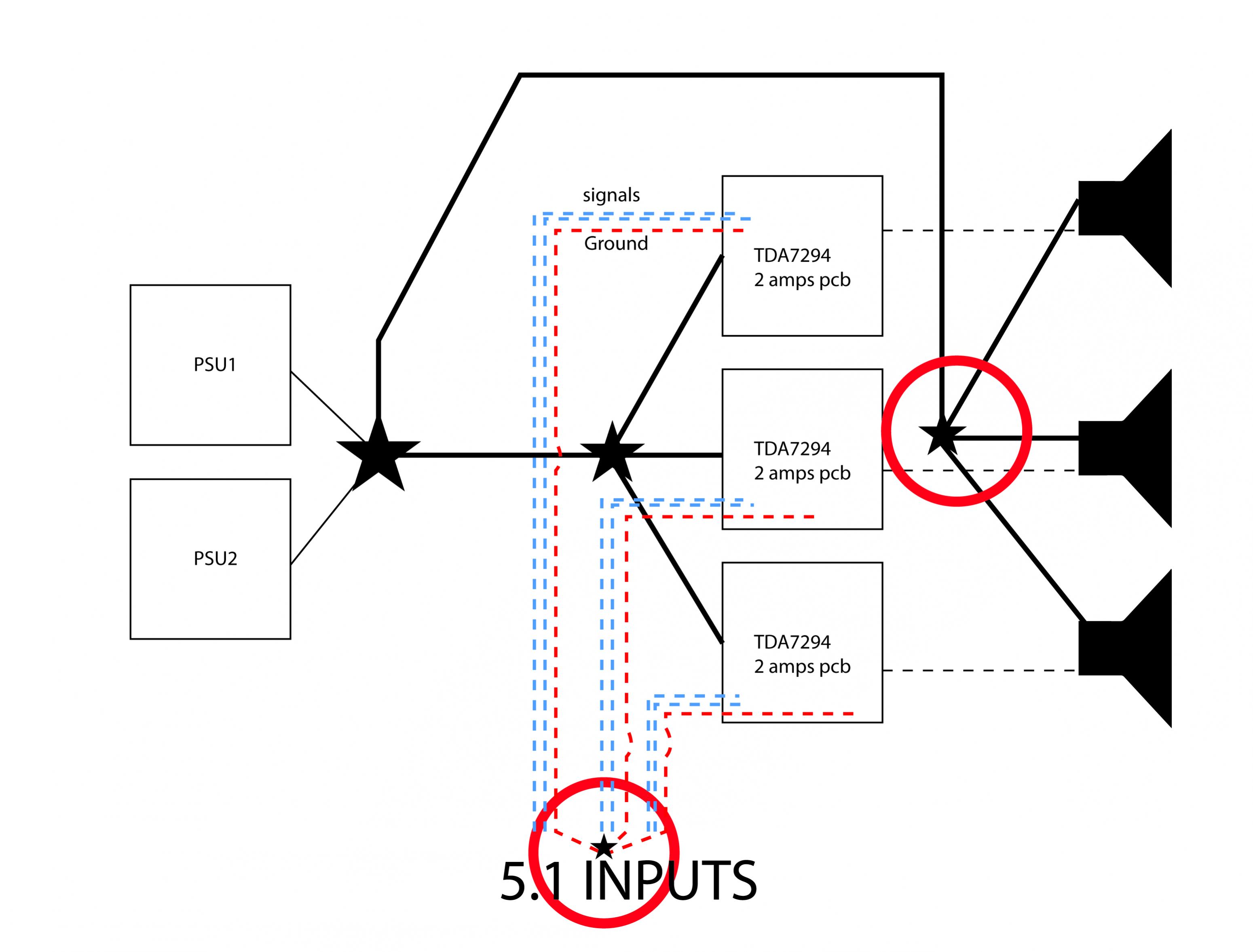

Thanks you for responses, I have tried, as suggested, here are the results:
Amplifier board 1 / PSU 1 : Almost no sound only hearable from 2 inch from speaker, dc voltage on output = 5mv
Amplifier board 2 / PSU 1 : much more noise than single amp
Amplifier board 2 / PSU 2 : same as above
I am not sure about the red circles, kindly advise.
the speaker return must not go back to the PSU charging node. Doing this will bring in avoidable hum and buzz.

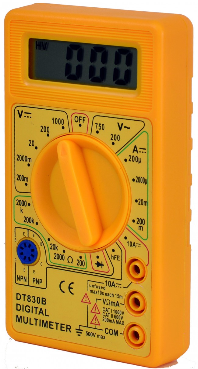

What is the Hum+Noise measurement using the 199.9mVac scale of your DMM?
Do post6 tests a, b, or c, measure 0.1mVac, or 0.0mVac?
Each input to the 2channel amplifier should be two pairs of signal flow and signal return.
Adopting commoned Signal Returns will complicate your arrangement.
That's why I need to see your measurements for a single channel, then for two channels, so that we can identify the source of the hum due to an error in the wiring.

Can you show a photo or schematic of the boards? Speaker return should go back to the amplifier. Your DMM is of no use for measuring low ac voltage I'm afraid

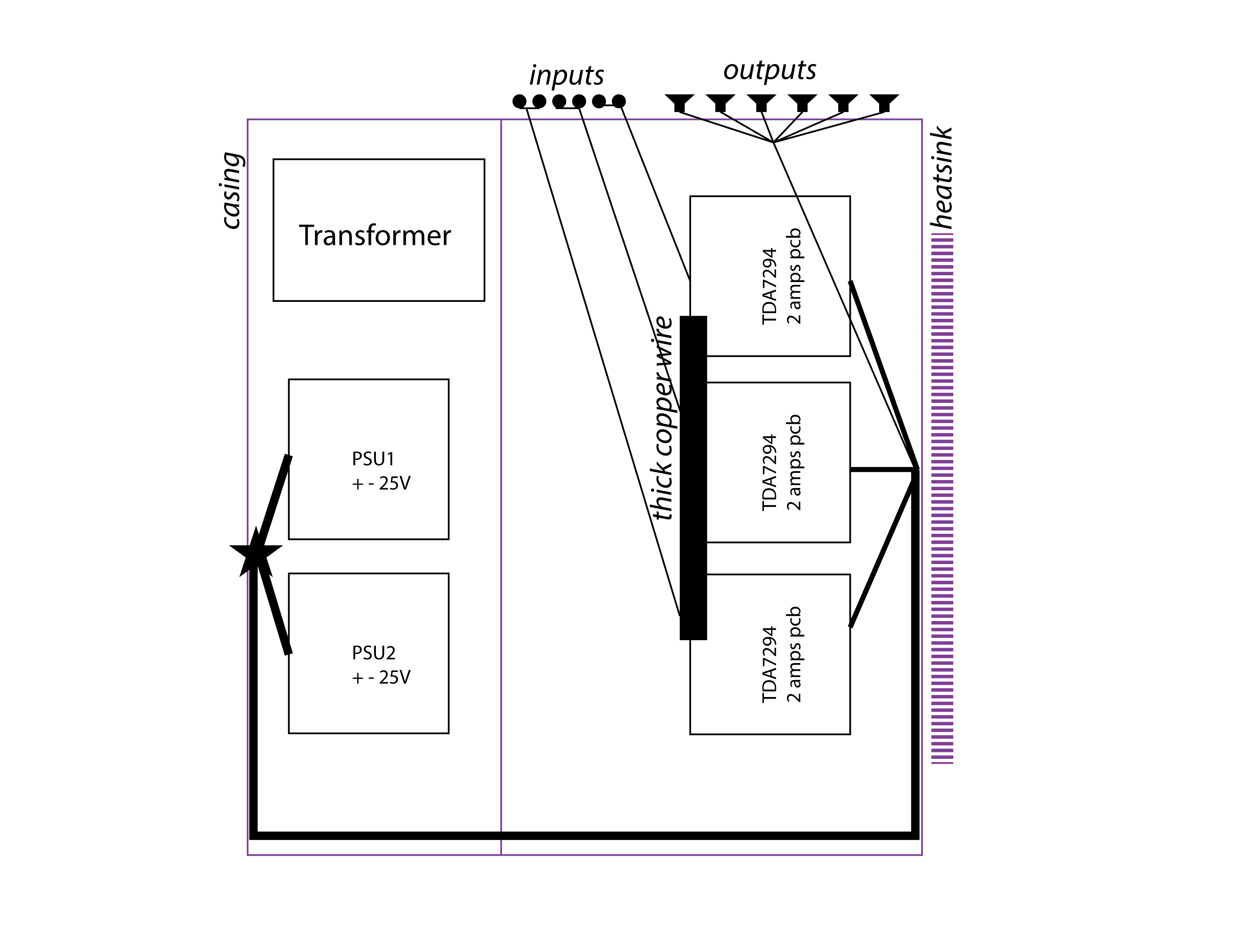

SOLUTION:
joined all three pcb grounds with thick copper wire.
RESULTS:
This reduces the hum quite a bit, to a level that OTHA (other half High authority) approves of it.
1. With RCA connected to amplifier BUT 3.5mm jack not connected to anything - Very very less sound almost audible 2 inch near speakers
2. With RCA connected to anything (even a turned off portable mp3 ) hum becomes bit audible. but since with AC, ceiling fan and other noise around it seems to merge with surroundings 😛
I think I will finish the project as it is for now 😛
