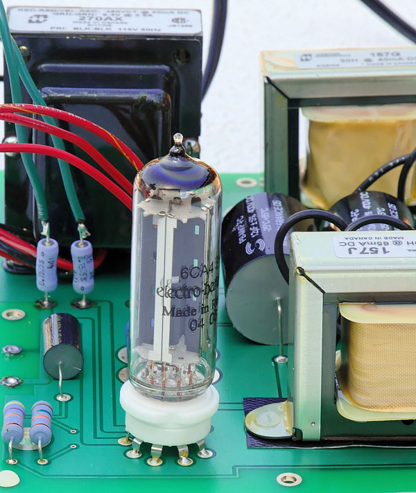

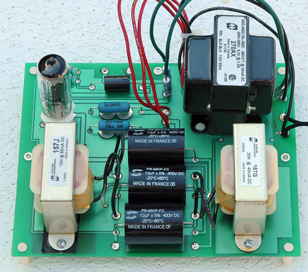

I built an Aikido for a preamp, and used an 6CA4. My most recent EL84 push-pull is the first time I've used solid-state diodes. What a mess!
Pictures attached of the power supply to my Aikido preamp.
I'll install the snubbers tonight, and report on findings.
