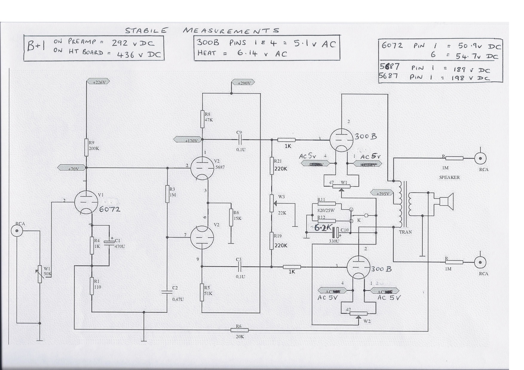

Short the 300B grid to ground. If hum presists, post the schematic that shows your filament supply arrangement for the output tubes.
2.3mV of hum at the speaker from 300B is very normal. Is the 300B with DC filament supply? If it is with DC supply, the hum probably come from the B+ ripple. You can insert an RC B+ filter before the CLC filter to clean up the ripple at the B+.

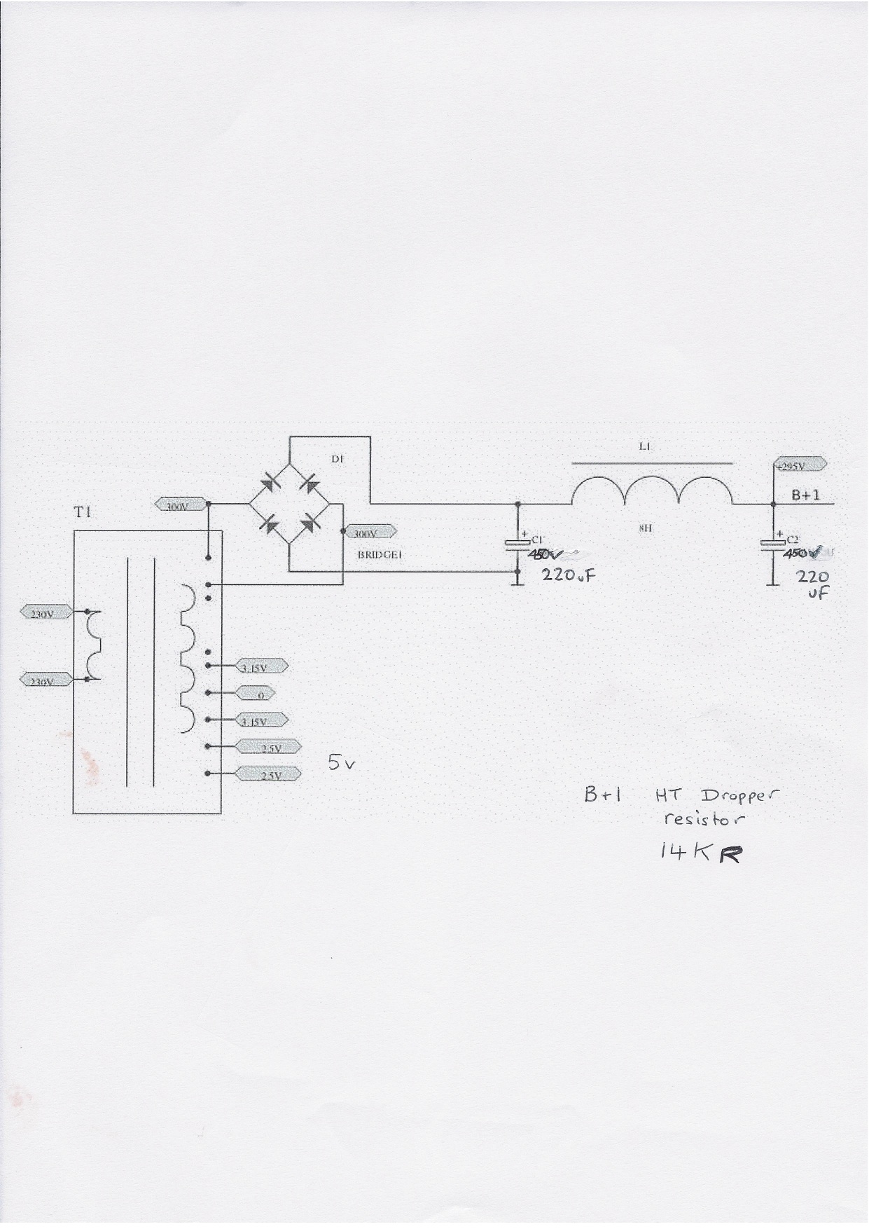

Thanks for all your suggestions. I have attached schematics.
@ levelfive: it sounds more like a constant 100hz hum with an intermittent higher pitch crackling buzz. Have a 47R hum balance pot for each power tube and 22K signal balance pot between each pair.

As triode_al has suggested, phasing could be a problem (if you have one filament wired the wrong way, the noise will double instead of canceling itself - just reverse leads on one filament conenction to try it out).
If filaments are wired up correctly so that PP action cancels any common mode hum the only thing left is the adjustment of "hum potentiometers" (the ones between filament supply connections). These need to be balanced so that any noise filament cancels itself out between both tubes. I'm confident you should be able to eliminate all the hum this way.
If you don't feel like tweaking the potentiometers there's always the option of going with DC filament supply. This has been discussed in details here before, there seems to be consensus that 300B sounds best with CCS filament supply (avoiding power-up shocks aside I can't imagine why, I don't subscribe to this theory but I'd use CCS for a different reason).

Ok, this is NOT filament hum - filament hum is always in the 50Hz(60Hz) range.
Another question: Is your level volume pot (W1 50K) grounded?
At what point exactly?
You should always solder a wire from the grounded pot connections back to the common local ground of the stage the pot is used in.
The pot cases will be grounded via the mounting nut!
The volume controller is a DACT CT2 grounded back to star earth point with a single unshielded wire running around (but not touching) the chassis. Have tried rerouting but found no improvement, it slightly increased the hum.

What are the grounding arrangements around the rectifier and first (reservoir) capacitor? Are you injecting charging spikes into a signal ground, or inducing them magnetically?
If you built it exactly as shown in the PSU diagram (with the rectifier -ve wire going to the capacitor, then a connection from there to ground) then it should be OK. If, on the other hand, the rectifier wire goes to the star ground then you will be injecting noise here.
