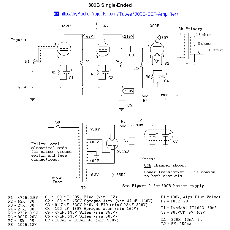

Hi everyone. I've just powered on my amp project for the first time, and have a devastating hum problem. The design is the JC Morrison 300B from diyaudioprojects, which it appears at least a few people in this community have built successfully. The schematic is here https://diyaudioprojects.com/Tubes/300B-SET-Amplifier/

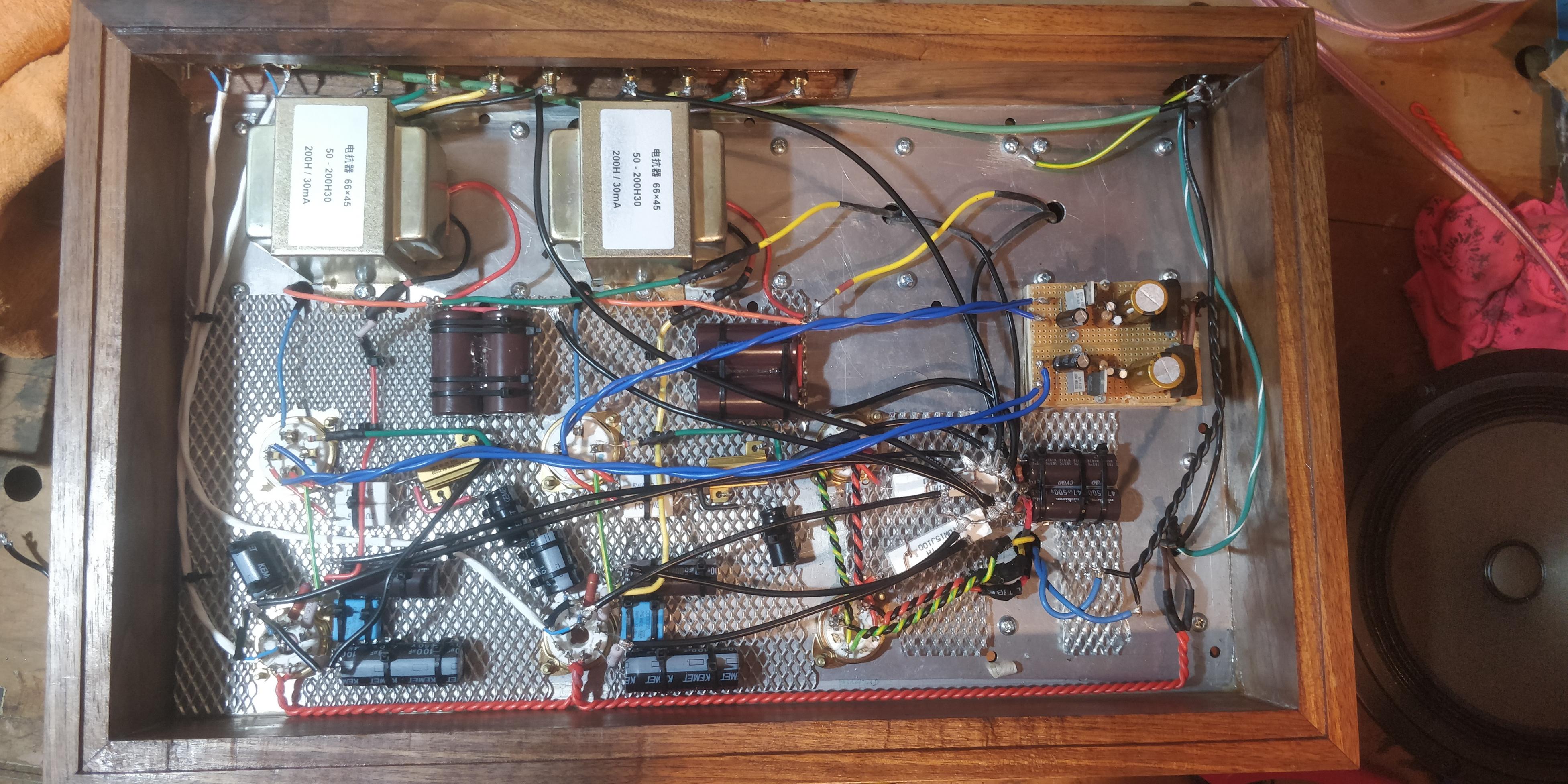

As soon as I power up the amp, both channels start to hum at 50 Hz. The hum is very loud, and doesn't change if the input is attached or shorted. I initially had everything star grounded, but have changed the grounding scheme in one channel with absolutely no change in the hum. I've attached a picture of the current layout. Any input about what to try next would be greatly appreciated.

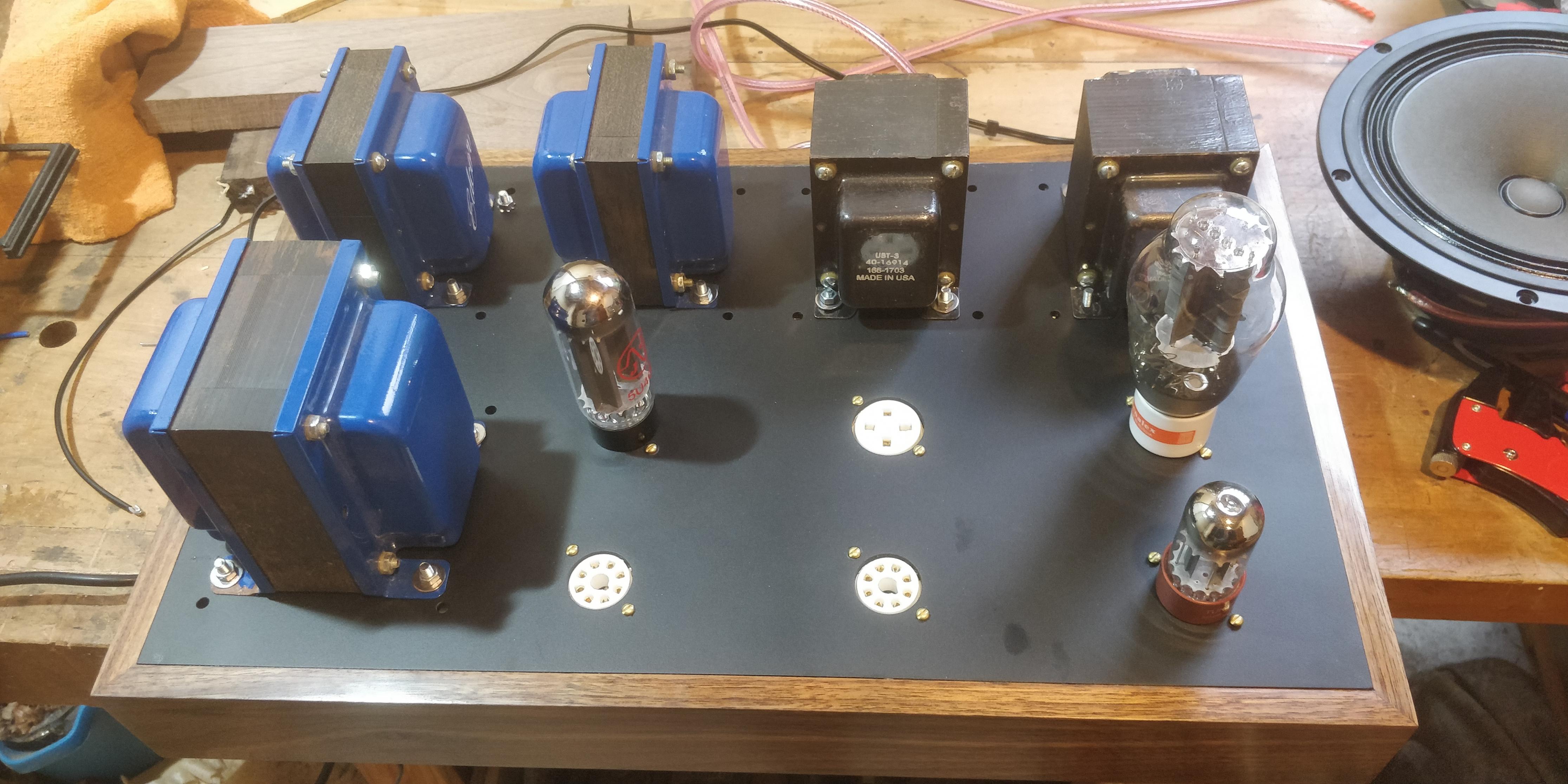

What are the two transformers/chokes shown in the picture? What's behind them - the loudspeaker connections? Wondering about radiation fields.

Can you post a picture of the top side as well? Are the two anode chokes for the driver? The JC Morrison 300B in this thread does not have any chokes:

Can you post your schematic?
It appears as if you have a ground buss in the middle right of the photo. You also have chassis ground, as it should be, right where the IEC connector enters the chassis; however, there is no connection between chassis ground and the buss that I can see.
Sorry about the dud schematic link. This one should work DIY 300B Single-Ended-Triode (SET) Hi-Fi Amplifier Project.
Andyjeavans, the two chokes visible are the 200H chokes to the 6SN7s. They should have very little AC through them.

Palustris, you're right, I don't have my safety earth and circuit ground connected. Is that important?
Alasikata, instead of the hum pot, I have a pair of matched resistors of half the value to form the equivalent voltage divider.

Is power tubes DC heated?
If I saw correctly it has two independent LDO 5V stabilisers, raw supply (graetz with -small- smoothing capacitor), but common AC secondary?

Make sure you check the voltage close to 69v, 215v, and 430v.
If you say 50+50 ohm each leg, probably may not work. I have seen someone use 33 ohm each leg and R6= 1k ohm

No, it probably won't work. You need a pot to balance the hum out across the filament, but it may not be exactly 50% on each half.
Its the chokes next to the speaker jacks. See if this affects it. Unbolt them and move them away .

The problem might be those 200H chokes in the chassis that do not appear in the original design as well.
Bad place probably. Try to remove those chokes and only use a resistor.
Also, the filament voltage regulation circuits are right under the power transformer. That might be another issue.

The chokes are mounted at the opposite end of the chassis with leads running down to the 6SN7s - definitely would move them.
Also, since there're only two chokes which resistor are they replacing R2 on first stage or R4 on the second stage?
6SN7 heater supply is floating ?

Hi Everyone. Thanks for your feedback and ideas. I've gone and tried each of these things to no avail (tying safety earth to circuit ground, replacing the paired resistors on the 300b with a hum pot, taking the 200H choke out of the circuit, moving the DC supplies away from the PT, and adding a virtual centre tap to ground on the 6SN7 heater supply).
