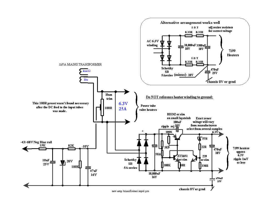

I went through this (annoying) spell quite recently with 7199's, the NOS RCA types with spiral wound heaters were brilliant... guaranted low hum level as expected.....then I replaced them with Sovteks and up it came. Desperate not to butcher the chassis I played with the 6.3V AC and got nowhere until I decided to lift the whole heater supply off deck and bias it with -10V; cap it with 100uF or so.......and the hum went. One of those weird things. However, I can't say this is the receipe for all low level tubes....but it worked on these with min component count..

Hi there.........I frigged about with plus/minus polarity on the heater off ground for some time, and I found that I had to go much higher with the +off ground to get the same result compared with -10V. A space charge mystery..........not all tubes behave the same. The best results I get with nothing at all is with NOS tubes. These had the heater properties reseached into thus I get none of these problems.
At -10V (wrt heater to cath) the effect on tube life is nil..the data sheet of the NOS Syvania 7199 states -200V permitted !That was probably with a spiral wound heater. One can only presume that recent makes Sovtek/Svets would be lower. Unfortunately much data isn't published anymore.
From having the heater biassed up and lower didn't make a hoot of difference to distortion nor to any DC shift. As the heater on some tubes is physically screened from g1, any ion shift would see a low Z cathode, the cathode current would swamp any effect. That's probably why NOS are better thought off.

Cracked it, all is now quiet at normal listening levels on my main system. At high setting of the volume pot I have a strange motorboating noise, but I will never be using it at those levels so thats OK. Maybe its the source, as that the satelite, which goes through the video and has the DVD on a scart socket box (a hum waiting to happen).
Thanks all
