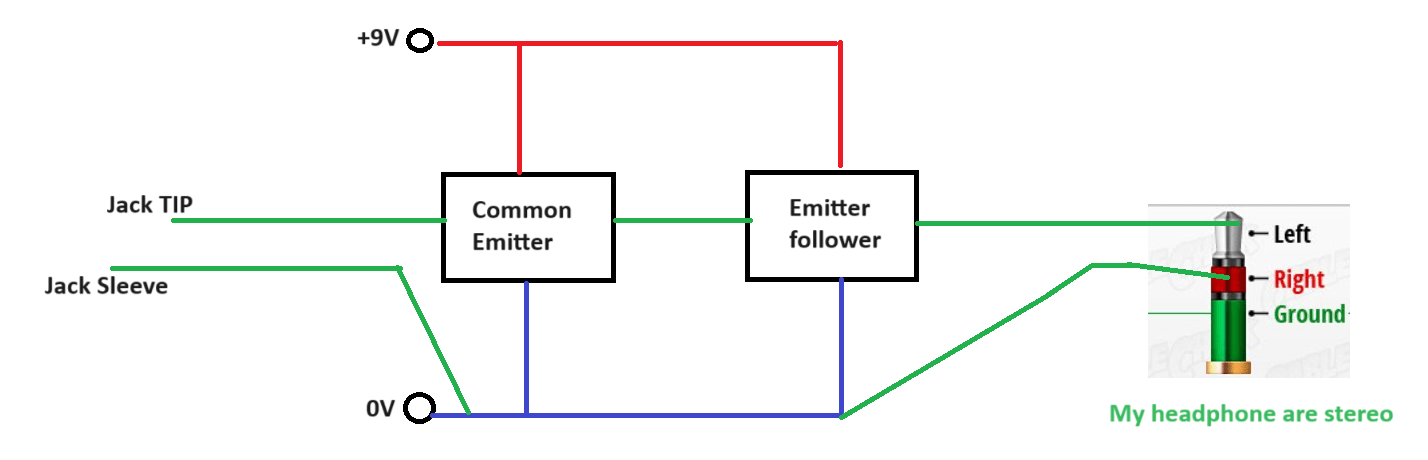

  • I tried to build the second stage of my project using an emitter-follower amp...and it actually works! I can hear sound from my guitar using headphone. I powered-on the circuit (CE-CC cascade) with a 9V battery. The hum remains, and again if I move around the hum level change.
I think that I cannot do anything with a single coil 🙁
Howerer, I have two other questions if I do not bore you...

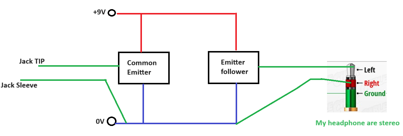

1. If I use a battery, I do not have a ground, right? I mean, the 0V battery is my reference, but I don't have any proper ground. Is it correct?
2. My test configuration was the following. I hear from both sides of the headphone. However, I did not plug the ground. Are there some corrections to do?
ps: it was quite surprising for me that just 1mW rms signal on my headphone is sufficent to hear a lot!

Answers

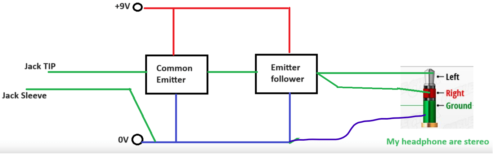

1. correct your circuit has no reference to earth ground untill you plug into something that would provide it on the 0V line .
2. you would normally connect the 0V leg to the Sleeve/ground and feed the output to both the Tip/left and Ring/right .
Thak you very much for the replay.
So for point (2), if I understood correctly, I should do that...

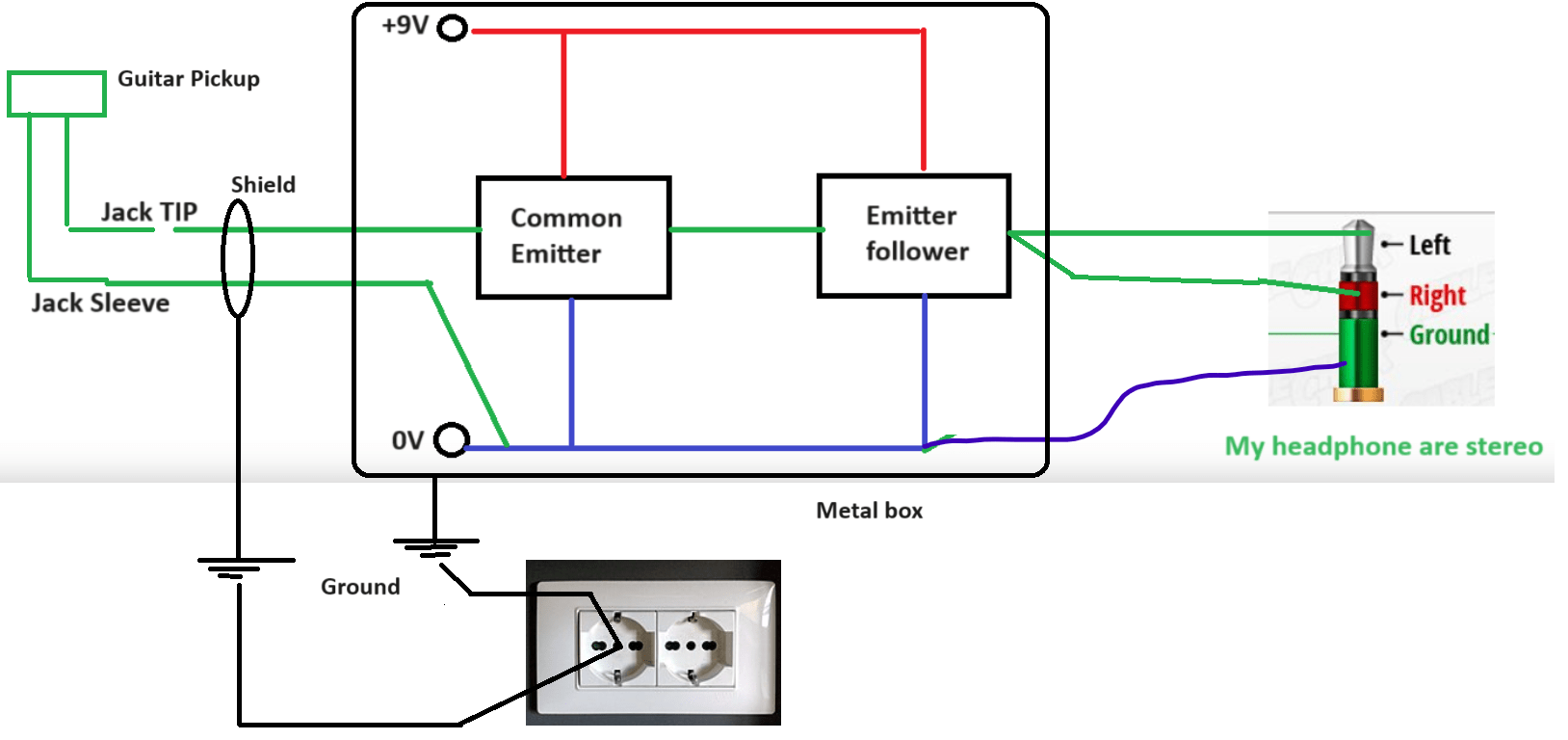

For Balance/Unbalance: again, if I understood correctly, balance cables have a shield. However, a shield must be connected to a proper ground for working corretly. Does the following scheme make sense? The proper "ground" is the ground of my house connections I think (I am a little bit scared to do that ahah).
A note: I tried to input my mobile phone instead of guitar pick-up. No hum/buzz is present powering the circuit with a battery. I don't have humbacker pickups to confirm that noise is coming from the pickups 🙁
You speak about "grounding loop" problems...what do you mean?
Andrea
An ordinary twisted pair of wires is balanced , each wire has the same resistance , capacitance and inductance . A balanced connection has to maintain that balance by terminating the each wire with the same impedance both at the transmitting and receiving ends . Having a grounded screen not necessarily an earthed screen round the pair helps to reduce interference . Balanced microphone cable has a twisted pair with an outer screen . Standard coaxial cable has a single inner wire with an outer screen and thus by design is unbalanced .
I would not advise making the house ground connection .

A cable shield/screen should be attached to a metal chassis at its connector. While a shield will probably have continuity to 'ground', the shield is not part of the 'ground' system or systems.
Note that the Safety Ground/Protective Earth is one 'ground' system and the ground rod/Planet Earth is another 'ground' system.
Note that the connection to Planet Earth is there for safety during unusual high voltage events. It has little to do with day-to-day AC power quality or audio system quality.
