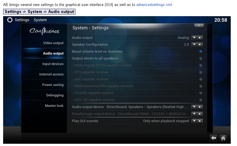

XBMC
AudioEngine AudioEngine - XBMC
Audio Output Audio output - XBMC

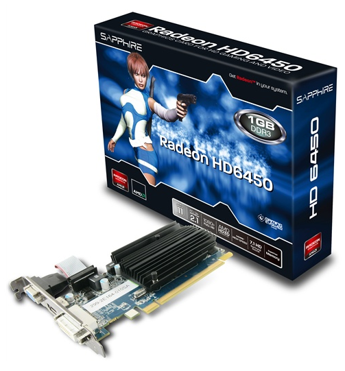

Product http://www.amd.com/uk/products/desk...6450/Pages/amd-radeon-hd-6450-overview.aspx#1
SAPPHIRE HD 6450 1GB DDR3
Product SAPPHIRE HD 6450 1GB DDR3

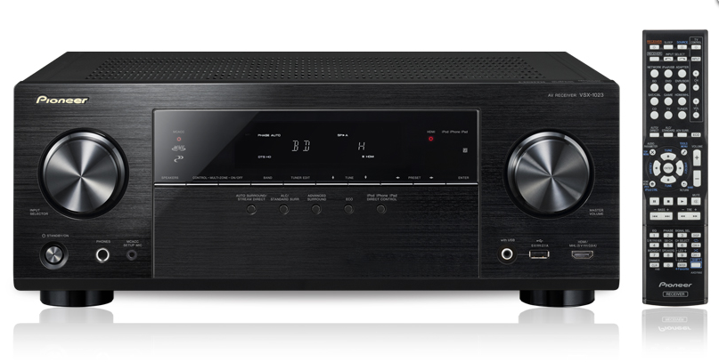

PIONEER VSX-1023-K
Product VSX-1023-K - <b>7.1 Channel Multi-Zone Networked AV Receiver</b><br> Featuring 3D and 4K Ultra HD Pass-through | Pioneer Electronics USA

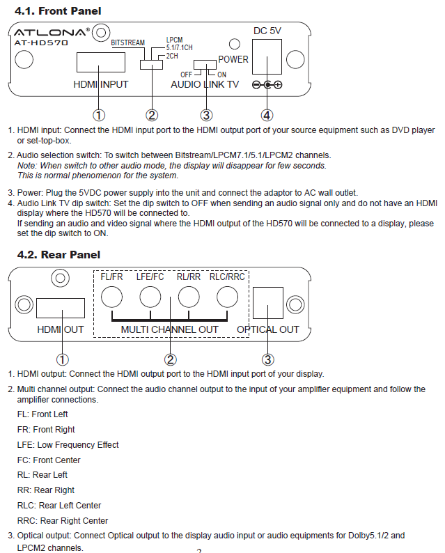

ATLONA AT-HD570
Product Atlona Technologies connectivity solutions, cables, splitters, extenders, distribution amplifiers, converters, switchers for commercial, professional and industrial applications
User Manual http://www.atlona.com/pdf/manuals/AT-HD570_manual_v2.pdf
Data Sheet http://www.atlona.com/pdf/data_sheet/AT-HD570-ds.pdf

AMD - RADEONHDA Verbs http://www.x.org/docs/AMD/AMD_HDA_verbs.pdf
PIONEER VSX-1023-K

ATLONA AT-HD570

Hi mhelin, thanks for your suggestion. Basically, the aim of this present diyAudio post is to tell people that :It would be interesting to know how to embedded linear PCM audio to HDMI signal and how it could be implemented using FPGA for an example. Is it required to be encrypted or could the audio data be plain unencrypted PCM?
1) HDMI Multichannel LPCM is now working (or not?)
2) XBMC and JRiver have built-in signal routing and DSP capabilities (to what extend?)
3) XBMC and JRiver can host DSP plugins (like VST) for extending the DSP capabilities at will (does it mean a stereo 3-way crossover with best IIR BiQuad filter use, and best FIR filter use?)
Just in case, please note that Flowstone is a graphical DSP compiler easy to use, able to generate a VST. Have you experimented, specifying a VST compiled by Flowstone, as plugin for XBMC or JRiver?
All the above components are available, affordable, and already tested by three experimenters (mojave, randytsuch, Pano).

You are talking about some homemade FPGA, or some HDMI conversion chip made by Analog Devices.
1) Do you fear the Stereo Audio being split in 8 channels by the VST within XBMC or JRiver, to be not-HDCP compliant, to become muted by the HDMI receiver of devices like PIONEER VSX-1023-K, AMBERY AU-HDMICP, ATLONA AT-HD570? Have you tried this?
2) Don't you like the DACs used inside the PIONEER VSX-1023-K, AMBERY AU-HDMICP, ATLONA AT-HD570? Do you want to hook your own DACs? That's already feasible if you dare opening those devices, unsoldering the existing DACS and intercepting the I2S lines. Possibly you'll need to generate a MCLK if the DACs are I2S masters.
