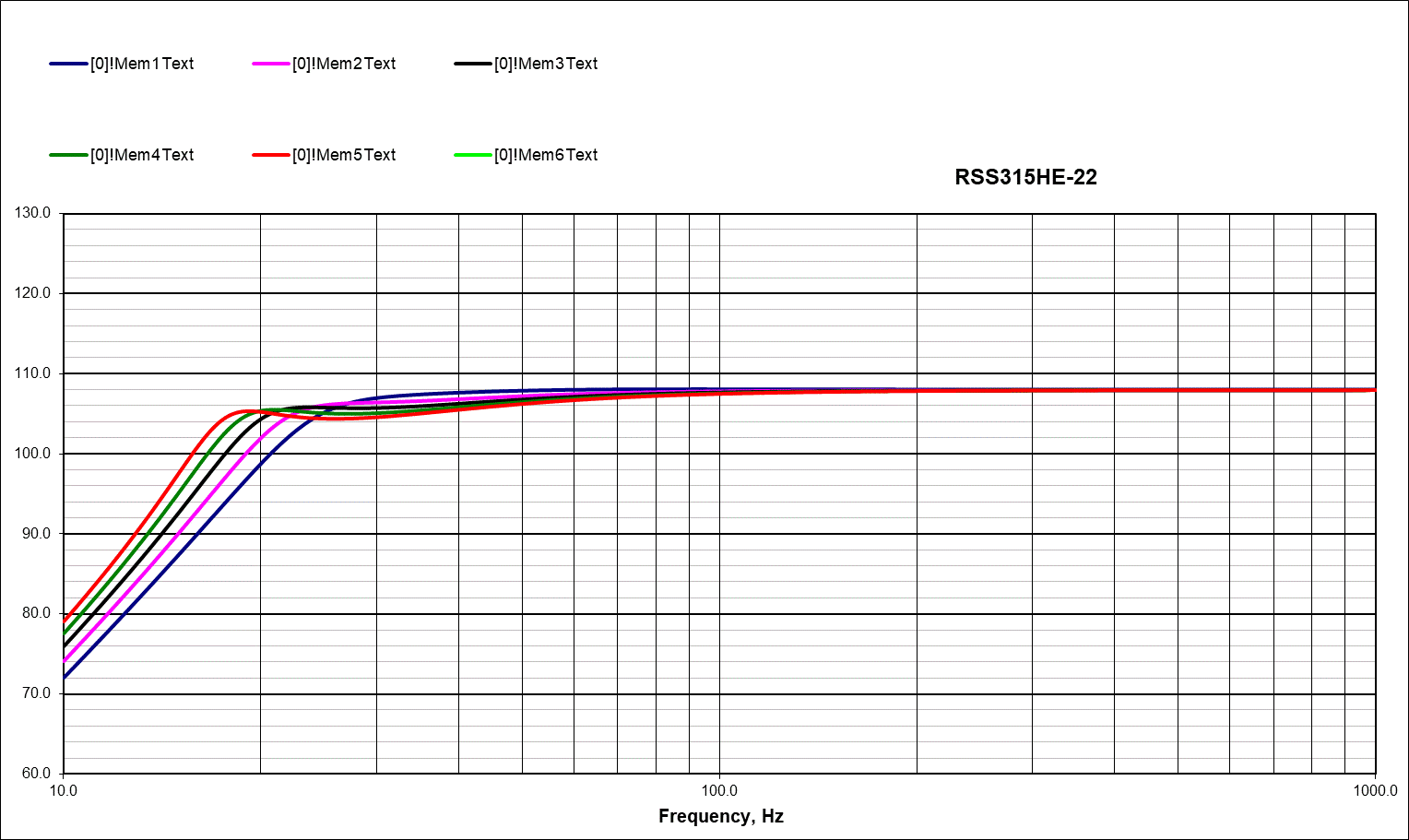

Here is response achieved while varying volume from 45L / 1.6 ft3 (dark blue) to 85L / 3ft3 (red) in 10L increments while maintaining the same port dimensions as you currently have. You could reduce volume by adding bricks or whatever and find out which you prefer, then rebuild if you want with the smaller volume.

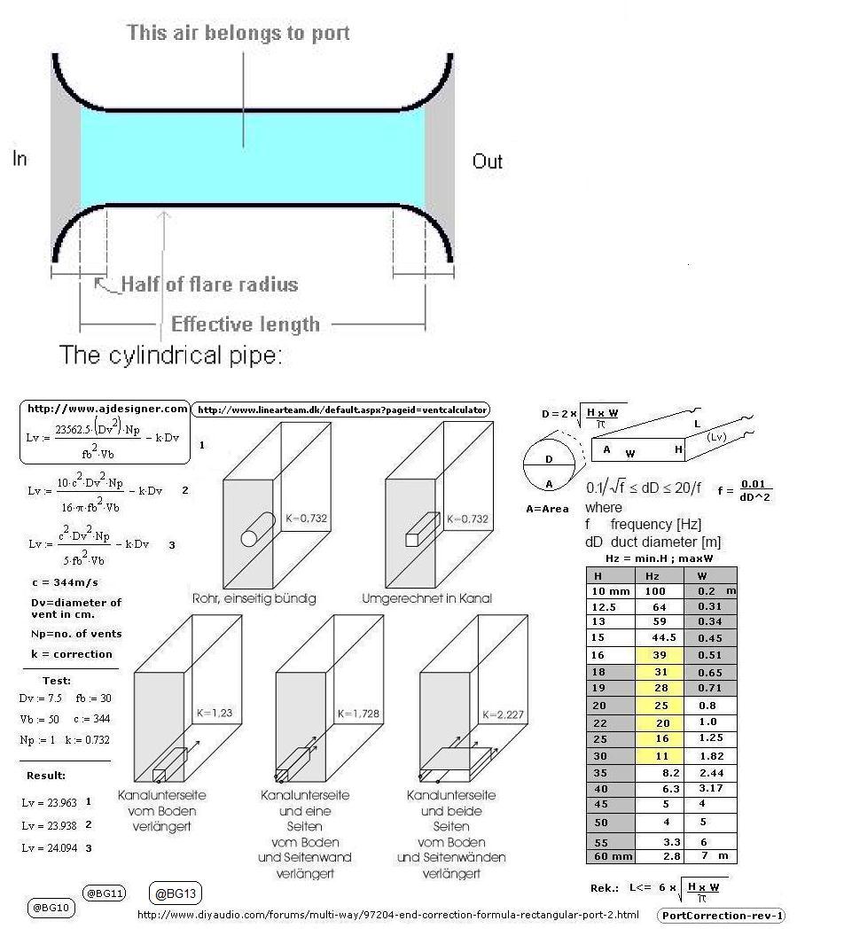

I'll add to the myth / lore and re-post this useful diagram 😉Complete side note, but since they were mentioned: correction factors for various port types are forum myths / lore. They float around, but there has never been a single empirical verification that show they work. It's really not wise to spread unproven claims as facts.
This pretty graphic has been circling around for years or maybe decades. People repost it probably / obviously because it's pretty and has formulas in it that look convincing to the layman, like worryingly often happens.
Claims / theories have to be proven with empirical data, meaning via experiments / study. As long as no proof is provided, it's just that - a claim / theory. Once that unproven claim / theory has become repeated often enough, it should be called myth / lore.
In case that's being mistaken as well: the burden of proof always lies on the person who made the claim.

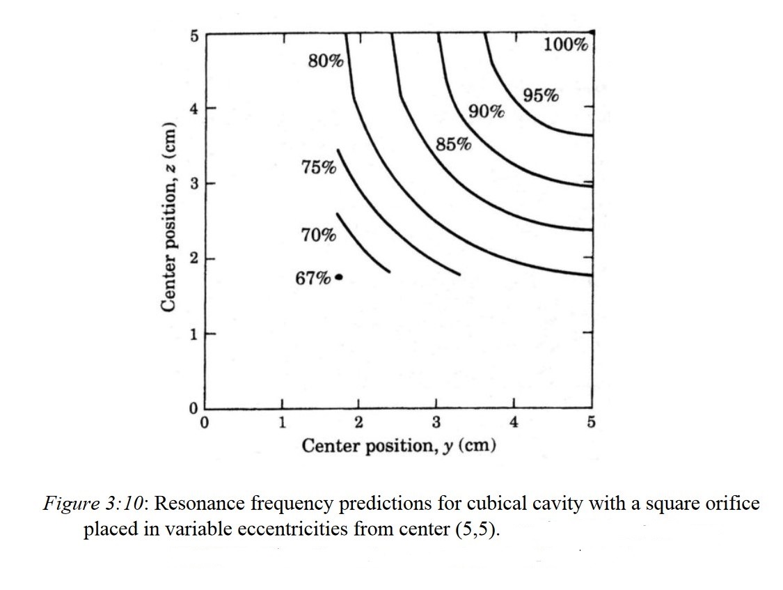

There is some published research on this effect. Trawling through the internet it's hard to find a succinct reference, but below is a graph showing the effect on tuning frequency of locating a square orifice at different locations on the face of a cubical cavity (10cm side length). As the orifice moves from the center towards the corner, the tuning frequency drops by more than 30%. This is an extreme example as the end correction has a much bigger impact on a short port (i.e. an orifice), but the effect is obviously real. I'd love to know where the german worded diagram in the graphic I posted came from, but no one seems to know.
The graph below is from a thesis referencing "Effects of geometry on the resonance frequency of Helmholtz resonators" by R C Chanaud. I can't find a free copy of the original paper.
Lets imagine our normal shortest port which is as short as the baffle thickness. Now, I can't imagine how flaring this is going to drastically change the sound.
