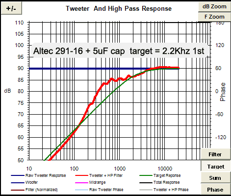

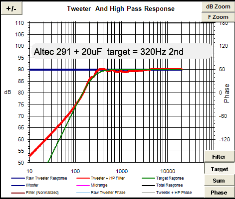

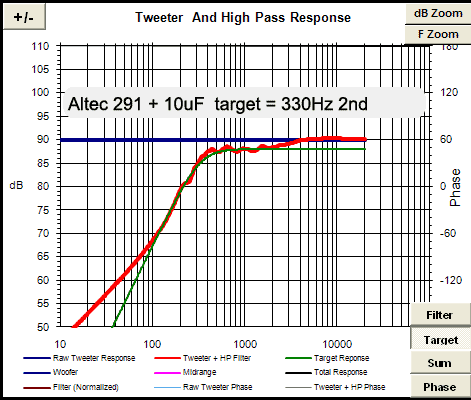

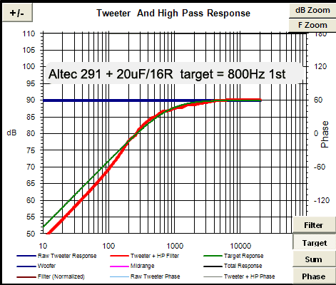

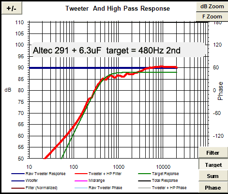

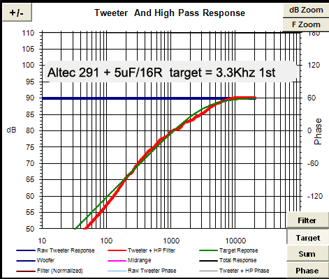

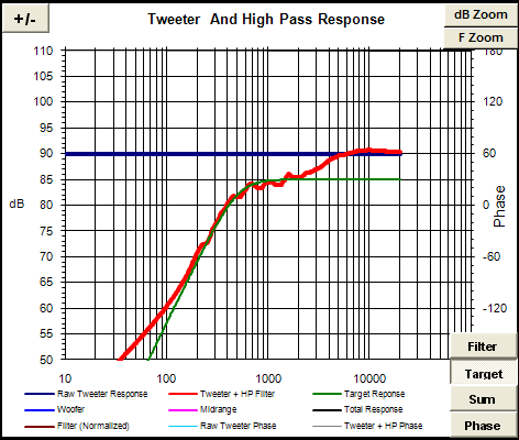

I was interested in what a single cap might do and also cap+resistor, so I ran a few graphs based on the impedance curve of an Altec 291-16K on a 300Hz horn.
You'll see various values and the nearest target slope. Remember, this is electrical, not acoustical. Some values make a nice shelf.

Anyhow. Thought I'd give the solo 4uF cap a whirl - been listening to it for a couple of hours. Have to say it sounds rather nice. 500Hz LR low pass on the woofer. Since I use so little power, no fear of hurting the fram.

Well as far as I can tell, the 4uF cap is within 1 dB of a normal 2nd order 500Hz filter at the -24dB point. Simulates, measures and sounds the same here.
But putting i a shunt resistor in changes.
